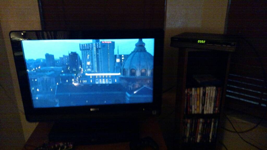

Found the remotes...SUCCESS! I got ABC News One at 99%. The new HD feeds on there stutter terribly (not sure why, got 99% signal) ...but the SD ones work fine. :)
