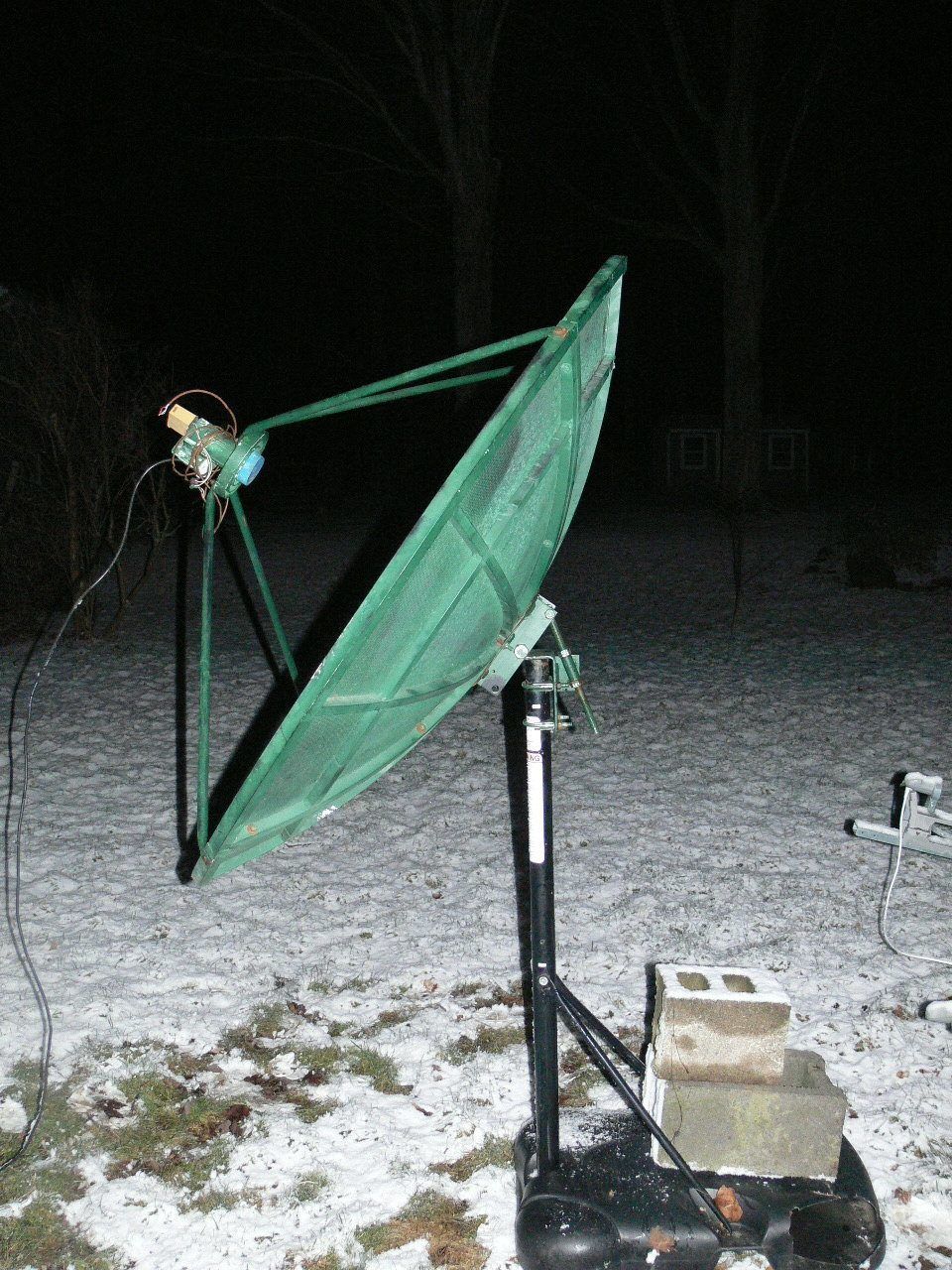

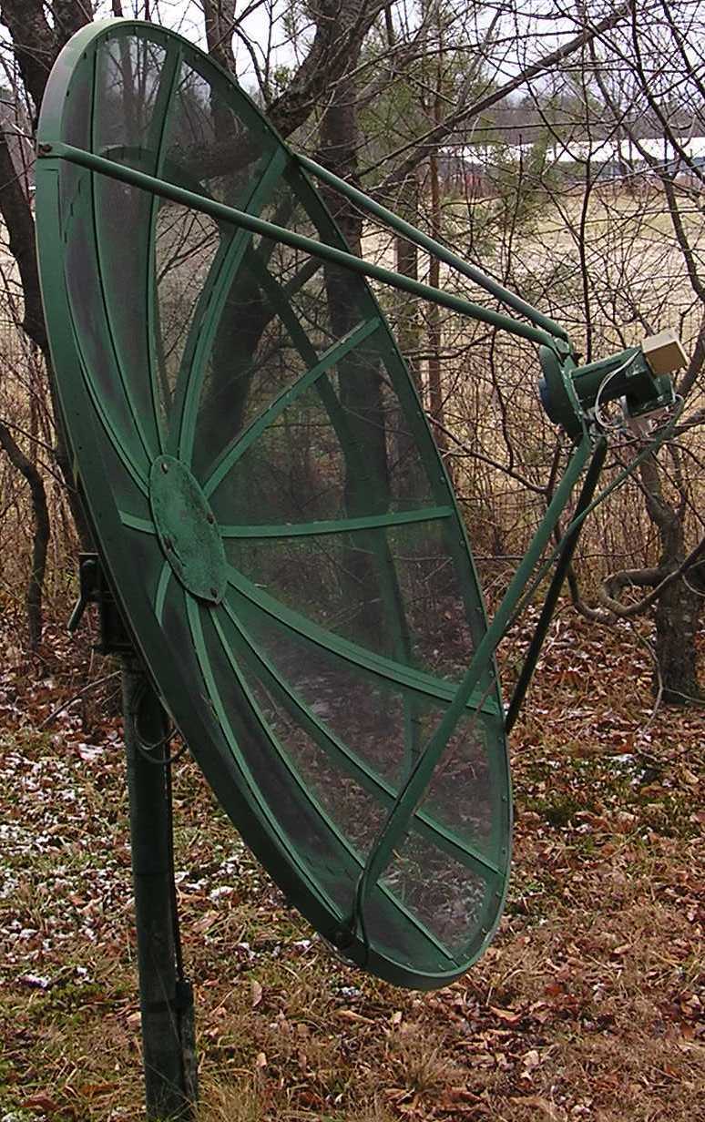

Back in the mid 90's I had a 6' mesh and some others I played around with.
I picked up a 5' like 5 or 6 years ago. Need to find the photos.
I tossed it up tonight and now have some stuff off 99W

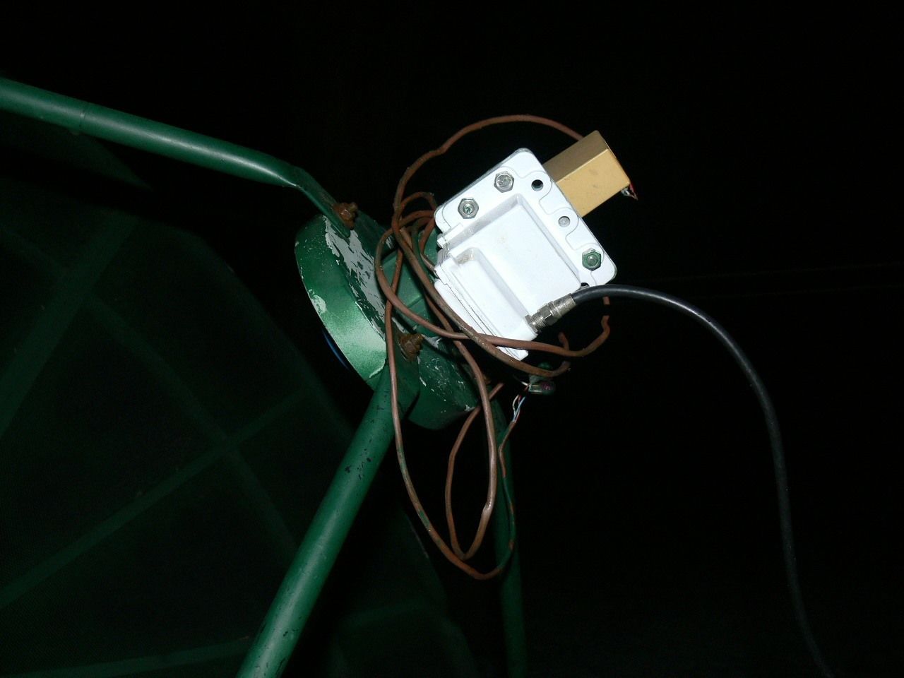

As you can see from the photos I have a rotor on this BUT no way to drive it.
How do I get rid of the rotor or do I need a new feed horn or parts of one?
The dish at night is what I did tonight, the one in the day is from when I picked it up.
Thanks

Being an Az-El mount, the servo feed horn is probably the most convenient. A servo driver, that you'd have to calibrate, would do the job of changing the skew?polarity. Google search: servo driver
Just a warning: Today, with 2° satellite spacing, you may have trouble getting some TP's because of adjacent satellite interference. So be on the lookout, you'll probably want a bigger one shortly. Some can still be found "in the wild" for little or nothing. In the meantime, Have fun, & welcome back to C band.
But if he leaves the old LNB w/the need to have two extra wires on the feedline coax, he'll spend more on the line out to the dish because he will be forced to get a 7 wire settup? Why not just replace the LNB and all he needs is a coax? Unless the fixed elev az settup is to be replaced with a actuator for a polar mount, ... which means he will have to spend $$ for a polar mount... :D. Nevermind, I'm confusing myself...

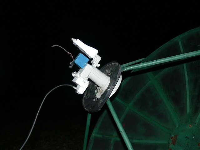

I found this feed horn on a 8 or 10' dish that was sitting next to a building years ago.
It appeared to have pulled down and was not worth saving. :(
The feed horn was as I remember noting when it pulled it both C and Ku so out came the tools. :)

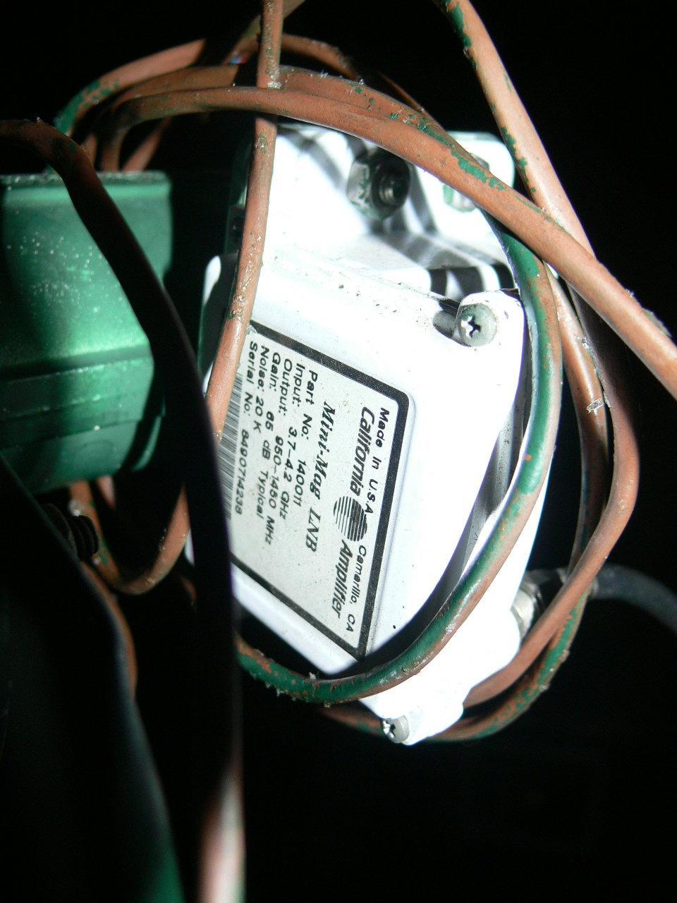

This and the orig feed horn on the 5' are both Chaparral brand with a 25 deg C band California amp LNB along with a 0.9 deg Ku California amp LNB.
Both work BUT I was having problems with the made in USA servo. I put the made in Taiwan servo on it.
After moving the USA one by hand a little bit and running a few times it seems to work now to. It makes a bit more noise than the Taiwan one.
The orig 5' has a 20 deg C band California amp LNB.
