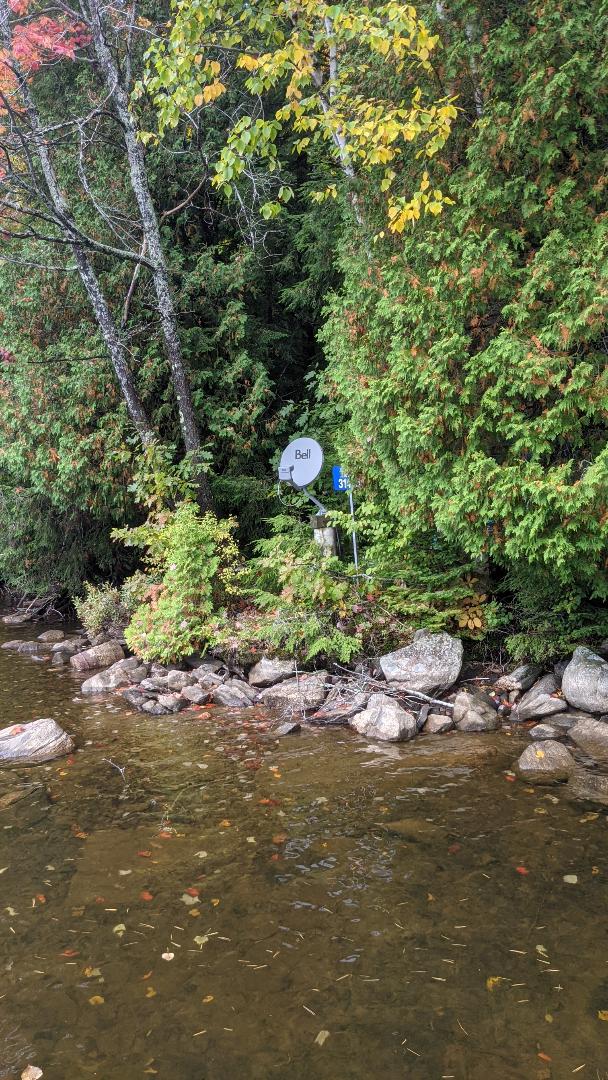

We have a bell expressview setup at our cottage. the dish has been in place for over a decade, its is mounted on a cement base, facing across the lake so I know there is no chance of an obstruction in front of the dish.

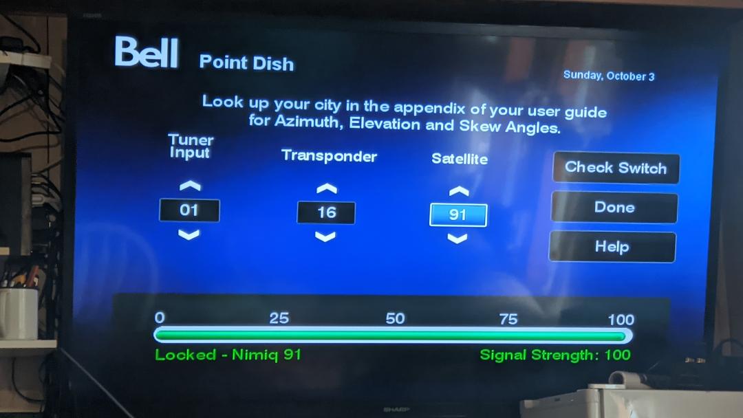

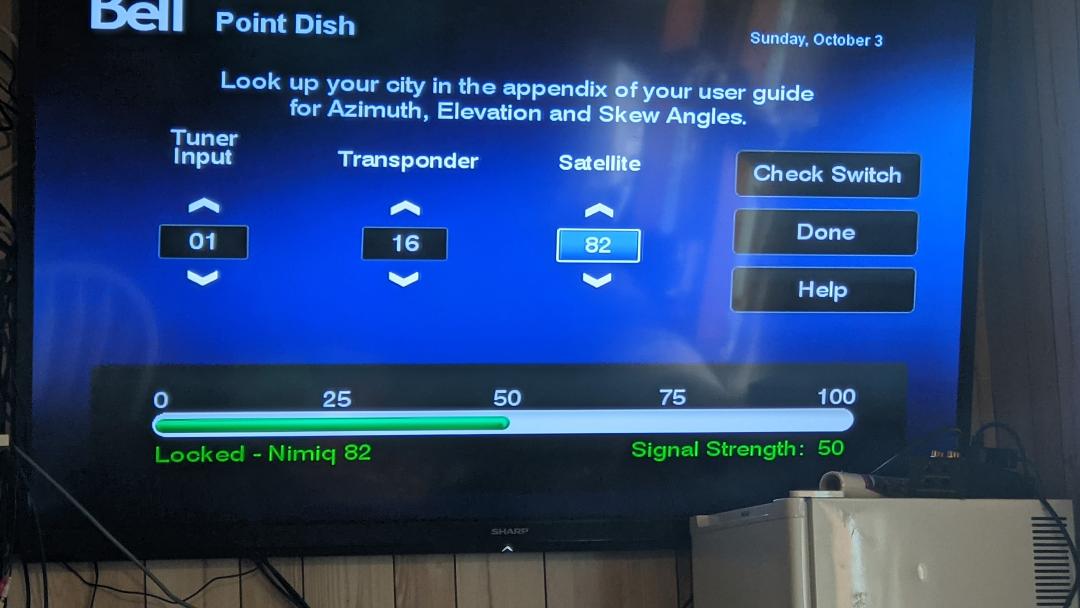

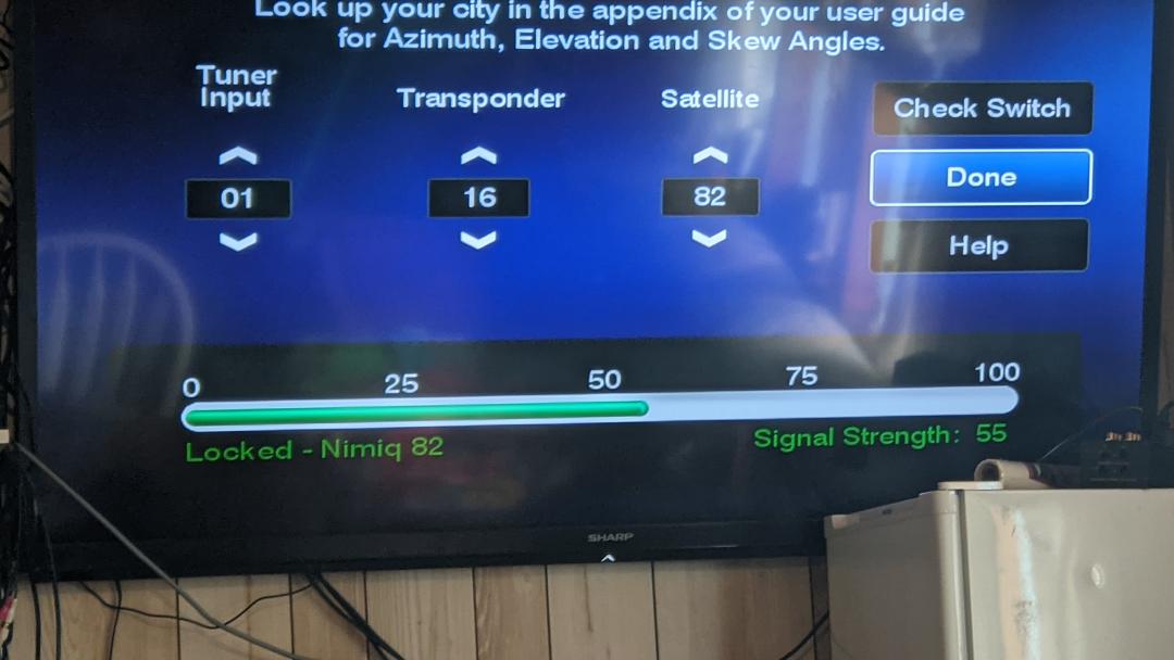

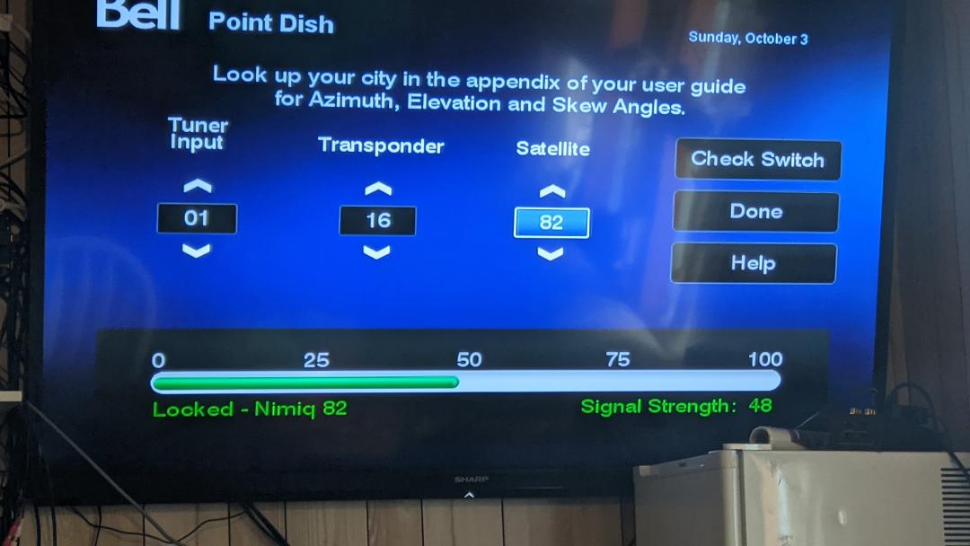

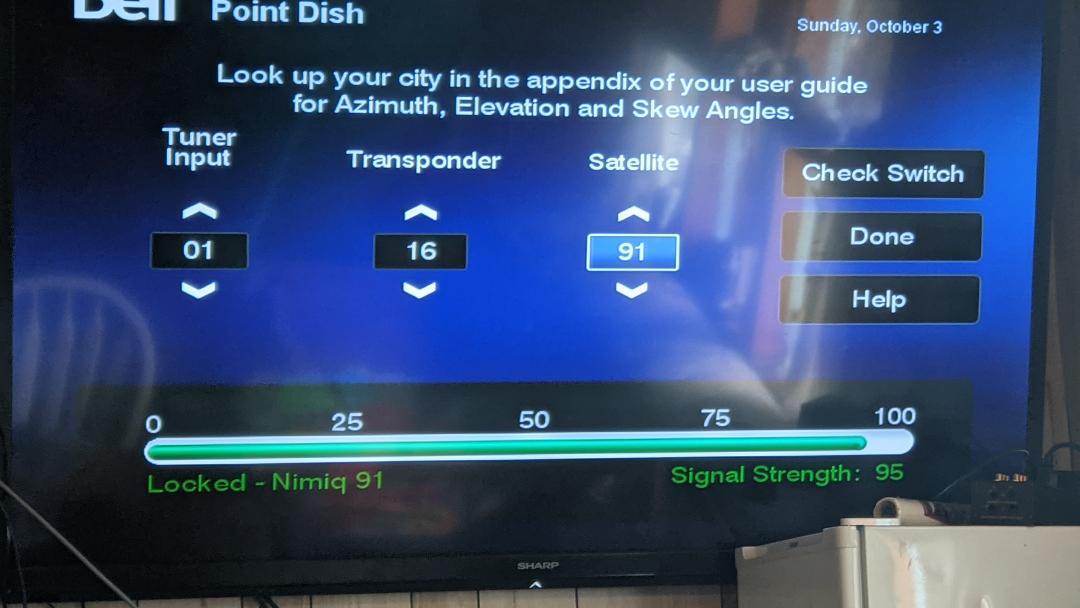

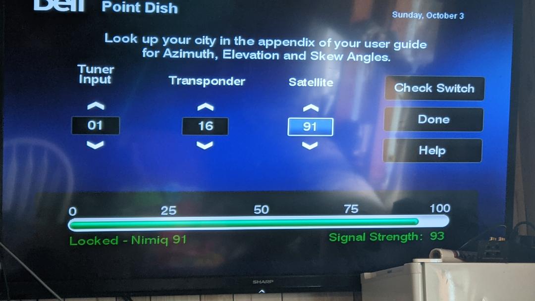

A little success... 100 on 91 before and 48 on 82.. a tiny bit up and I can get it to 55.. and I do mean a tiny bit up.. a tiny down or a tiny right or left and it drops like a rock.. and I was waiting a good 30 seconds inbetween the light movement. Lock in with the slighly up 55 on satellite 91 and it dropped to 91-95.. seems to float a little every few seconds on 91 .. Straight 55 on 82.. As I said, this couldnt be a more solid mount.. is on a poured concrete pier and the 1st think in front of it is across the bay which is at least a mile.. So there is no obstruction. (ill even attach pictures for the fun of it)
With perfect weather 55 will work on hd.. but it takes nothing for that to drop and we loose hd.
Its a brand new line with brand new pro ends on the line.. Heck today I even ran a factory made 100 foot line inbetween the dish and the receiver. Same thing.
We have tried replacing the splitter that takes 1 line from the dish to the receiver.. same thing..
Its a bell 9241 receiver.. I guess next we can haul up an HD receiver from home and try it.. Do I maybe need a bigger dish ?

That leaves bent dish, bad cable or bad tuner.
Well the dish hasn't been hit and looks as it was for several years. The cable was the first thing we changed so I guess we will have to bring a receiver from home up to the cottage and see if that changes
Looks can be deceiving. Sometimes it is the arm that gets bent.
