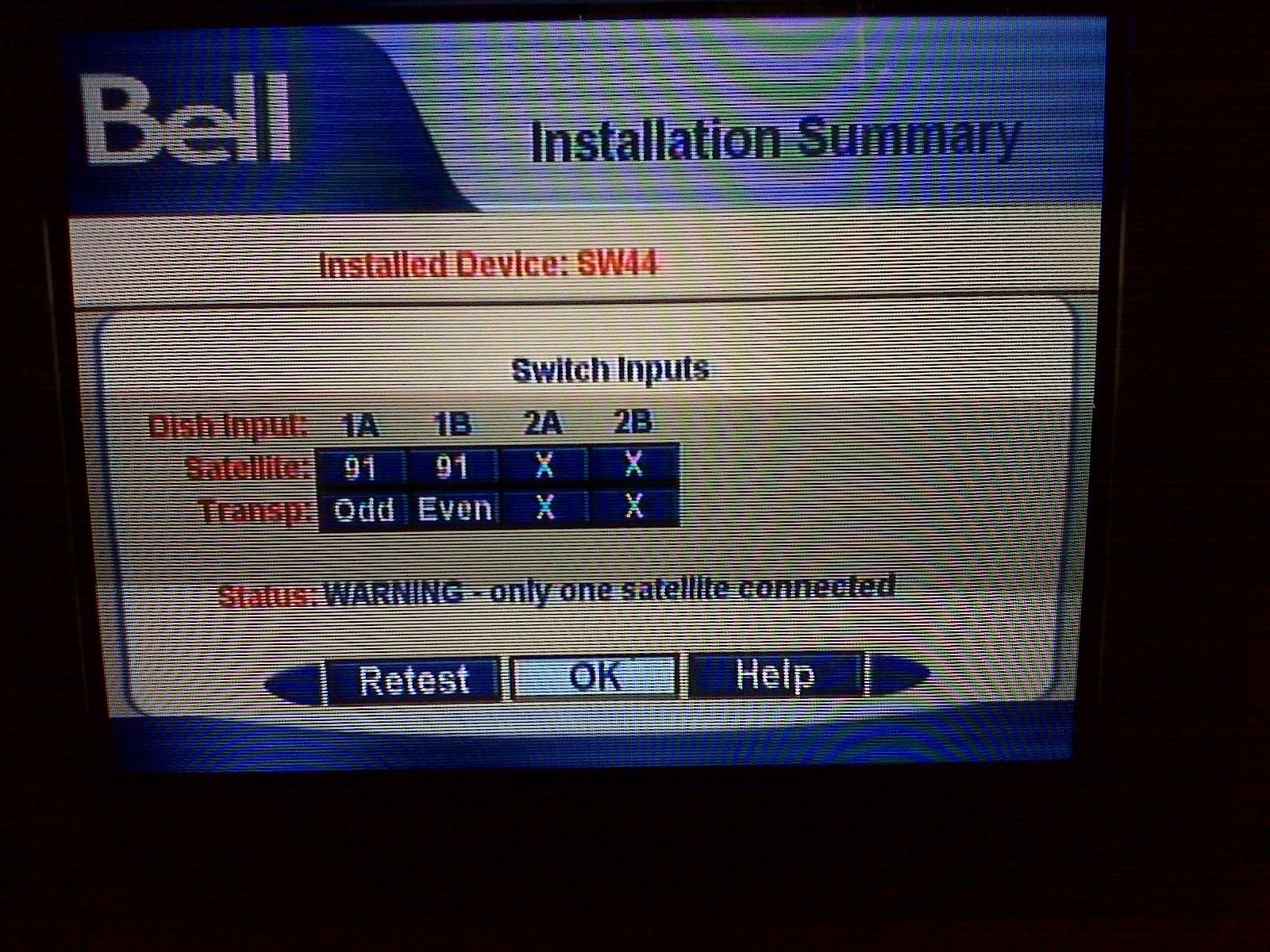

Actually, if you could post a snapshot of Check Switch screen ...
Ok so if I block the right LNBF (when standing behind the dish looking at the receiving end of the LNBF's) I lose the signal, so that means 91 is coming through this one...which is not correct? Does it matter?
Find attached the photo of the check switch screen.

Yeah, I see on that picture the SW-44 discovered, another good sign.

it should say "switch NONE" if no switch is attached
