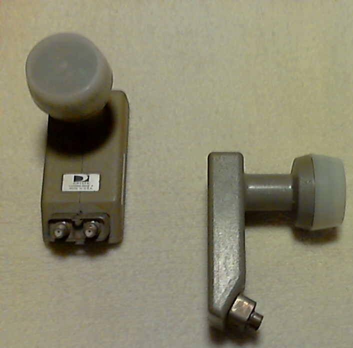

The lnb you need looks like this
The lnb you need is a single lnb and looks like this ...
