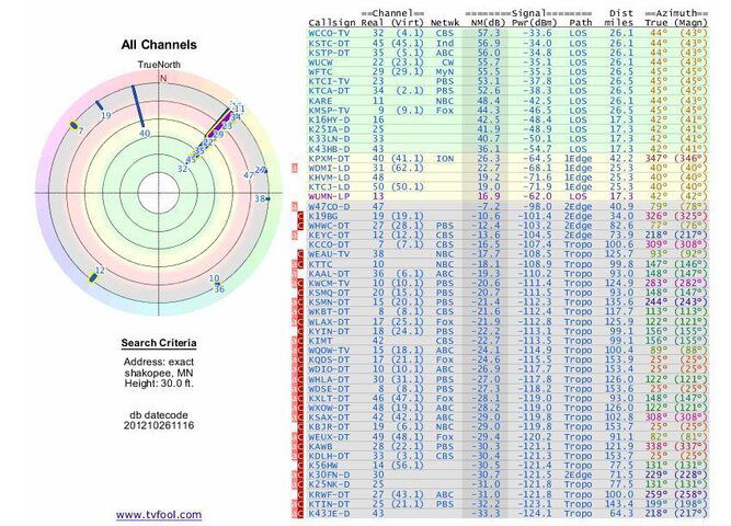

OK guys need some help
Moved into an apartment last week and finally getting everything hooked up. Trying to find a small enough antenna that will fit in a location and work well (not just good). I brought my "small" antenna with me (HBU33) and tried to get it in the walk in closet. Well its too big to be aimed properly but I did get most stations (the full powered ones) just fine but I keep running into it as I walk in there. I even hooked up a simple indoor antenna and it worked but the signal was really low (like in the 20's and 30's) so there was some pixeling. Want to use this for the bedroom and for the Directv AM21 in the main room. Right now I get Comcast lifeline free as part of the rent but they are going all scrambled early next year (lifeline is clear QAM now)
Here is my tvfool. Basically the nets is all I care about. Its weird as at the house I had a "billy badass" antenna (HBU44 and a YA1713) on the roof. Now I need something smaller. I dont know if an indoor antenna would work or just a small "outdoor" one

Do you have a window facing the transmitters? Do you want a clean look like the flat panel antenna in a plastic box or does ugly not matter?
Before you answer I will just say that from my experience living in an apartment the further away from the windows you get the more directional of an antenna you will need. My tvfool was stronger than yours yet I would still get picture issues when my upstairs neighbor would open the fridgerator door. There are so many opportunities for multipath interference in the typical apartment complex that it really is hard to avoid.
no. I'm on the south side of the complex and the transmitters are NE of me. The building runs E-W so its just the people across the hall then outside on the north side
doesnt matter really. Like I say the HBU33 worked fine but couldnt get it to fit properly in the walk in closet.
I'm on the top floor (only 3 floors) and the little whip antenna that comes with those 7" TV's worked (but very low signal as noted above)
So its pretty much trial and error with the antennas?
It is trial and error to get every station perfect. I had an amplified rabbit ear and loop combo that was worthless in the living room yet did great in the kitchen that faced the transmitters. I ended up finding an old Blonder Tongue indoor log periodic at a yard sale that fixed much of the multipath issues in the living room. It is similar in design to the Silver Sensor and other clones http://www.hdtvprimer.com/ANTENNAS/silver.html
