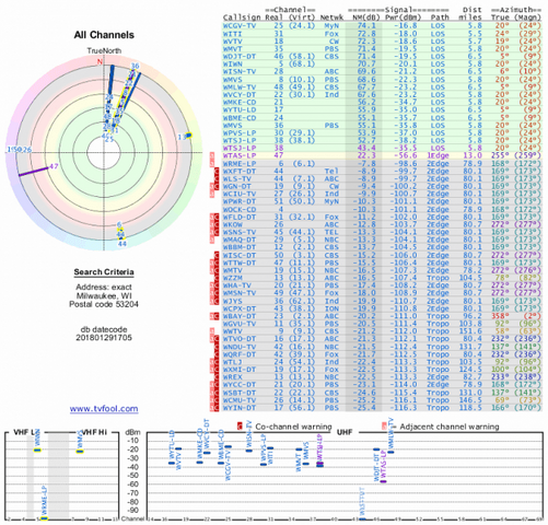

After you've got four or five posts under your belt, you should be able to post a URL to your tvfool.com results. This will help us pin down what you're up against.

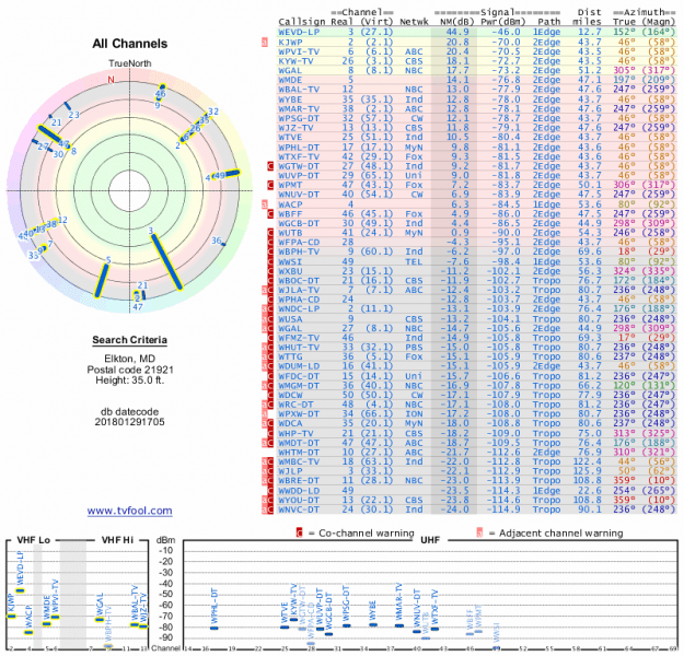

Go to the TVFool website and enter your address to check your signals. The site will generate a map for you and a link to it. It will look like this.

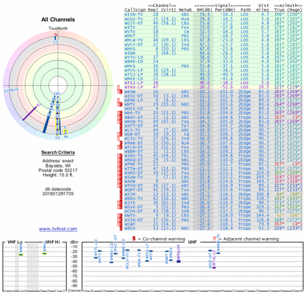

BTW, here is my tvfool

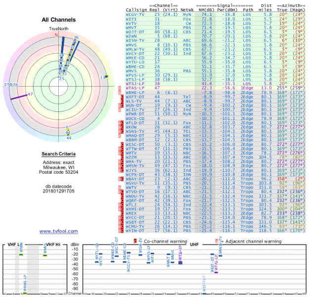

The only reason that I have a wifi antenna is to access to the internet and I thought that I can also receive all the OTA channels as well. I see that I was wrong about that. I did go tvfool that was suggested and I have gotten this is what I gotten.
These are the channels that I am able to receive.

Looking at the Clarbear's TVFool results, most of the stations are within a 15 degree beam and within 8 miles with Line-Of-Sight.
Most of the Milwaukee towers are in the same general area, less than 3 miles apart. His zipcode seems to indicate he lives in Walker's Point neighborhood and he should be able to use a paperclip for an antenna there.
In that location, a very large (fringe) antenna can actually overload the tuner with too much signal.
I would try something like the Winegard FV-30 for $35 at home depot. Always take it back if it doesn't work. You are close enough that I don't think you need anything fancy.

Given the TVFool projections, picking up signals in this situation is like fishing in a barrel. The biggest concern is getting too much signal.
