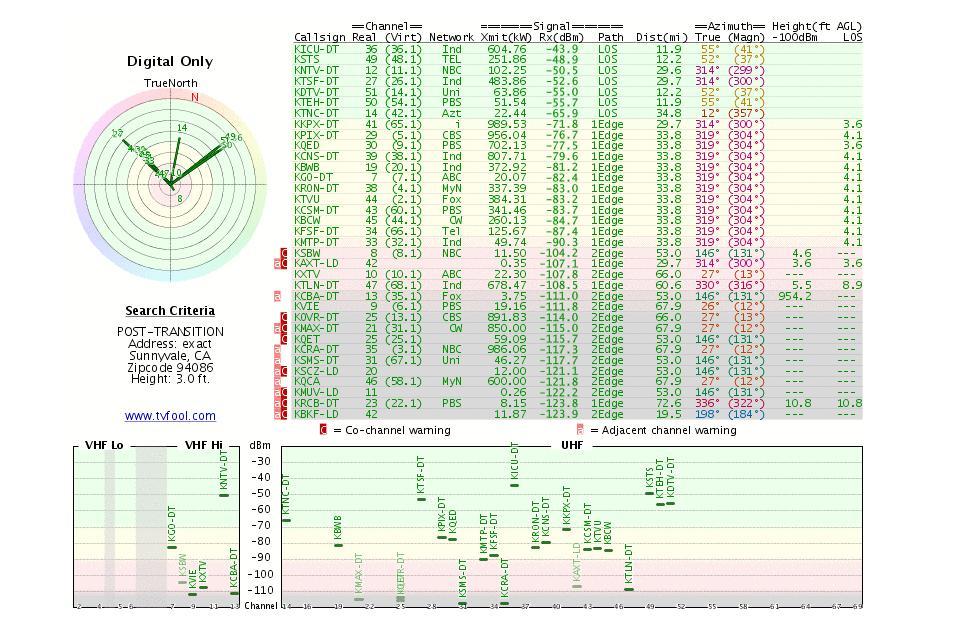

Does your home made antenna work on HI-VHF. I need an antenna that can work on VHF 7 and 12 plus UHF 19 to 63. I am in an apartment, patio facing south (took it for getting LOS for sats), where as all transmission towers are in North. There is no LOS to any Tx tower for me. I made a home made antenna similar to one made by [url=http://www.lumenlab.com/forums/index.php?showtopic=9613&st=650][I]BluBtl[/I][/url] and it works OK, leaving frequent breaks.
I prefer to keep the antenna in the storage room so that it is not visible to our apt owner. Any suggestion is appreciated.

To answer my own question- I bought CM-4221 and it was better than home made but signal used to break once in about 5 minutes. Yesterday replaced it with a CM-4228 and I get all the channels absolutely perfect.. It scanned channel 7,9,11 (Analog), but unwatchable. It also tuned in 5, but says no signal found after tuning.

It works okay for HI-VHF but I live real close to the one VHF HI and it is on 13. I have seen the CM4228 work just fine on a RF 7 channel that was about 20 miles away though.
