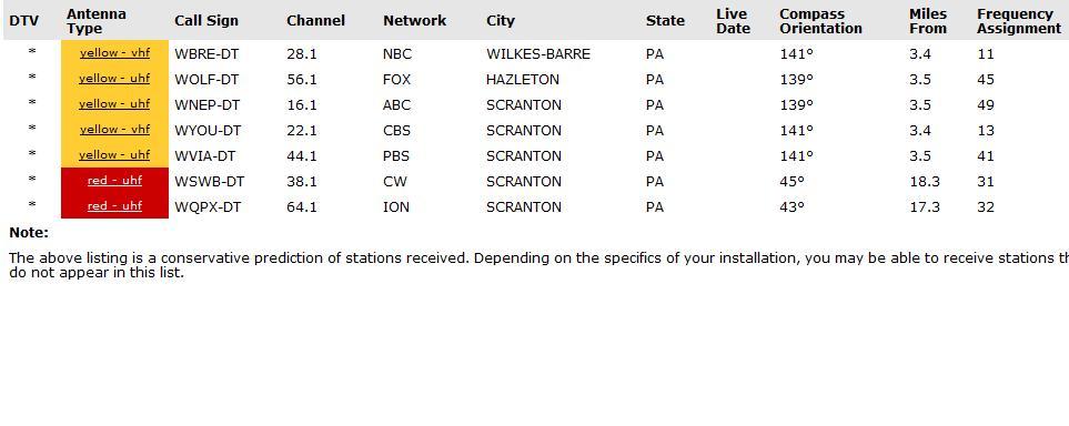

Here is a better representation of your Antennaweb results for others to read (easy on the eyes); I guessed with zip 18706. I still claim you should try the make & model I listed above (aimed correctly) even though WBRE and WYOU are listed as VHF; they are VHF-high and very close to you.
Dare I ask the make & model of the indoor you already tried? At that range I have seen rabbit ears pull great results.
