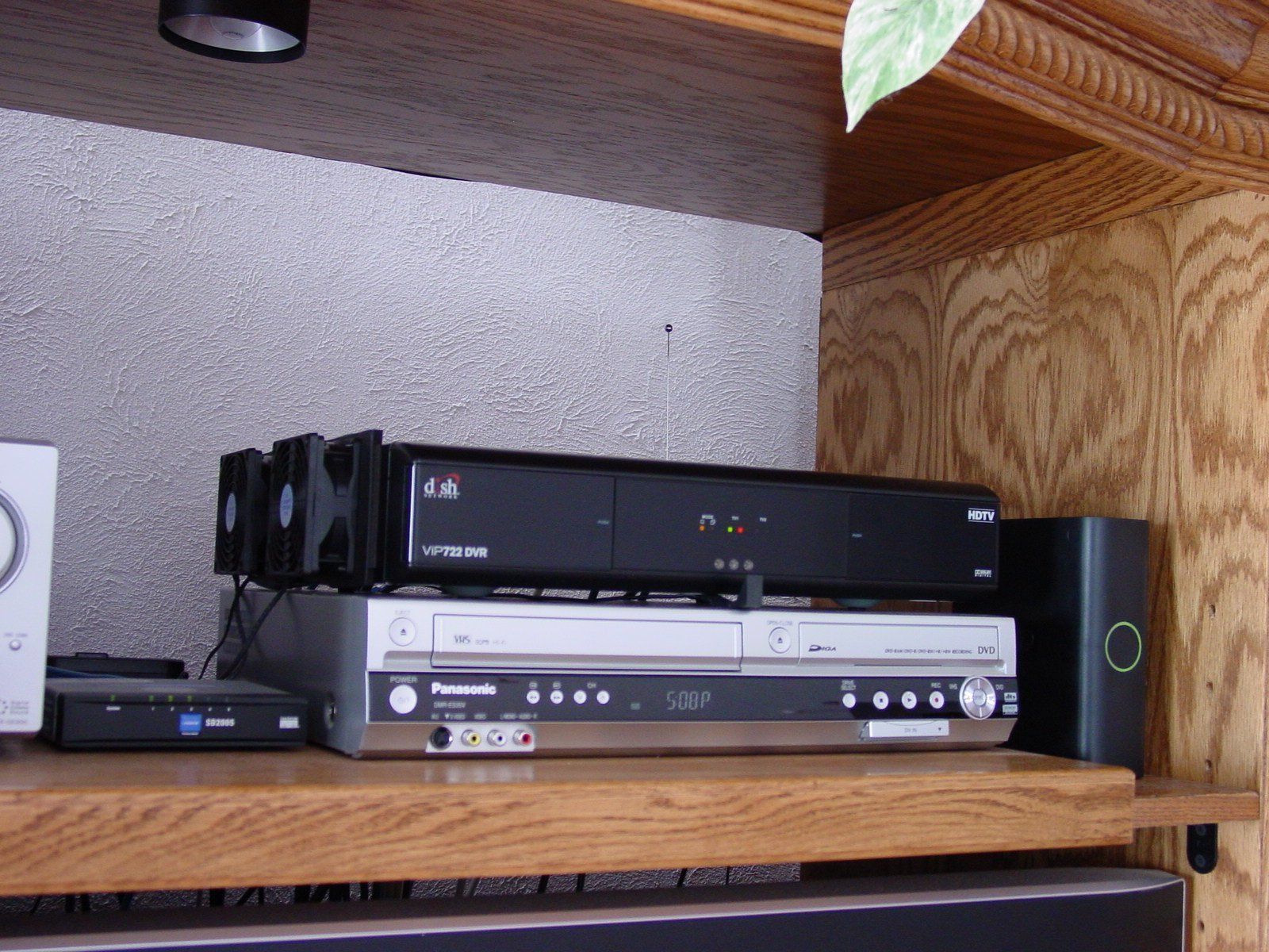

Temps are still coming down on two VIP722s. Did another configuration change of fans today. Going to leave them alone now and see if temps come down some more. Bottom line is one 722 has a Dish VIP 622/722 Cooling Fan System installed and the other 722 has two Thermaltake Mobile Fan II External USB Cooling Fans installed. All fans are mounted on the left side of the case at the exhaust vents sucking the hot air out of the 722s. I sure hope the new VIP722k (or whatever it will be called) has a better cooling system. Check out the attached spreadsheet for temps and web sites of the fans I am using.

Fans I have make very little noise. No issue at all. I was hoping for lower temps though. Maybe this winter they will come down some more. See attached spread sheet for latest temps and fan models.
