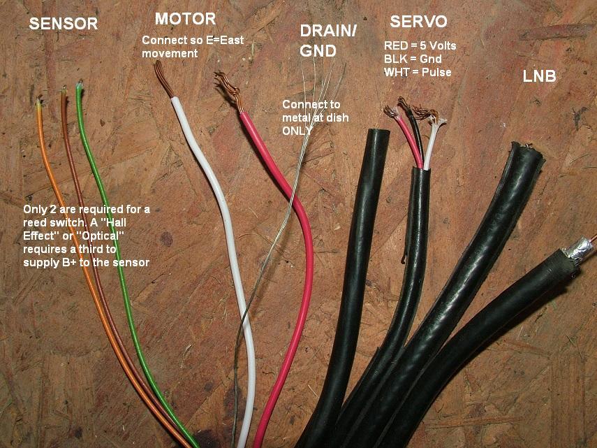

If the wires are disconnected from the receiver, and want to 'move the dish, this picture may help.
