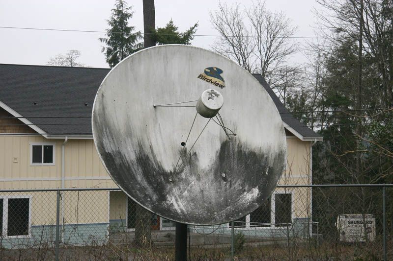

I've probably driven by this dish about a zillion times and so today I stopped to see it.
I asked the guy if I could look at his dish and he asked "Why, do you want it?" :)
I asked him if he didn't use it anymore and he said his son stayed with him and used it a couple years ago (????) and it worked then. He said he still has all the boxes in the house. He said he'd just as soon it was gone. :)
He said he'd call his son and ask if he wanted it or not. I left my name and number.
I thought this was fiberglass but it is aluminum.
Anyone know how well they work on KU and C-Band?

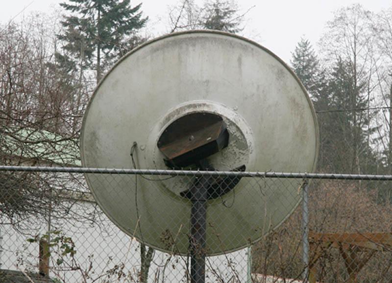

I can't quite figure out how the "look angle" is adjusted.
It looks about 8' but I didn't measure it

Looks like mine. Birdview 8.5 foot solid. A great dish. Any solid dish works for both Ku and C bands - so long as you have the right lnb setup. I use a BSC 621-2 Universal on mine. I think I have one of the few that works as advertised. That result is good luck rather than good management.
If it has the Birdview receivers, you might be able to slave them to your FTA receivers, meaning you might be able to use the HH motor on there without the reed sensor conversion.
I get every satellite from( I got the DeLa Hoya Pacquiao fight on this one - in Spanish) 55 west to (if I wanted it) 148 west. The motor is fast - faster than most little dish HH motors like Stab or Moteck.
Great dish! Puts my first BUD to shame. It's exceeded my expectations.
Get it if you can. Don't let on what a find it is. In my humble opinion, these hard economic times could spark a new interest in true FTA C-band, and that dish would be high on anybody's list.
By the way, if you get it, try to get as much of the mast as you can. I used a Skilsaw with a metal cutting blade. Took me about 2 minutes to cut it off .

Say, how do you adjust the "Look Angle"
Use a scoring tool to mark edges of the mount for elevation- at 7 miles, yours will be very close to where it's coming from. This helped me approximate the right elevation position for aiming. I took the Birdview lnb out and taped in an old Directv lnb I had, and hooked up an old viewsat receiver, setting it on "Beep to Scan" . I hooked in the sending unit to the audio outputs for wireless headphones. One of the Dish Network satellites is close to my due south position, so I got my trusty wireless headphones out (radio type, inexpensive) and moved the dish around until I got the most and highest frequency beeping. Worked for me real well.
Remember to pack it carefully for the trip home. I don't recommend it be shipped on its edge. The parabolic shape on this dish is pretty exact and you don't want to deform that.
The dish itself is light, but bulky. Get a friend to help you take it down off the mount. I'd probably leave the struts and lnb on the dish and set it on its back in or on the bed of a truck, with the lnb up in the air.
The motor assembly weighs a ton. Hardest thing to move.
It's a great item and you will get a lot of great setup help on this forum.

That is ONE DIRTY DISH. Take to the dish..er I mean Car Wash.

I'd say 75 pounds...I did mine with two guys. Two guys can do the motor too, but they have to be beefy guys, its heavy. I'd take three total to be safe. :D
IMO how I would do it is mark the elevation, then loosen all the elevation bolts and tilt it where the dish is pointing upwards as much as possible, then tighten the elevation bolts down again.
THEN take the dish-to-mount bolts out, I'd put a guy on each side of the hub while you remove the bolts, then slowly lift if off the mount,(the dish will be over your head here, at the end of your arms straight above you, so don't take guys with short arms....LOL) then walk it to open area, then slowly work the dish until you both can grab the rim, then you can go anywhere you want with it.
Then you can take the motor off the pole...be careful here it is VERY top heavy.
Hope some of that helped.
other way around
Actually, I think you lift the white dish 'n LNB off the black mount.
Then, wrestle the mount off the pole.
And, don't forget to save the unique 6" tubing they use for the pole.
