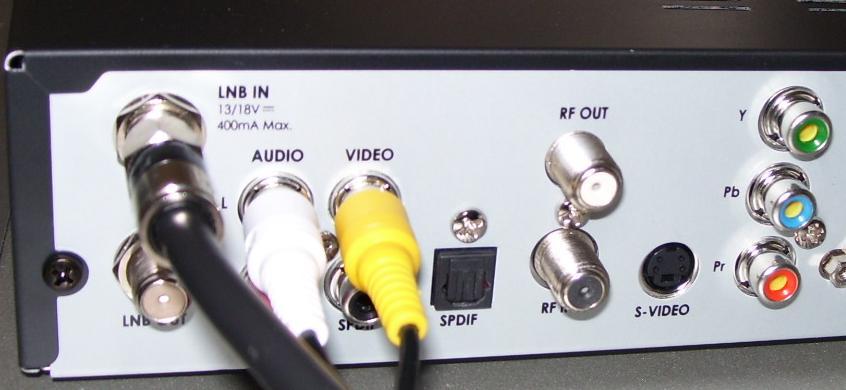

I noticed that I was not getting any signal at all so I did the following.
I flashed the receiver back to firmware 1.20.
And moved the cable coming from the "LBN IN" to the "LBN OUT" and then it worked!
I figured since I was not getting any signal maybe the connections inside the STB were backwards.
This picture is really Iceberg's but my cable is coming from the lower connection and NOT as displayed here.
Tried that on my Visionsat and was able to receive channels ok but at a lower signal and quality numbers. Motor and switch control does not work, hooked up that way.
Looks like you have a bad LNB IN port. Double check your cable end at the receiver, maybe
bad connector install, intermittent short circuit?
Should I RMA this unit?
If I understand you right I should RMA this unit and get another one - - - correct?
I did notice that the blind scan did not find near as many channels as the Fortec Merc II. Also the Merc II found 6 radio channels and the Visionsat found zero.
I would RMA it...sounds like a bad unit
