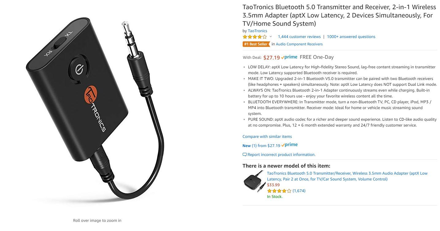

It sounds like he is just using a USB Bluetooth dongle, he needs a Bluetooth audio transmitter. Something like this will work, and includes RCA to 1/8" adapter for connection to the Joey.

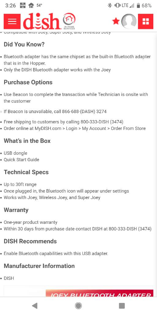

Did he get the dish branded Joey Bluetooth adapter? I've paired an entire Polk audio system to a Joey 1.0 in the past with no issues.
Tech portal doesn't specify it works with Joey 3, but I don't see why it wouldn't...
Yes, his is the Dish-branded version, purchased from Dish. The Joey 3 at least recognizes the adapter, as it activates the Bluetooth section in the menu...just fails to recognize that the speaker is trying to pair to it.
It sounds like he is just using a USB Bluetooth dongle, he needs a Bluetooth audio transmitter. Something like this will work, and includes RCA to 1/8" adapter for connection to the Joey.View attachment 138814
Thanks for the Amazon suggestion. I may look into that, but what is the Dish USB Bluetooth dongle intended for, if it's not for transmitting audio? :confused:
