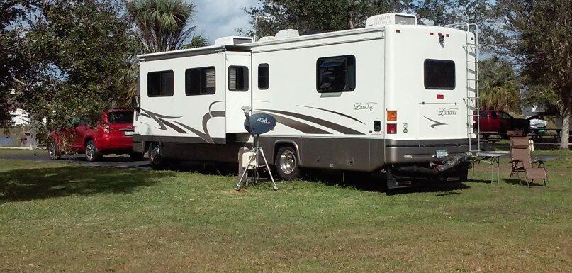

Too high for what? I've used the eastern arc several times at Midway Campground on the Tamiami Trail (US 41) about 50 miles due west of Miami with a 58.4 degree elevation.
