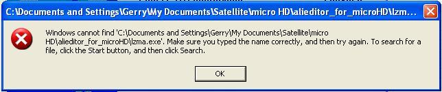

I've tried twice to recover the microHD, and failed both times. The transfer tests the serial port status OK and collects STB information to "Finished" status. Then the following error is displayed.
I can click OK and the program continues to completion, including burning to flash. I disconnect everything and all I get is the boot loop.
I am using the most recent .abs file from the sticky here. I am using the driver from wallyhts' site. I am using the microHD_ALI editor from the sticky above. I am following the pdf step by step.
I'm going to restart the computer and see if anything changes... Any suggestions are welcome.
OK, here's the next deal. The SatApps that comes with the driver from wallyhts has an ALI Editor and lzma.exe file included. If you take the ALI editor from the sticky here, you don't get the lzma file. Pretty simple...
The update went through everything without the error. But the boot loop remains.
