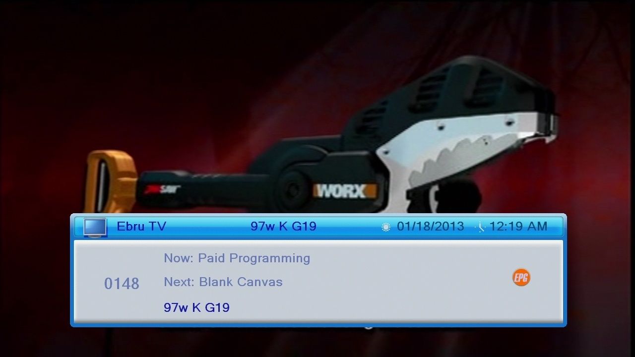

Found the Ebru TV channel at Galaxy 19 KU.... Did not see any sign of an EPG program information at all.
I am pressing the EPG on the remote but nothing is being shown for the past or future of those channels, everything after the channels names is/are blank.
Read the manual section for the EPG, followed instructions as written, nothing happened. Either the Ebru TV channel EPG function is not active, or I am missing or missunderstanding a step in the reading of the instructions.
Thanks.
Ebru is transmitting EPG flag and data.
The channel must be tuned for a few seconds to start populating EPG.
Attached is a AVI file showing a few channels and EPG.
The first channel shows no EPG flag or data transmitted
2nd Channel Shows EPG flag and data transmitted, Press EPG key to open EPG screen, Look at a few EPG basic descriptions, Schedule a DVR Recording, Verify the DVR timer setting.
3rd channel shows EPG Flag, but no EPG data transmitted.

This morning the Ebru TV channel had active EPG function, as I mentioned before, this channel last night did not showed any EPG information, go figure... I went and searched all of the channels from Galaxy 19 KU, there are a lot of channels with the "false flags" as you called them.
Wrote down a list of the channels with the active EPG flag for future refference....Will keep on playing/working with the microHD and will search for more interesting things to do with this receiver.

This is typical for DVB EPG.
EPG data populates as the channel is viewed. When the channel is first tuned, only a few program names for Current and Next may be displayed. Over the next few minutes or more, EPG data is streamed from the satellite to provide future time/date information and descriptions.
The update speed is dependent on the amount of bandwidth the uplinker is using to push the EPG data.
