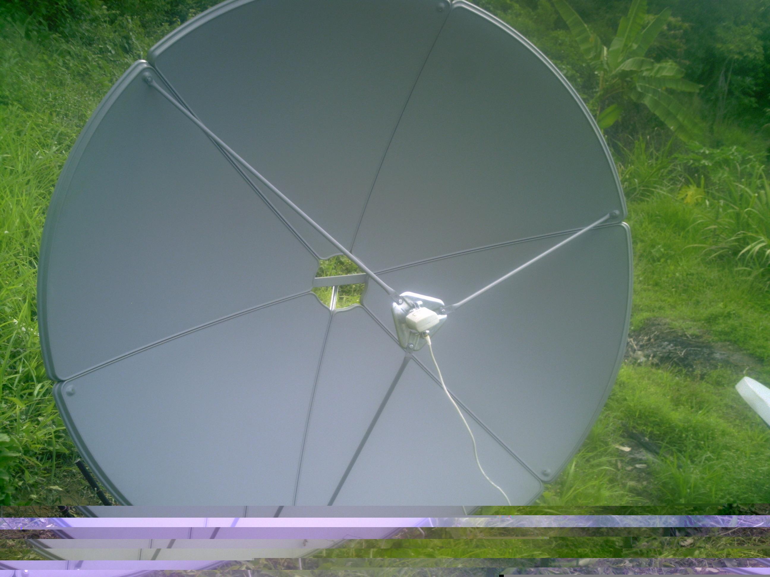

I just set up a 1.8m Prime Focus dish and i want to know the best LNBF to use on it. I am in the Caribbean and i am some what interested in AMC4 Ku-band for I doubt I will get C-band. I am wondering if the BSC621 will be a good option.
I currently have the Invacom SNH-031 installed and I am getting 3ABN at 60 to 84% quality. 84% on evenings/night and 60+ during the day. Is there a better LNBF I can use?
Photo of installed Prime Focus Antenna
Well, in theory, any Invacom LNB with a flange instead of a horn
eg: snf-031, twf-031, qpf-031, etc. . . .
when attached to their ADF-120 feedhorn, should allow the LNB to get signal from the entire surface of the dish.
Most offset LNBs have an f/d ratio of about .6 or .7, which is a narrower beam.
The ADF-120 has an f/d of around .3 to .4, (wide beam) which matches your prime focus dish.
So, if you are interested in spending money for more signal, that might get you some.
Please research the matter, and get input from others.
Like I said, this is the theory, but I haven't read where anyone reported actually measuring the results.
I've read nothing to suggest the C/Ku LNBs you are looking at would give you better performance than what you have.
Generally, the Ku portion of those dual-band units (there are two brands), is not up to the (down to the?) noise figure of your Invacom.
And more importantly, one of the brands documents its Ku f/d in the .6 to .7 range. :(
That's a pretty dish. :cool:
Is your daytime reception not acceptable?
Or do you just have too little rain-fade margin?
