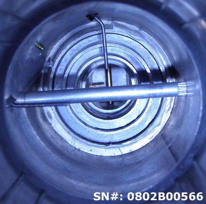

Here is a pic of my BSC621-2 with S#.
Does this look correct?

Care to post pics looking down the throat of your fixed BSC621?
I checked mine against the "Fix It" PDF and it says I'm fine. :up
Signal Q says otherwise. Performs about as well as my 75e :mad:

Where is this "Fix It" pdf?:confused:
Edit: Never mind. I found it here.
