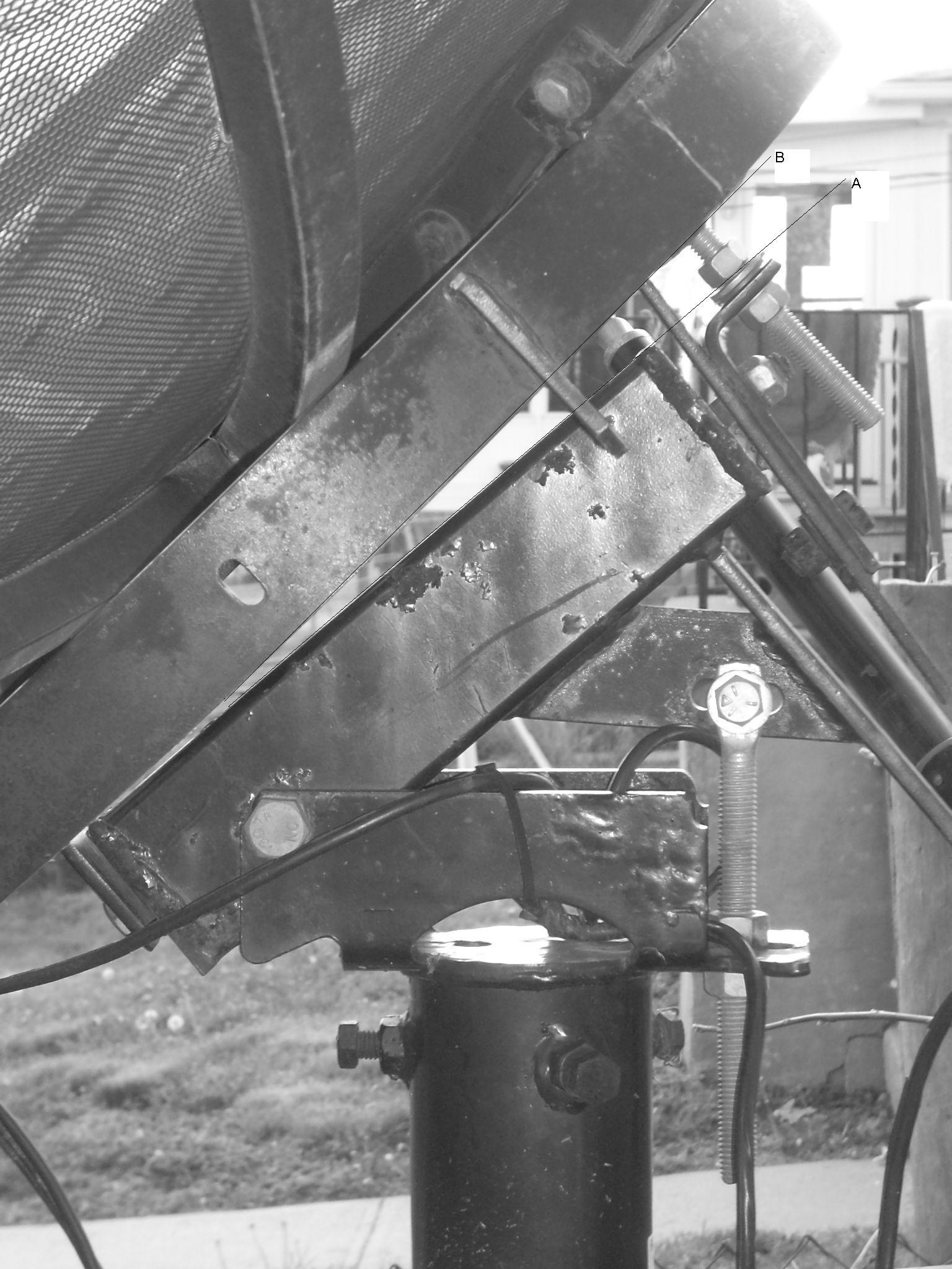

Setup my first BUD years ago, and although I can find all the same documentation I am losing in setting up this one.
I am at 94* 49'W 39* 45'N making my Galaxy 3C my true south satellite, which would put my declination angle at 40.21*, declination angle at 5.51* and apex elevation at 44.29*
In the attached picture, point A is my apex elevation and point B is my declination angle?, is this correct?
This is were I am losing, I have set the angles as stated above, even switch them because I was not getting anything.
My analog receiver was a Chaparral Sierra III (was because it has died when I was trying to get this BUD setup a few weeks ago :( and I have not found a replacement yet. My digital receiver is a Coolsat 6000. I have 2 splitters and a DiSEqC switch in the loop, I have tried with and without the splitters and the DiSEqC switch, both without success. Can I run directly to the digital receiver without an analog receiver?
I get a level around 50% and quality at 10%, which I guess could mean a bad LNB because you probably get those levels by point at the ground :)
any help would be appreciated! :)
thanks

declination
Yes stick your angle-finder to the backside of the ring (SURFACE B) to measure
declination. I find it easier to do with the dish at due south, jus because the little magnet base holds it better that way , haha.
And yes you can run the coax from the lnb direct to the reciever , it should work if you're aimed at a satellite. Since you didn't say how you're moving the dish, I'm just assuming here that you had it stopped on a satellite when your c-band died.

First thing is put a level on the pole and make sure it's OK, also put the level on the mount to make sure it still is level on the pole. I would then move the dish to either G5-5 or G4-16 which are both analog and adjust for the best signal you can get and if your arc is set correctly then the other satellites you need should be easy to find.

If the pole is still plumb and you have the elevation/declin.set right, all you need to do is rotate the dish a bit to the east on your pole. (which might require a slight lowering on elevation) Try scanning G3 c-band with your fta and see if you can hit anything. Remember to mark on the pole/mount with something you can see, at the place it is now, before you loosen those bolts and make any adjustment. You can always go back to that point. Tiny increments, 1/8" or less will make big differences at 22,000 miles!
