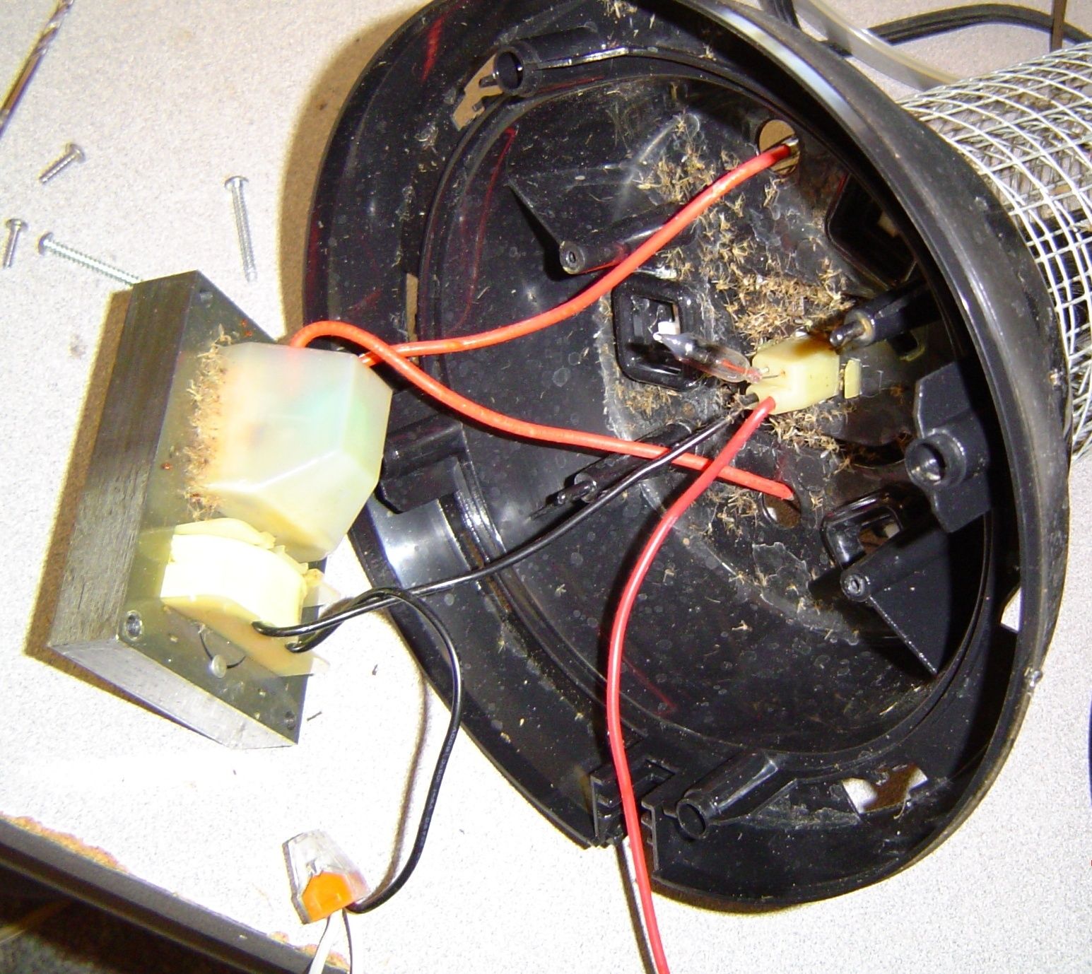

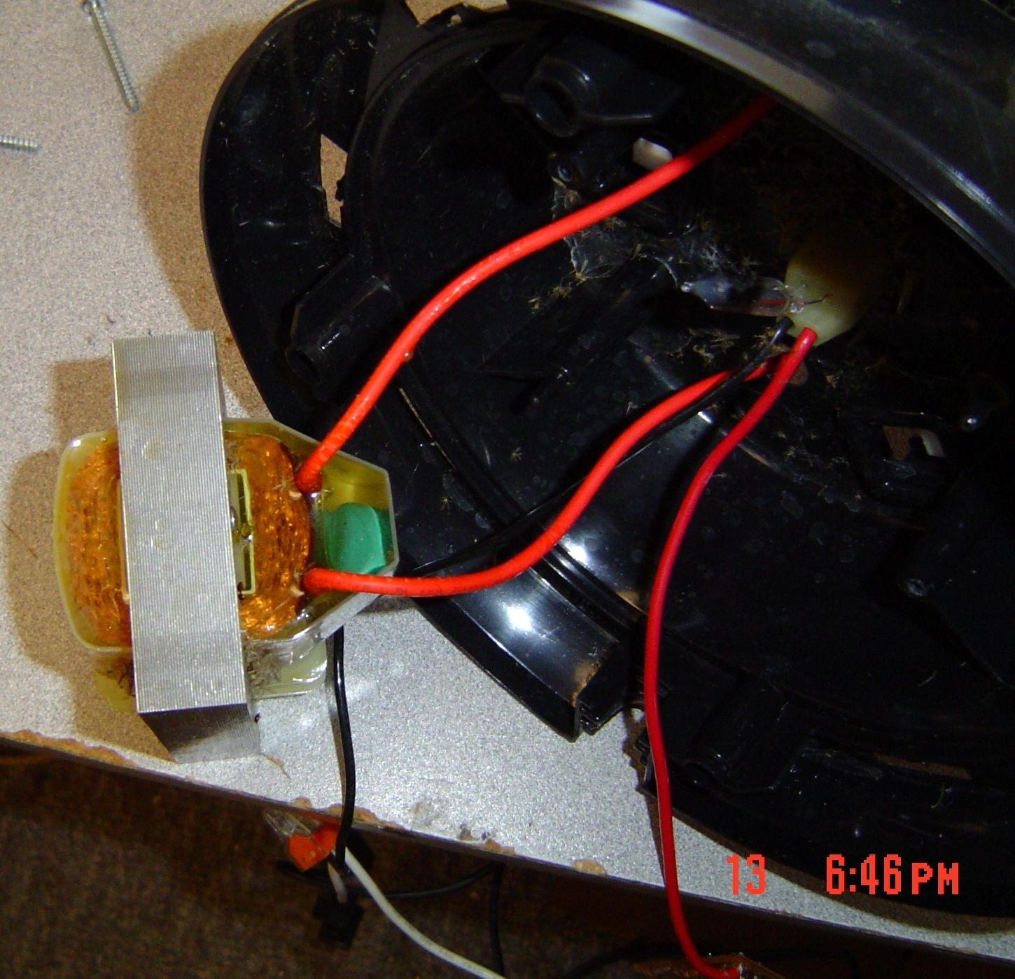

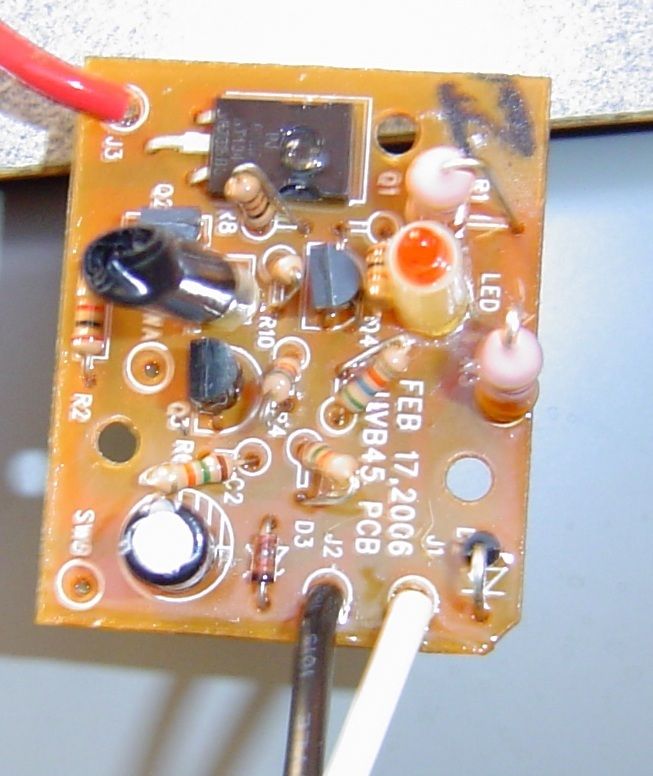

Well it quit zapping. The light still comes on, and I see nothing fried on the little switch board, and the transformer puts out enough juice to turn on the light, but nothing on the zapper.
Here are some pics of the switch board, the transformer, and how it hooks into the back of the unit. I am suspecting one side of the transformer quit, but that's why I am asking here. I put electrical tape over the light sensor so the power would stay on for testing.

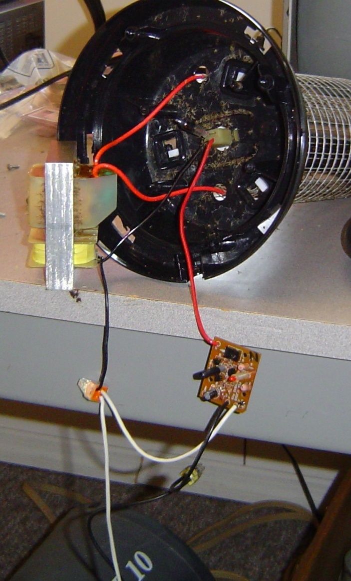

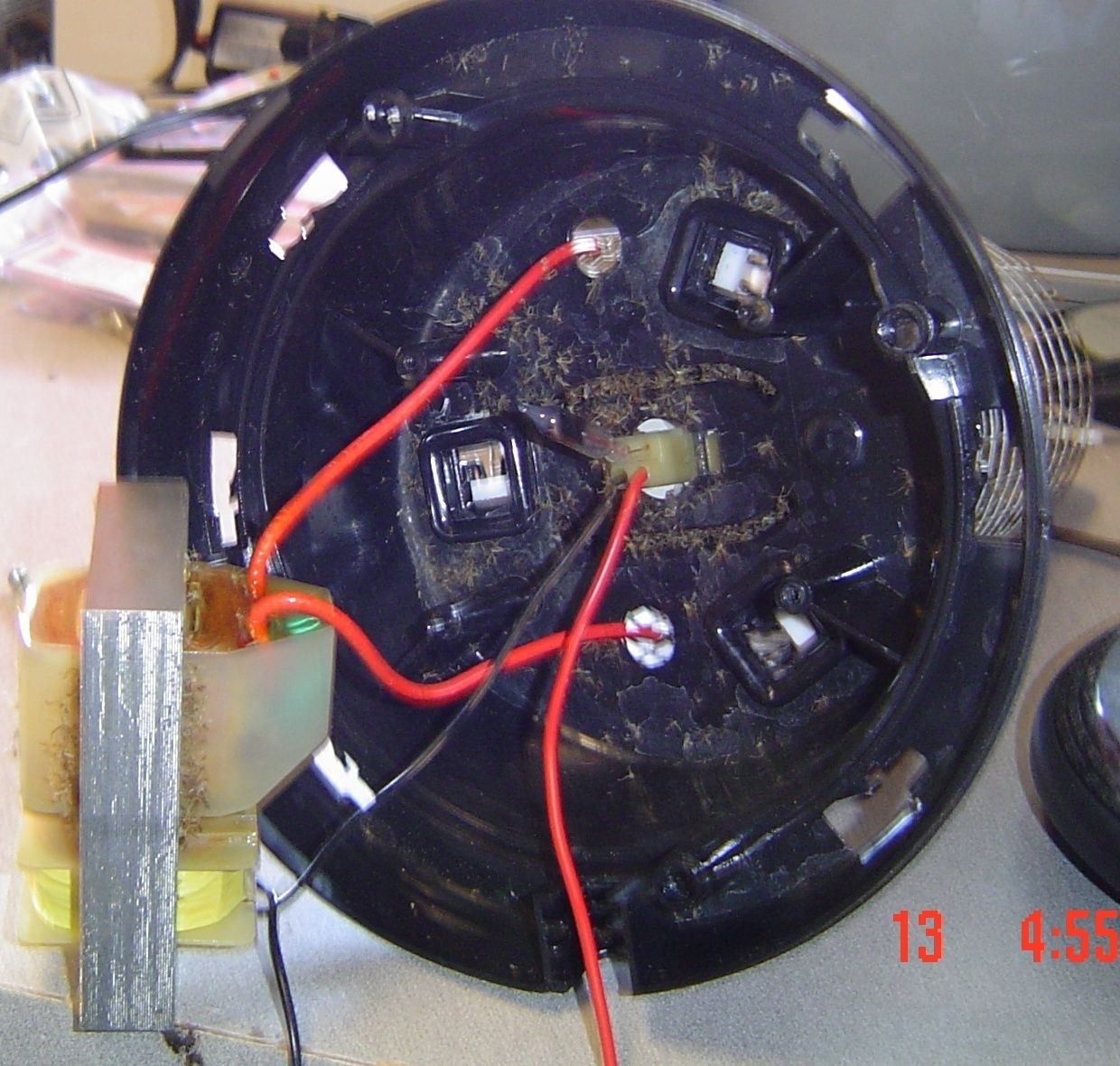

The bulb works fine and comes on fine. It is on a different side of the transformer.
In thest pics, the current comes in on a black and a white wire. The black wire goes to the switch, and the white wire gets split with white going to switch and black going to transformer. Black out of transformer to light assembly combined with a red from the switch to the light assembly.
No visible wires, but on the other end of the transformer, two red wires come out and go to the connectors on the grid. One for the inside of the grid, and one for the outside.
I have inspected it closely, and there are no shorts. The connectors are tight, so I would have to say that the red side of the transformer has quit.

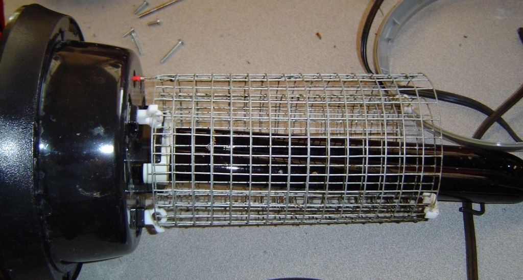

Here are some more pics:
Just to make sure there were no shorts, I unhooked the two red wires coming from the far side of the transformer and put the meter on them. It shows like .013 V DC. I can put them together and nothing.
Usually that grid has sparks jumping on it all the time.

Hey, try peeling back the paper over the windings on the transformer a bit. Right where the wires go into it. There's probably a wired fuse or self-resetting circuit breaker in there. If so, replace the fuse, or jump the circuit breaker with a fuse! It's possible to zap so many bugs with this, that the "bug juice" shorts out the fuse or snaps the breaker so hard, that it won't reset.
Thanks for the tip!
I'll take a look at it in the morning. :)
I just took a quick look at the transformer.
There are two parts. The only part that has paper over the windings is the part where the power comes in and that also feeds the light. That part is working.
The other half of the transformer is encased in epoxy and also surrounded by plastic. I can see electronics inside the epoxy, but no way to get to them.
If there is a breaker or fuse for that part of the transformer, it is inside the epoxy. :(

Well, I see two lines of attack:
1. double check that there is nothing shorting the innner and outer wire cages together.
Consider unsoldering one and then put your DVM on ohms range and check between the two wire cages
NO POWER, of course.
You should get the same reading as if the probes were connected to nothing.
2. hard to see in the pictures due to the black background
That little glass capsule about 1/4" diameter and 3/4" long looks to be an neon lamp and it's been overworked.
See the black inside? Can you get pictures with a piece of paper under/behind it?
Go to your local store and get an NE2 Neon lamp.
Or, try the 99¢ store and look for a night light with a modest orange glow.
It'll have an NE2 inside.
If it's got an LED, it sure as heck won't be a dim warm orange glow.! - :rolleyes:
The neon tube is probably part of the circuit that fires the zap!

That is a distinct possibility!
When you first plug it in, that little lamp lights up, and when the big light under the grid comes on, that little lamp goes out.
Don't know how that figures into the picture, but you may be right, and I wondered about how black it looks.
