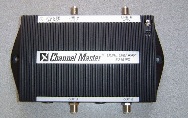

I went down to Skywalker this afternoon and told my buddy what I was going to do and I told him about Labgate's Thread and the need for a powered multi-switch plus a power inserter for the 13V side.

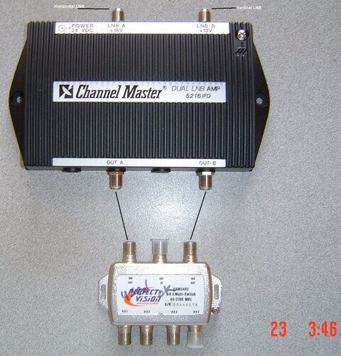

He sold me what the picture shows. I think it is more or less a powered multi-switch, but I have included the instructions, and a picture of how he told me it should be hooked up.
I checked the 13V and 18V input sides, and they do produce 13 and 18 volts respectively. I thought the whole point of the power inserter was to get the voltage on the 13V side up to above 15 volts, but what do I know.
I can take it back, but these were very cheap. I think he wanted to get them out of stock. Said they were $100.00 retail at one time.
Let me know what you think and if I should get something different?

This would certainly take the strain off the Twinhan having to power the LNBS, but don't know if it is enough?
Hello
Yes it will help your twinhan card very much. it won't have to supply the current. You will get the same result as I do.

Just a couple of questions, don't you have a power inserter on the 13V side of your setup?
And if so, do you think I need to get the power inserter for my 13V side for the vertical LNBs?
Thanks!
Hello
No you don't see it very well on the pictures of my web site but there is a power supply connected to the switch, it is the multiswitch that insert the power, like the one you have in you pictures.
