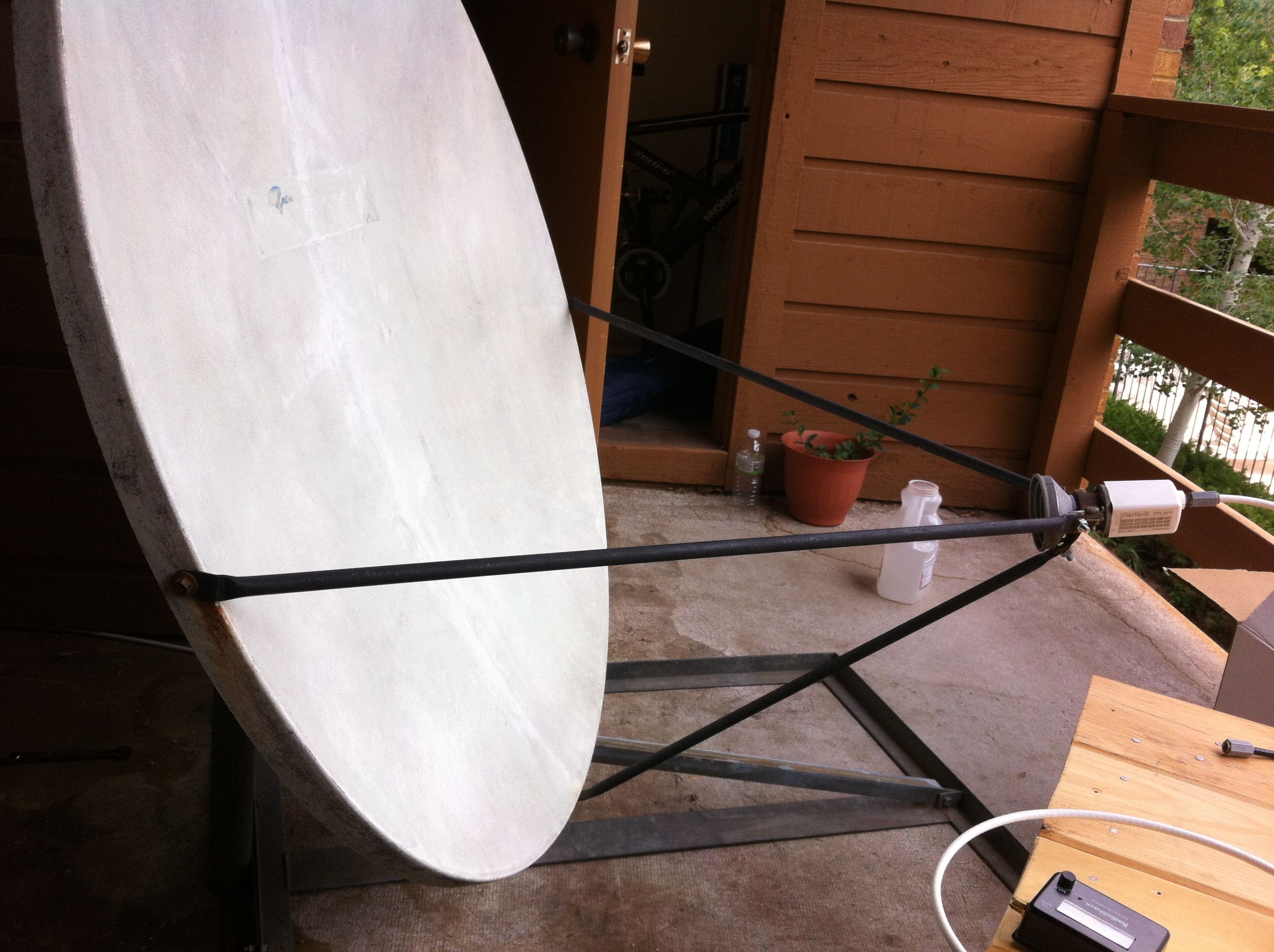

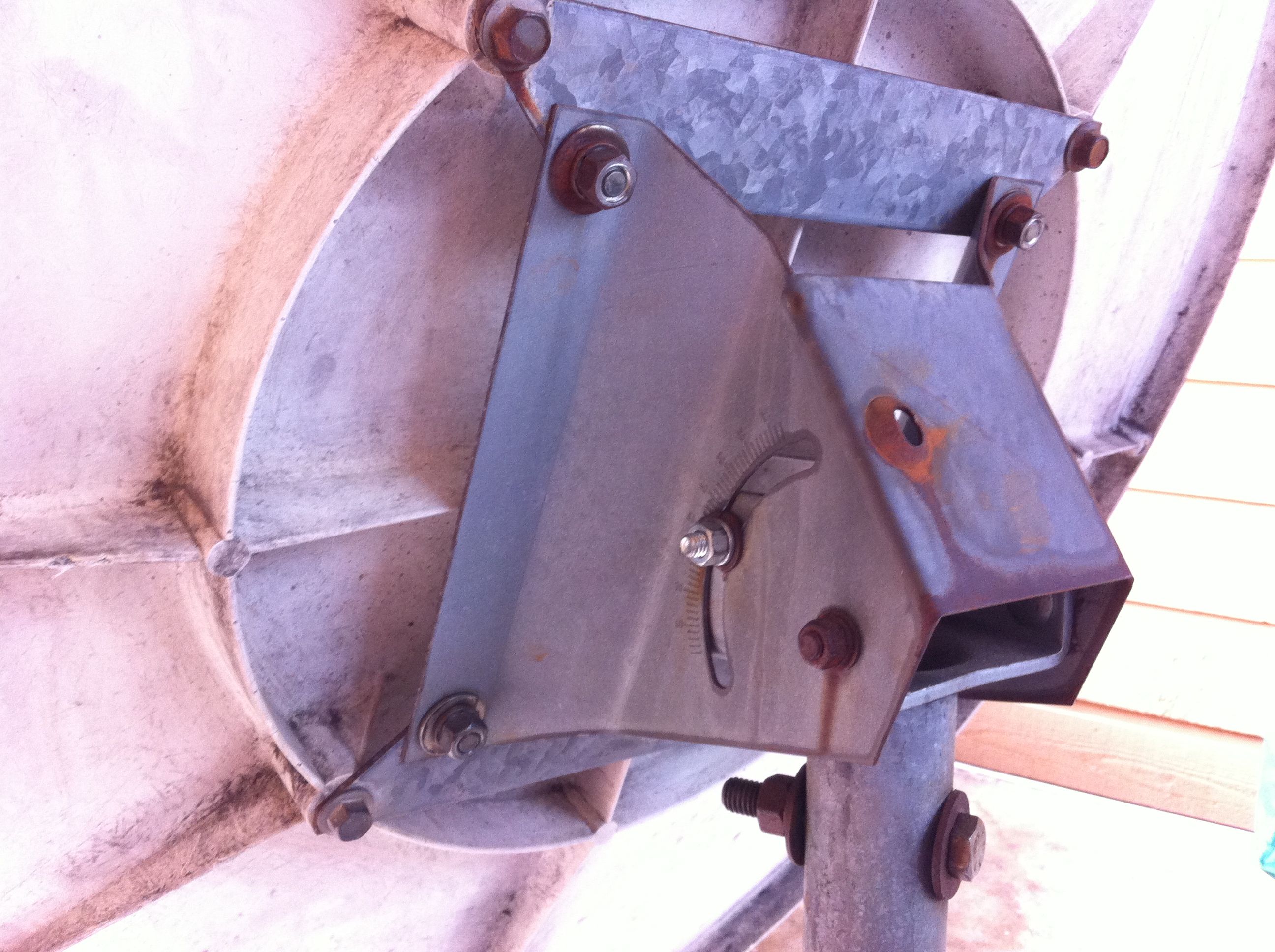

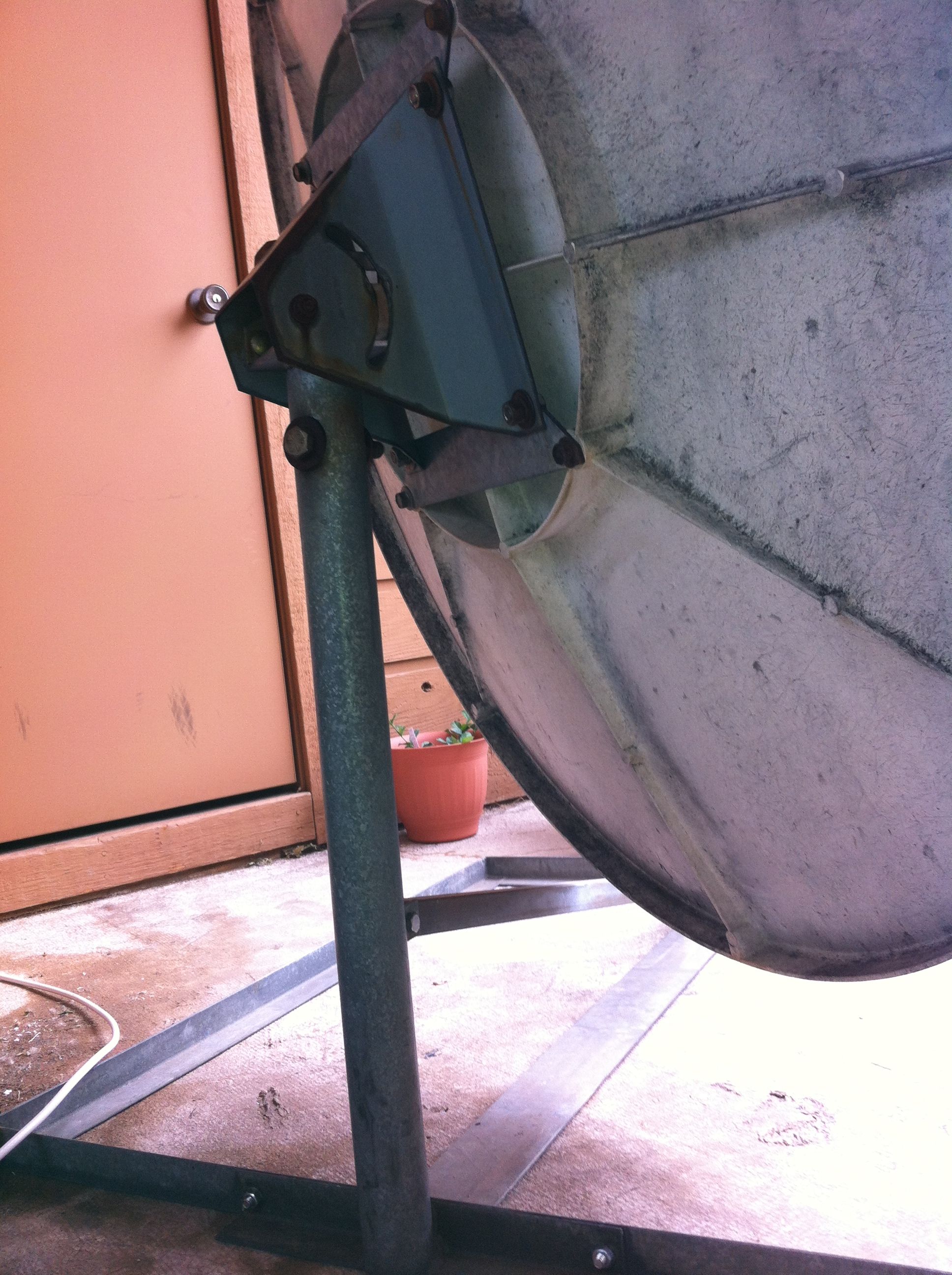

Now that I have a little time, here are a few pics. First up is the 1M dish. Heavy duty, solid construction, too big for the balcony. I had to brush up on my trigonometry to figure out where it could go on the balcony and actually get a signal from the targeted birds (not blocked by the railing, not blocked by the balcony above). The ideal spot is RIGHT in the middle of the balcony, or on top of the table that's hiding the TV antenna. The base for the NPRM is the main problem, as it's around 40x44", and the balcony is small. Also, in the 3rd picture you can see the diagonal bar that keeps the pole upright. I can't have the dish aimed over the bar at an elevation below 45º or it'll hit. The dish needs to be tuned away from the base, ideally 90-180º, making it take up even more space on the balcony.
IMG_0754.JPG IMG_0758.JPG IMG_0761.JPG (yes, the fine elevation adjustment is gone. It was more rust than anything when I got the dish).

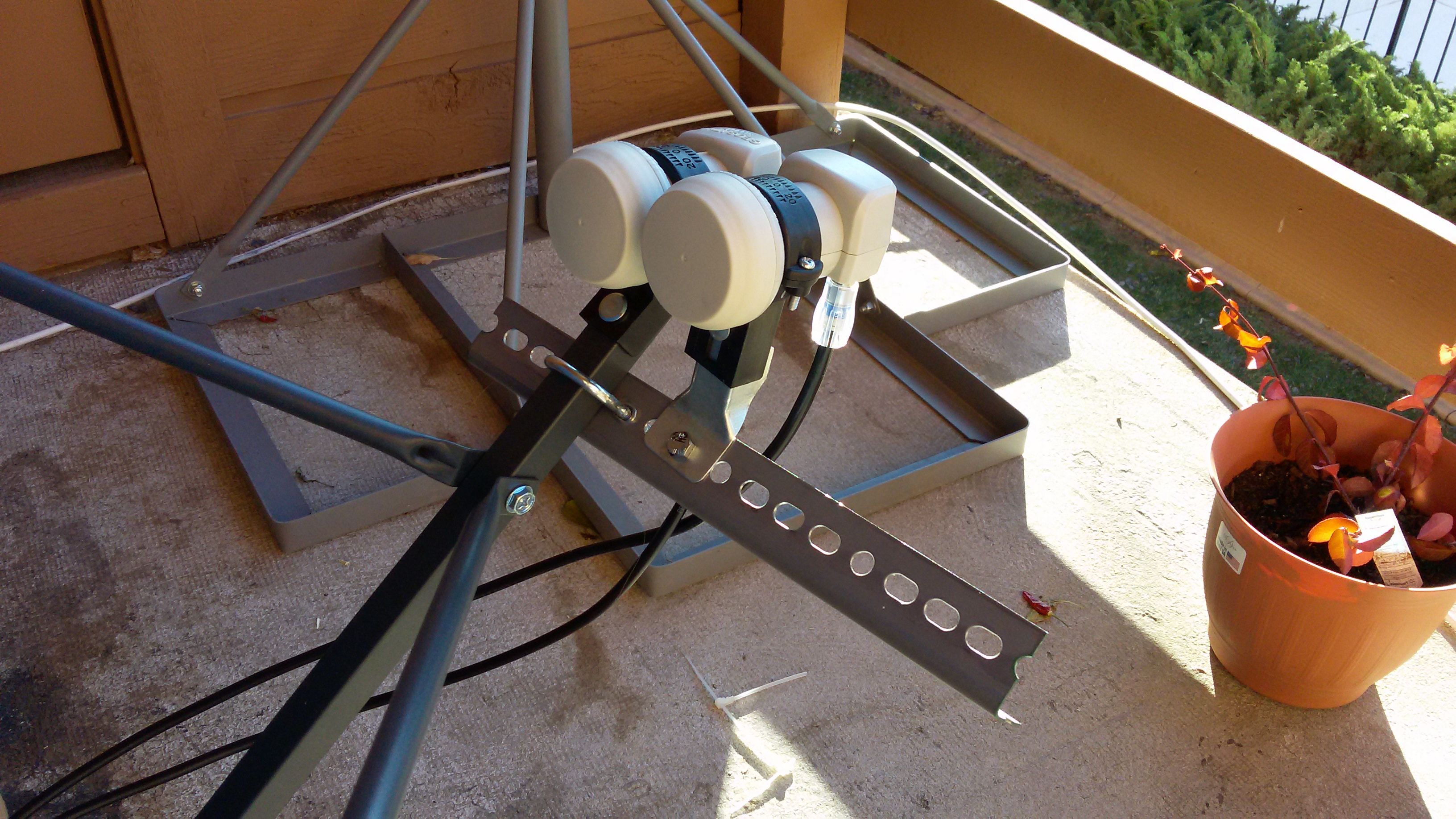

Here's what I have set up right now. I screwed the Geosatpro mount onto some pieces of 4x4 as a temporary mount before trying to put it on a different NPRM. 125W is nice, but since we get 3 PBS's OTA (Rocky Mountain PBS, V-Me, Create) I figured I'd try elsewhere. It's currently aimed at 103, getting everything I should be getting less the Huntington beach cams. Since I already had an extra LNBF and switch (planning ahead) I attached the second LNBF to get 97W and have 180ish channels from there so far before peaking it. The base is obviously smaller, and the arms don't stick out nearly as far, so it has much more wife appeal.

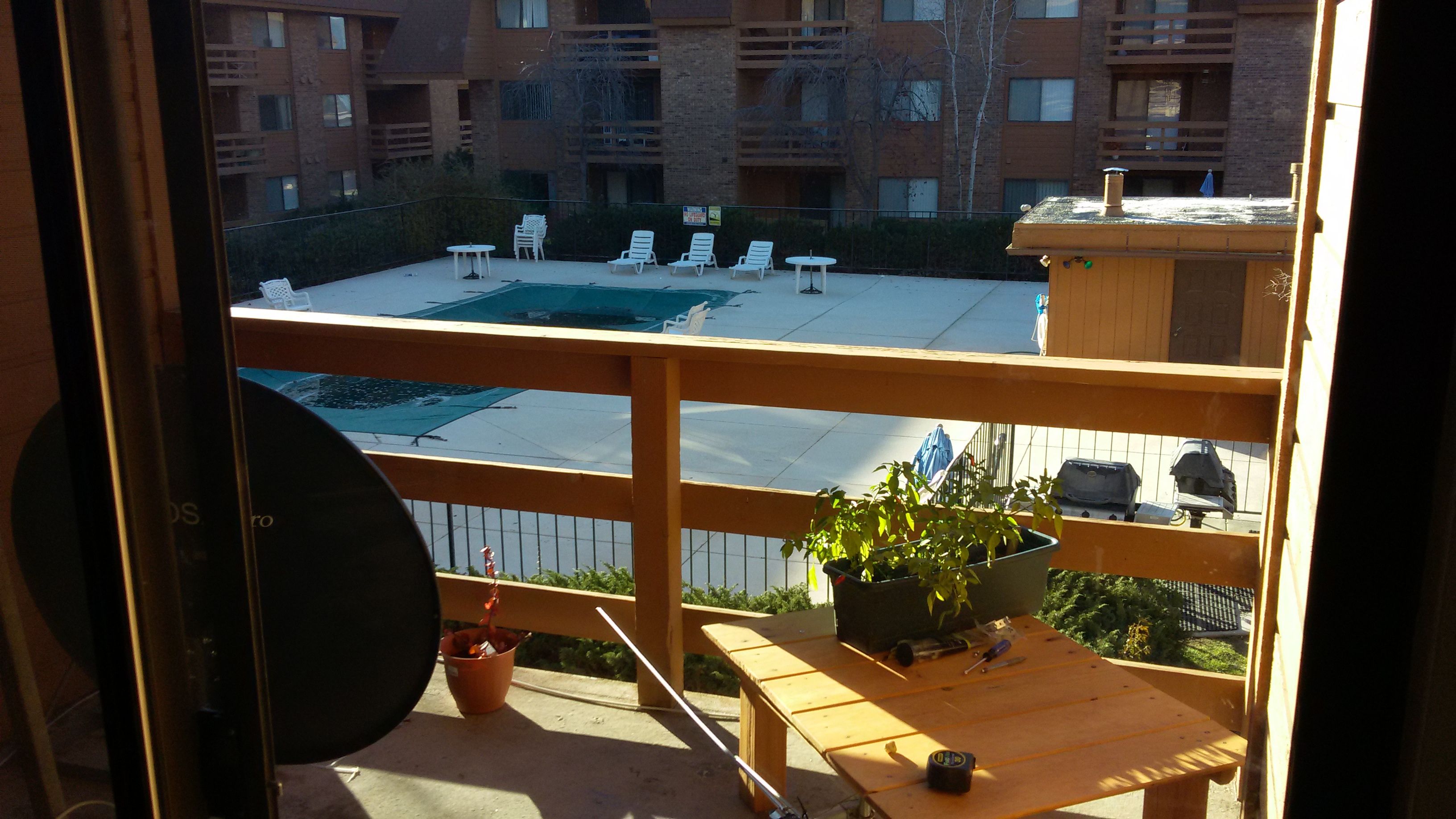

The fiberglass dish would be tough unless I figured out a new way to mount it. With the size and shape of my balcony, the only place to put it right now is right in the middle of the balcony. Here's the layout right now:
Using the current mount for the 1m, it would have to be put in the notch by the sliding glass door, further encroaching on our usable space. It has to be far enough back to see over the railing (41" high), but not so far back that the upstairs balcony blocks the top of the reflector. It can't fit on my temporary mount for the 90cm (two 4x4's screwed together). The two mounts are completely different, and if I were to swap the reflectors I'd have to make an adapter plate for the hole spacing, and have to worry about the different offset angle. It would still be questionable given the wight difference between the two reflectors.
I'll probably move the 90cm to the taller NPRM this weekend (upper left corner) and see what sort of space I have to work with. A more drastic option would be to swap out the antenna for one that's VHF-hi/UHF, give up channel 2, and watch it as a lower-quality subchannel on 27. Then I might be able to move the table that's hiding the antenna.
