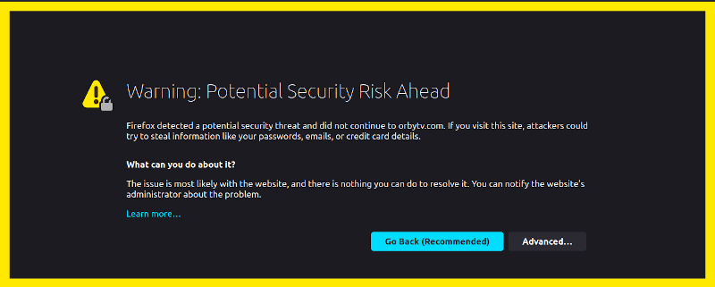

I never used the app to manage my account but I do still have the login page to their website bookmarked (Orby TV) which gives me this warning. :(

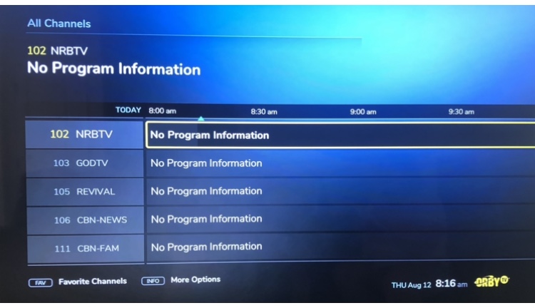

Too bad there isn't any guide info. Is anyone getting guide info for the OTA channels because I heard that it was delivered through satellite, which is probably fake as 2 transponders and guide info do not work LOL
There are EPG listings for all of my local ITC broadcast channels on my ORBY TV DVR satellite receiver. EPG data, which was previously sent from ORBY TV prior to 03/01/21, lasted for at least two weeks duration. Local EPG is much less duration now, though it is all present.
