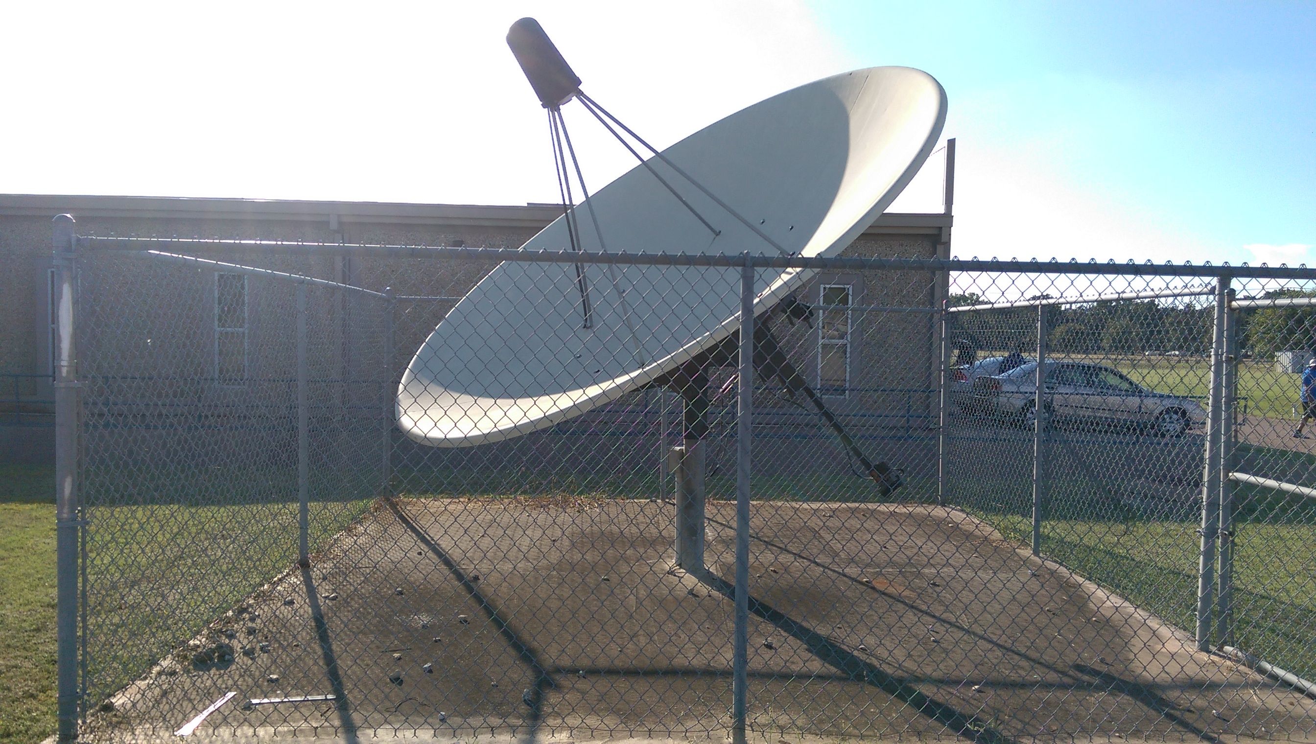

Ok, guys here is the dish I'm trying to get them to "donate" to me. Any one know what this mug is? All I know is I NEED IT!

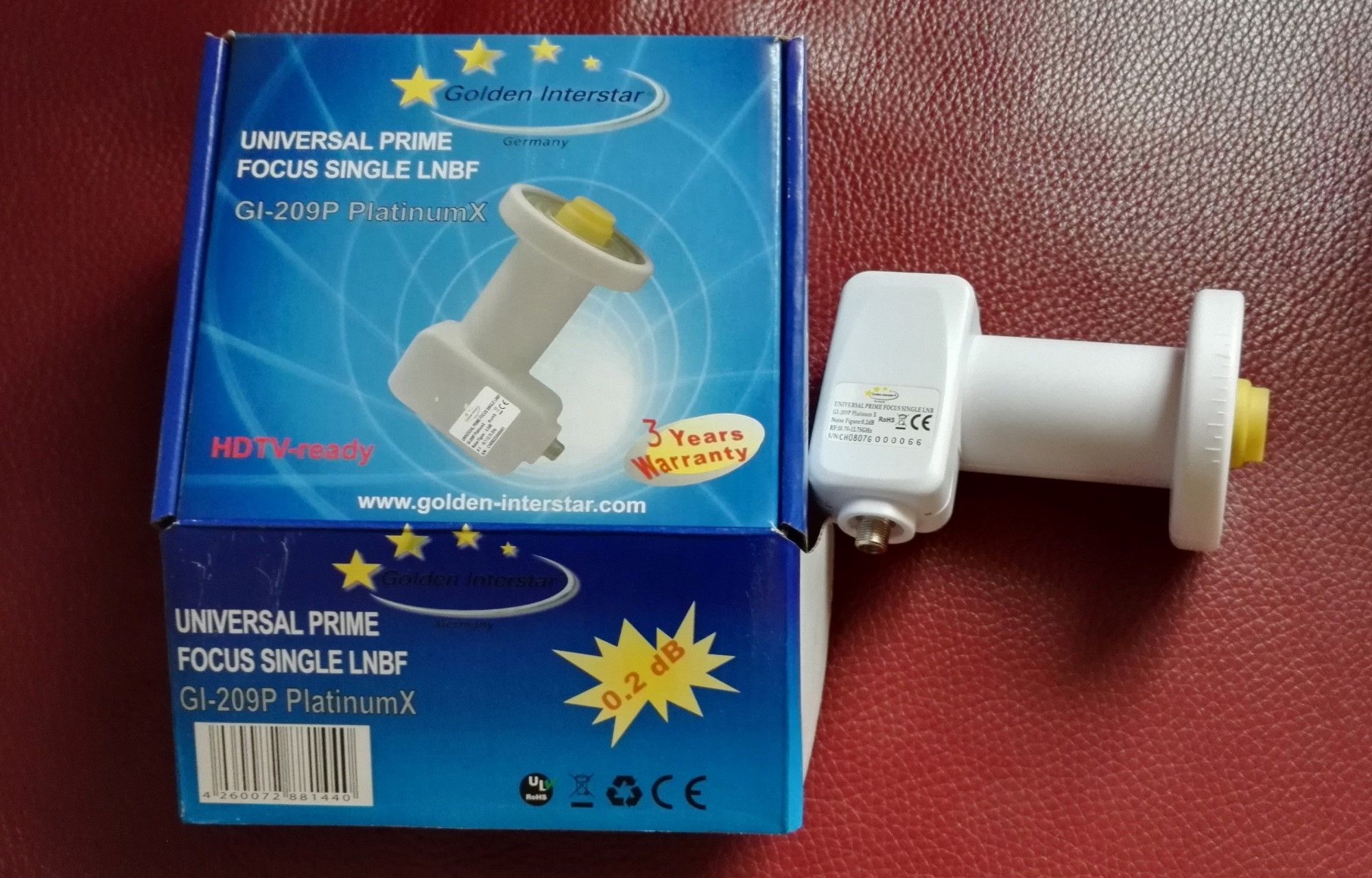

Is there are certain KU LNBF you prefer for a prime focus dish?
I like GI-209P, it has integrated feedhorn, not so expensive but performs just great. IMG_20160621_093313 (Custom).jpg
