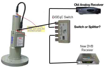

Okay so here is what I have:
>> New LNBF - BSC621-2 c/ku band - only one run of cable to house for both. Switch between c/ku on receiver??
>> FTA DVB receiver - Maybe Viewsat or Traxis FTA Satellite Receivers
>> Do I need a motor controller like Gbox v3000??
The switch is built-in.
The BSC621-2 is a Universal Ku, DiSEqC switch
The BSC621-2 is a Standard Ku, 22KHz switch
>> Okay so the BSC621-2
>> Then a good DVB FTA receiver. I found this one. It has blind search Coolsat 6000 PREMIUM FTA DVB Satellite Receiver 5000 CH - eBay (item 230229477639 end time Dec-30-08 16:49:36 PST)
>> And the Gbox to move the dish, and I should be all set correct?
Are there any DVB receivers with a built in Gbox? - Also, I could just use my old President receiver in place of a Gbox to move the dish couldn't I?
Yes. That's where I would start, slave an FTA receiver to your Analog Receiver.
Then add toys on as you go.
Cool. Will start here then.
Is it worth getting an HD FTA receiver? Are there many FTA HD channels? Or should I just start out with something like the Coolsat 6000? Thanks
Switches do not work that way. There is a Thread here somewhere with sample switch configs.
If you are not using a 4DTV, then the Analog does not even need to be connected to the BSC621, just not much analog left, it would just control the Dish and Polarity.
Okay, thank you. - I will just leave the actuator wiring hooked up to the Analog receiver and use it to move the dish.
Then I will just run the coax straight to the new FTA DVB receiver. Thanks
