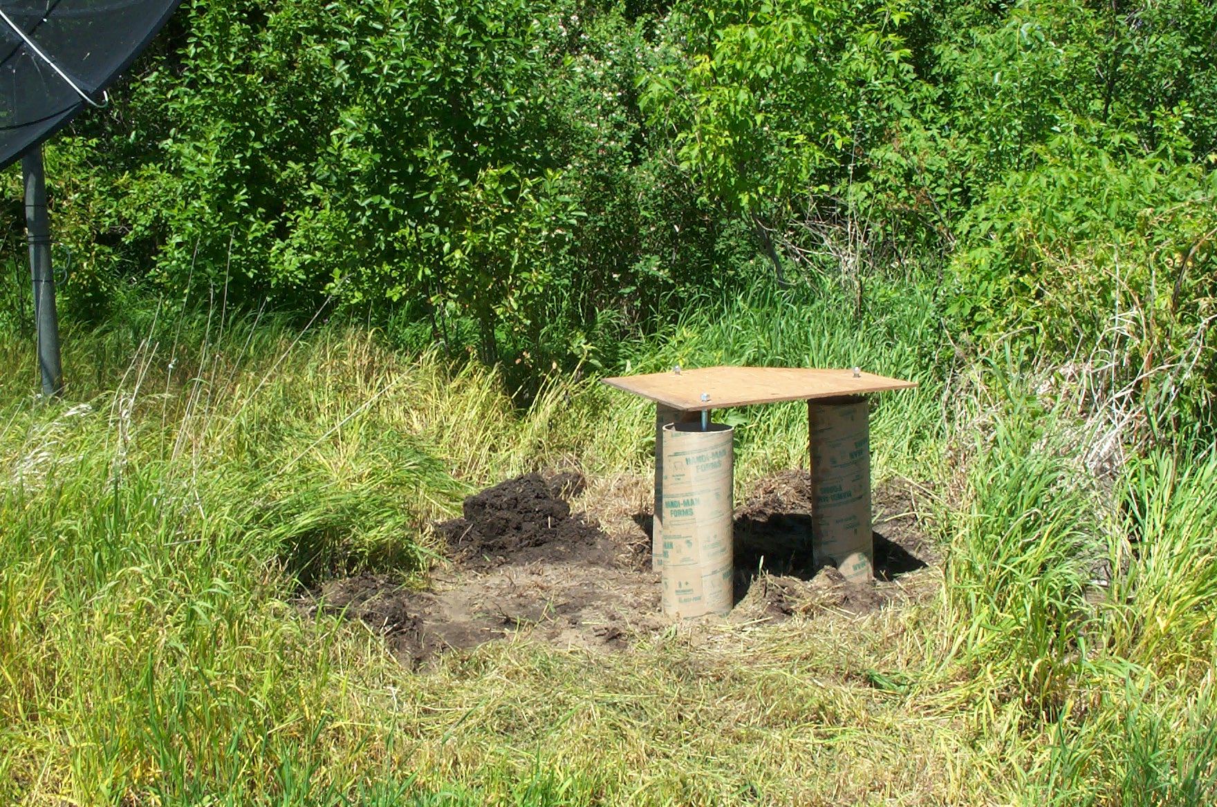

These went down 4' and still pulled out in a 50mph wind. Reset to 5' been holding Posts with jig.JPG
