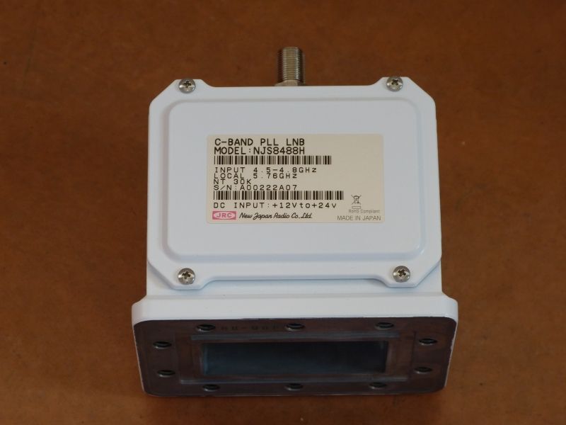

Hello members , is it possible to convert from a standard C-band lnb to the extended band (4.5-4.8 Ghz). Best regards
I don't think its possible unless you have some specific microwave test equipment, knowledge and skills to do the mod. It would require changing the LO frequency and retuning the front end filter. It would certainly cost more in labor than a new extended LNB would cost.
Which lnb should I think of buying one.
Live in Holland.
Best regards
Reactions: Brct203
Live in Holland.
Best regards
I have had a good experience with Swedish Microwave which should be easy to purchase in EU. Here is a link to their C-band LNBs.
