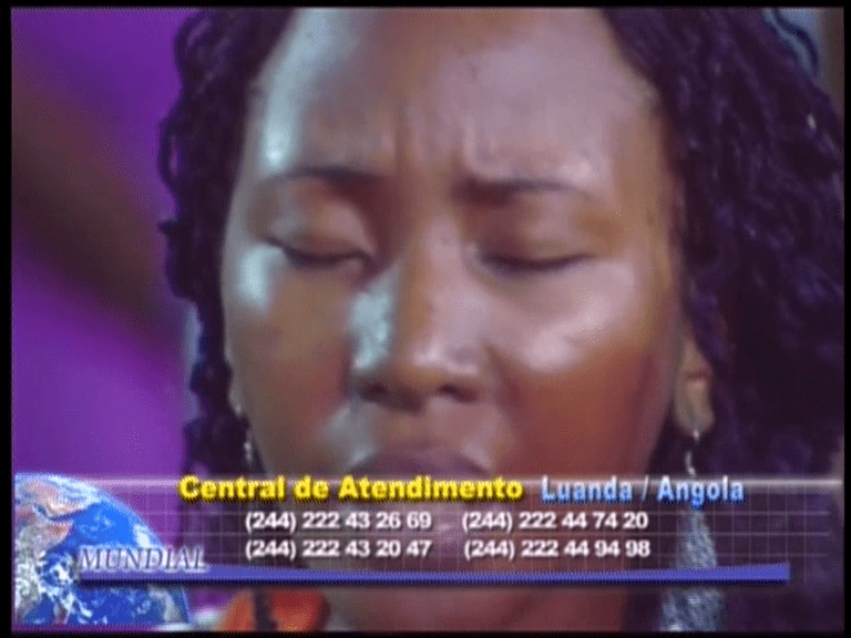

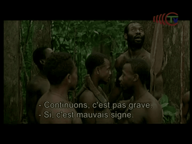

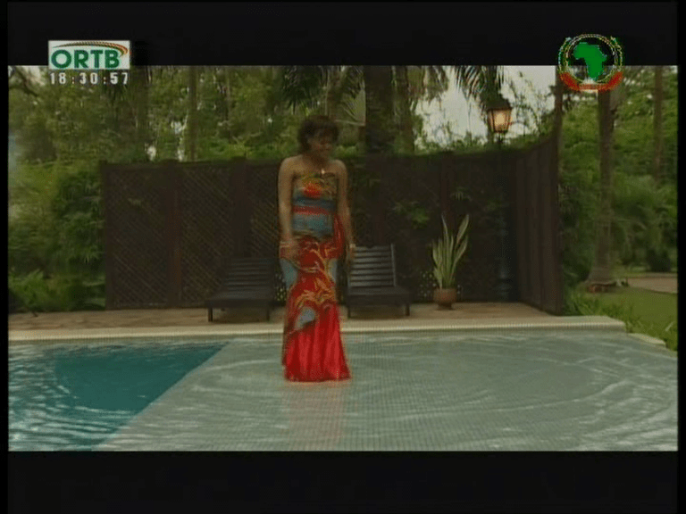

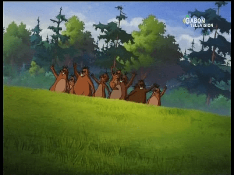

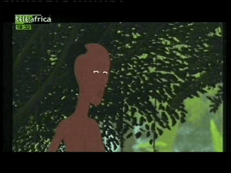

Few weeks ago I managed to get a 125cm Aluminium Gibertini Offset Dish (One of the best 1.2's you can buy here in Europe)
I decided I wanted to test C-Band here.
I bought a C-Band LNB and offset scalar the LNB is actually one of these 4DTV ones you guys use which are useless for KU here in Europe because none of the satellites with C-Band have KU in the range that LNB has.
Yesterday fitted the dish on KU and saw what kind of signals I could get on weaker ones here in Wales mainly 5E which has a beam over Nordic countries but has a big over spill and it boomed in.

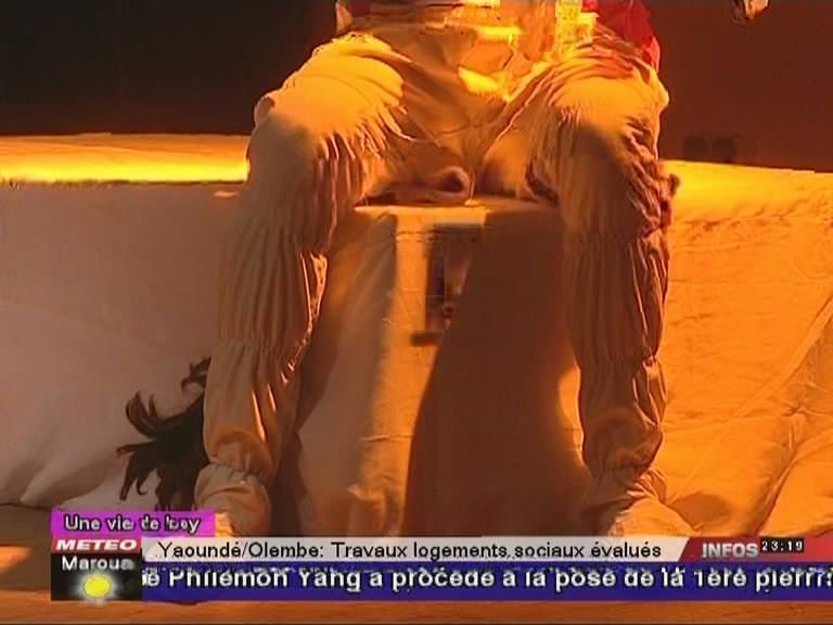

Today decided to move dish around to 5W and fit the C-Band LNB. Without being able to adjust scalar I picked up quiet a few transponders.
[TABLE="width: 500"]
[TR]
[TD]RTG 1 Gabon Television[/TD]
[TD]4159 1944 L (V)[/TD]
[/TR]
[TR]
[TD]ORTB Benin[/TD]
[TD]4154 2280 L[/TD]
[/TR]
[TR]
[TD]TELEAFRICA GABON[/TD]
[TD]4113 2143 L[/TD]
[/TR]
[TR]
[TD]Africa N° 1 Libreville (Radio Transponder)[/TD]
[TD]4163 1500 L[/TD]
[/TR]
[TR]
[TD]Rede Mundial International Brazil[/TD]
[TD]4111 2140 L[/TD]
[/TR]
[TR]
[TD]CRTV Cameron (Breaking Up)[/TD]
[TD]3711 2785 L[/TD]
[/TR]
[TR]
[TD]GRTS Gambia (Breaking Up)
Tele Congo[/TD]
[TD]4123 3572 L
3633 2018 R (H)
[/TD]
[/TR]
[/TABLE]
Think I'll try for 20E tomorrow or 3.1E depends.

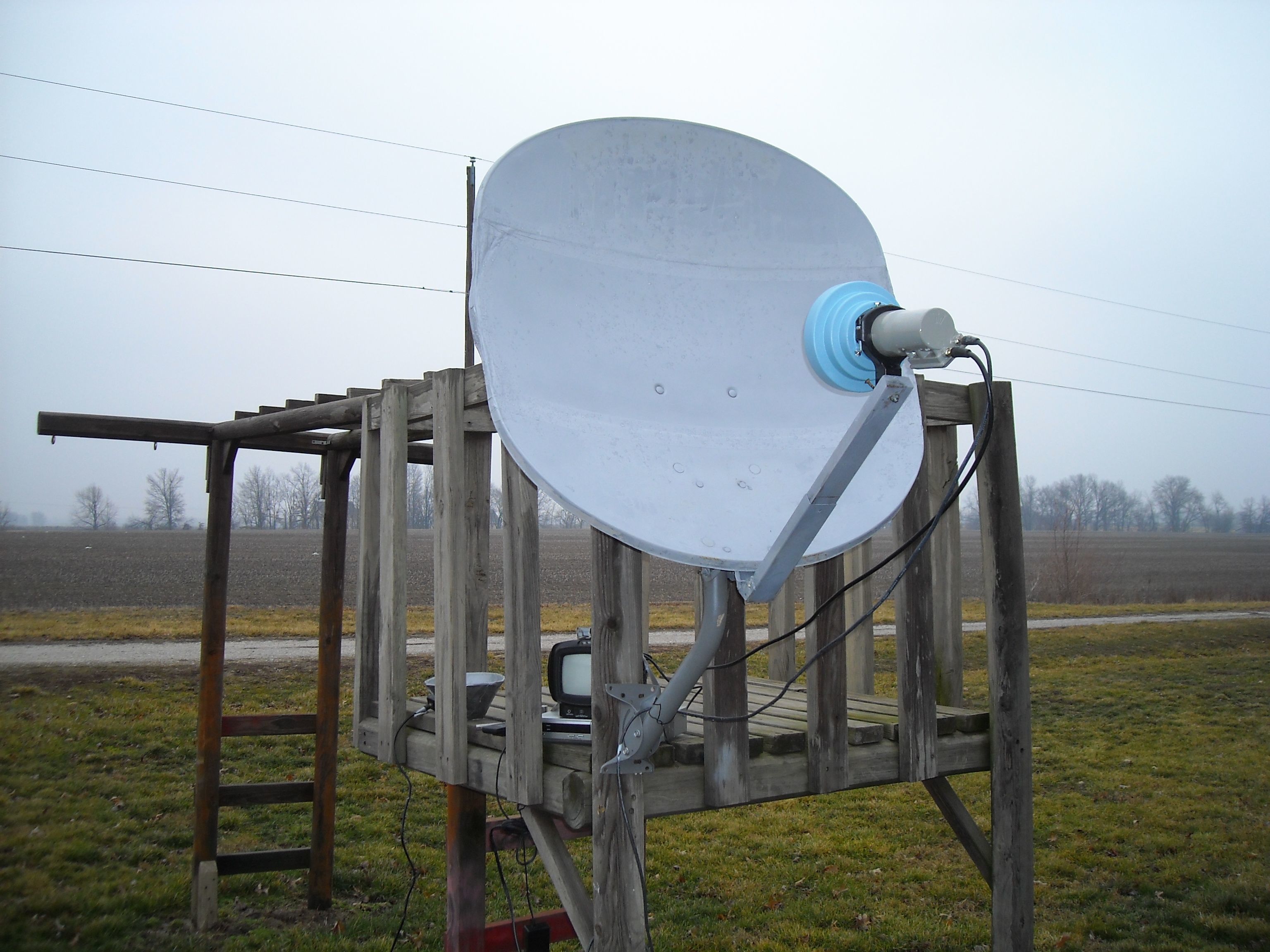

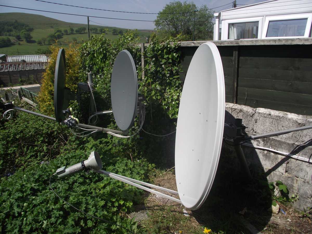

Great reception , especialy with out adjusting the scalar ring . I enjoy play with c band on a homemade 36'' dish here in the mid-west US , but just a few sat's to get decent results on (mainly 99w & 91w) . Conical scalar ring and lnb adjustment is the most critical &Picture 012.jpg hardest part for my set up . Thanks for sharing results & pictures . Hope to see future / better results for you !

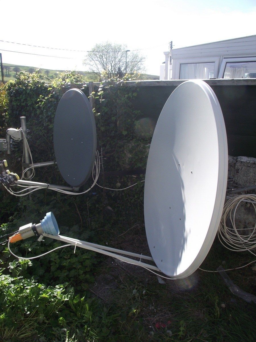

Today tried for 20E, using Viva Deutschland at 19.2E on the KU part of the LNB since that's in the correct range as a guide to where I was.
20E boomed in at 19.2E fine tuned it with DISEQC and got a lock on all the high SR transponders.
Tried for 2.8E the Congo-Kinshasa mux on 4052 R was showing signs of life but no lock.

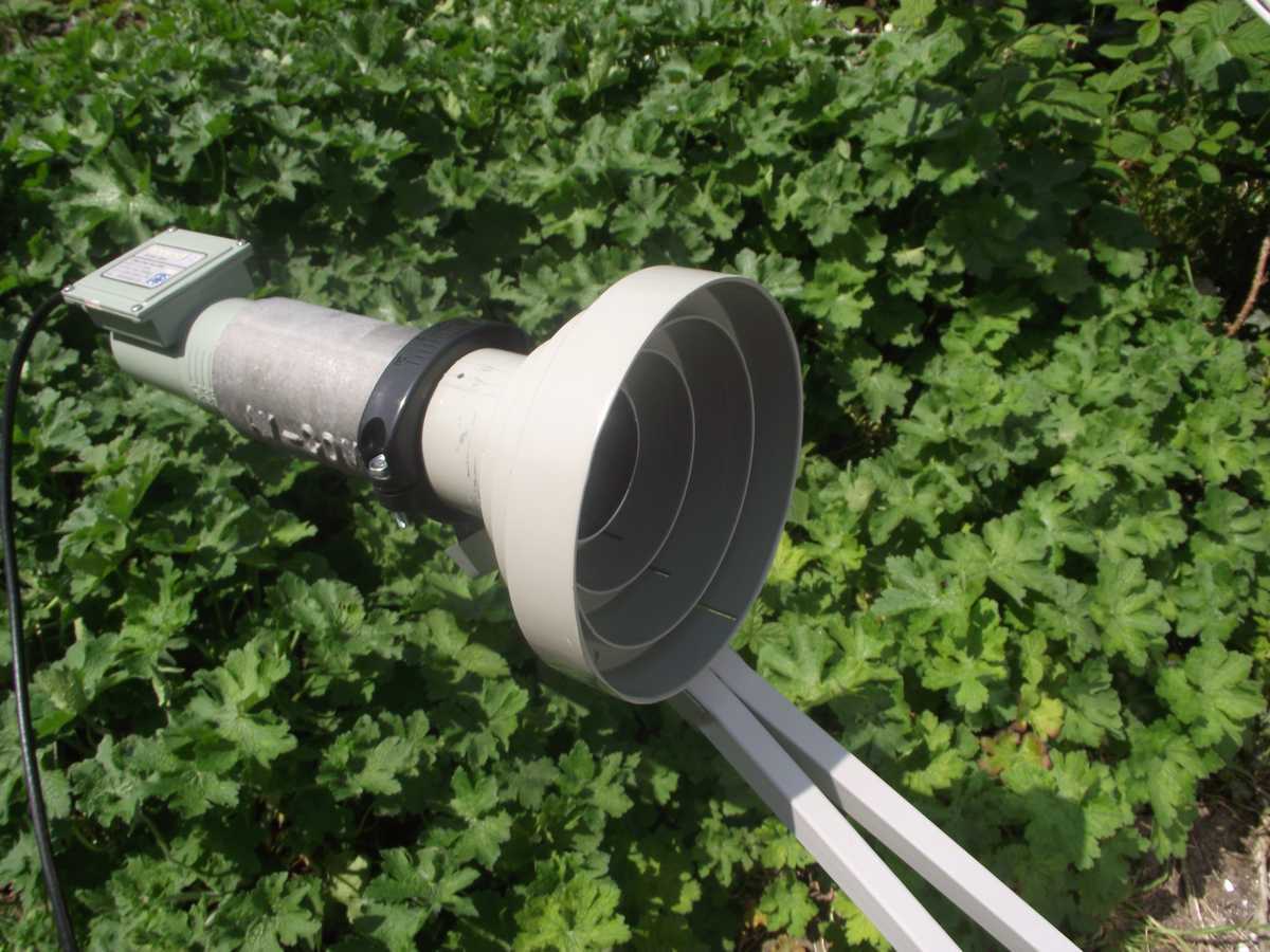

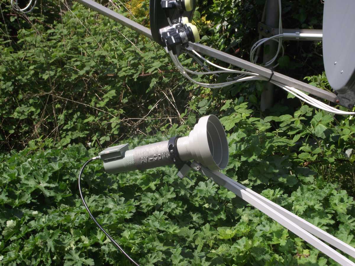

Here's photo's of my dish where you can see why I can't just the scalar and a video driving between 5w to 20e my flip cam is 30fps but TV is 25fps so there's bars.

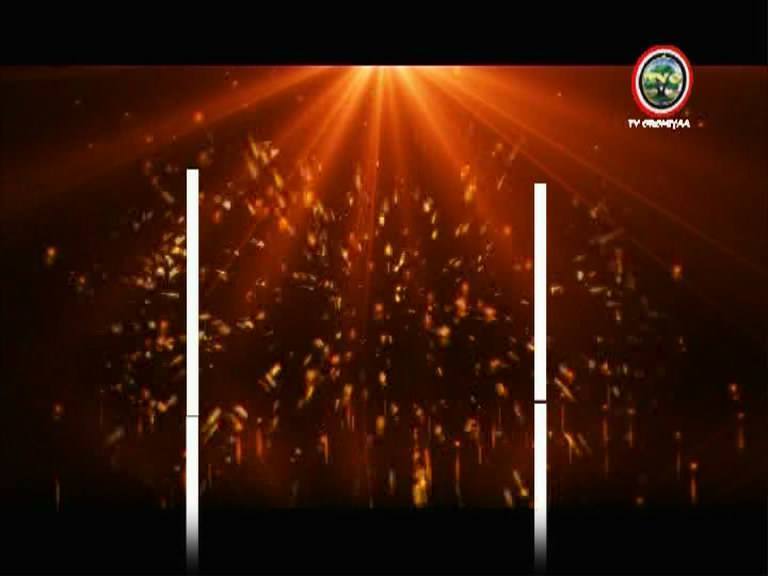

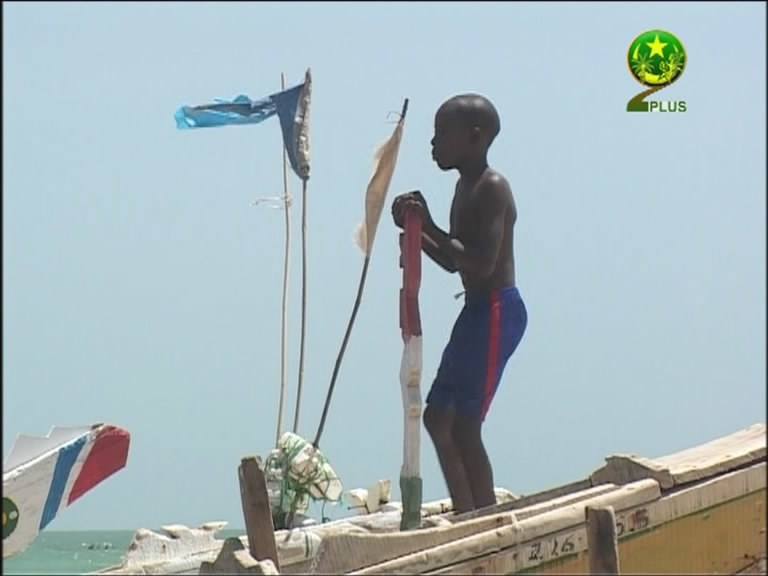

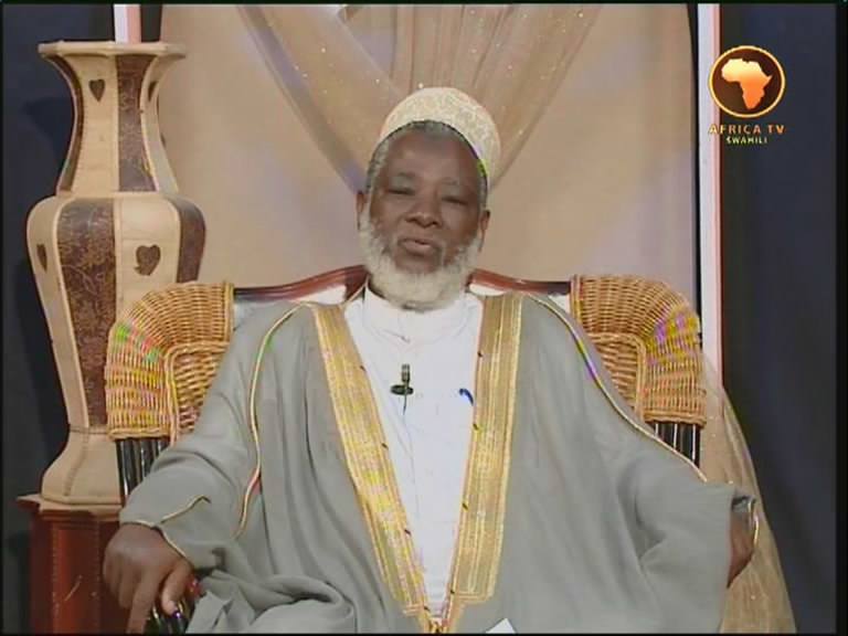

Here are my 20E loggings with screenshots of channels not seen by me before or not in KU skies here in Europe.
[TR]
[TD]TV de Mauritanie mini mux[/TD]
[TD]3911 R 8150[/TD]
[/TR]
[TR]
[TD]Arabsat mux[/TD]
[TD]3883 R 27500[/TD]
[/TR]
[TR]
[TD]TV Oromiyaa[/TD]
[TD]3706 R 2200[/TD]
[/TR]
[TR]
[TD]Qatari mux[/TD]
[TD]4052 L 27500[/TD]
[/TR]
[TR]
[TD]Arabsat/ASBU mux[/TD]
[TD]3932 L 27500[/TD]
[/TR]
[/TABLE]

I'd say you're getting very good results with the mini-BUD. Seems you have more 'hot' transponders than what we have here.
With that heavy dual band LNBF out there, did you do anything to prevent it from 'drooping'?
No just bolted it to the feed arms and my dad who's much better at metal work than me quickly made the collar mount out of some sheet steel.
He's working on making a better collar out of some exhaust clamps.

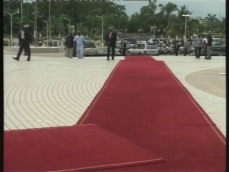

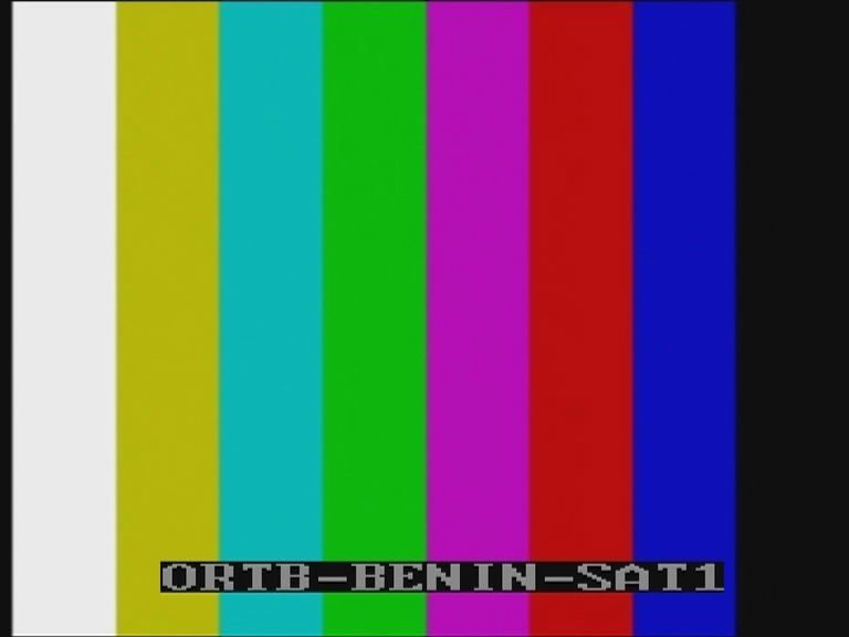

Okay this is incredible to me at-least I found my first feed from Benin of the African Union Meeting there on 5W 4156 L 1793 very strong signal.

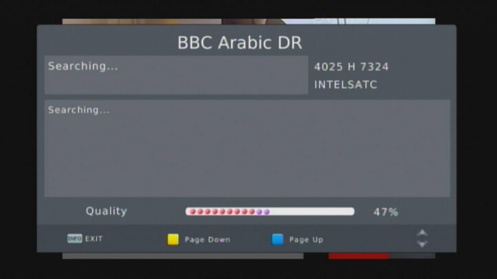

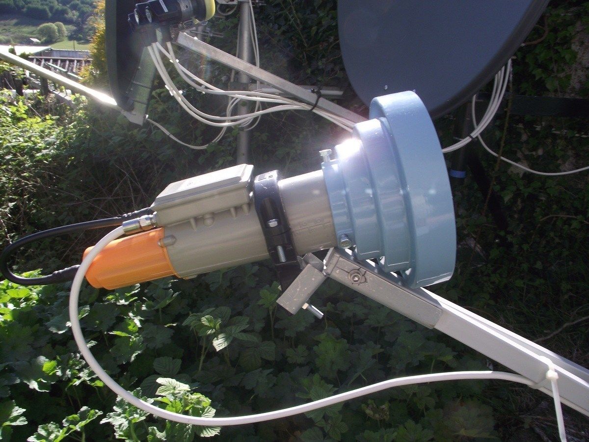

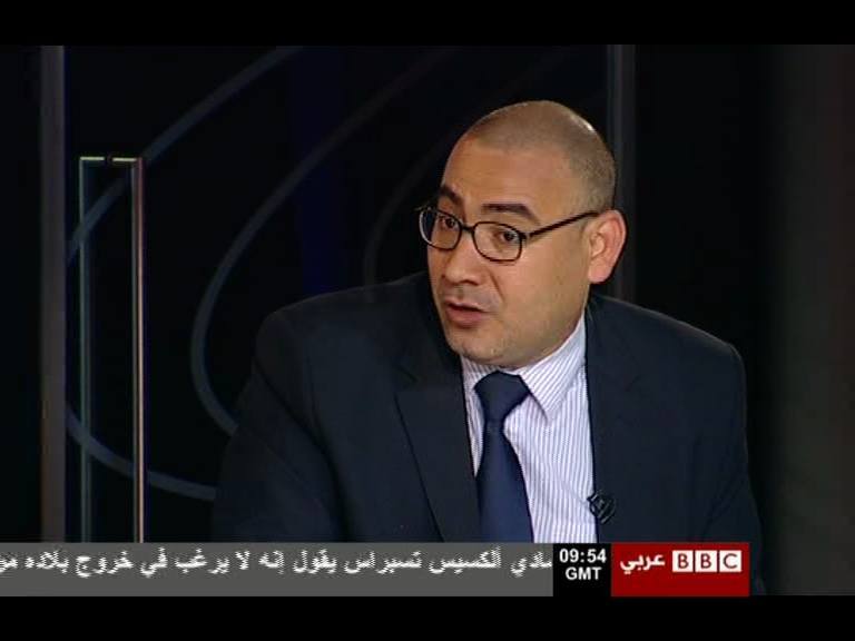

Found BBC Arabic on Intelsat 10-02 at 1W breaking up on 4025 R 7324 which I've been told is a great catch on a 1.2m here so I am proud of that.

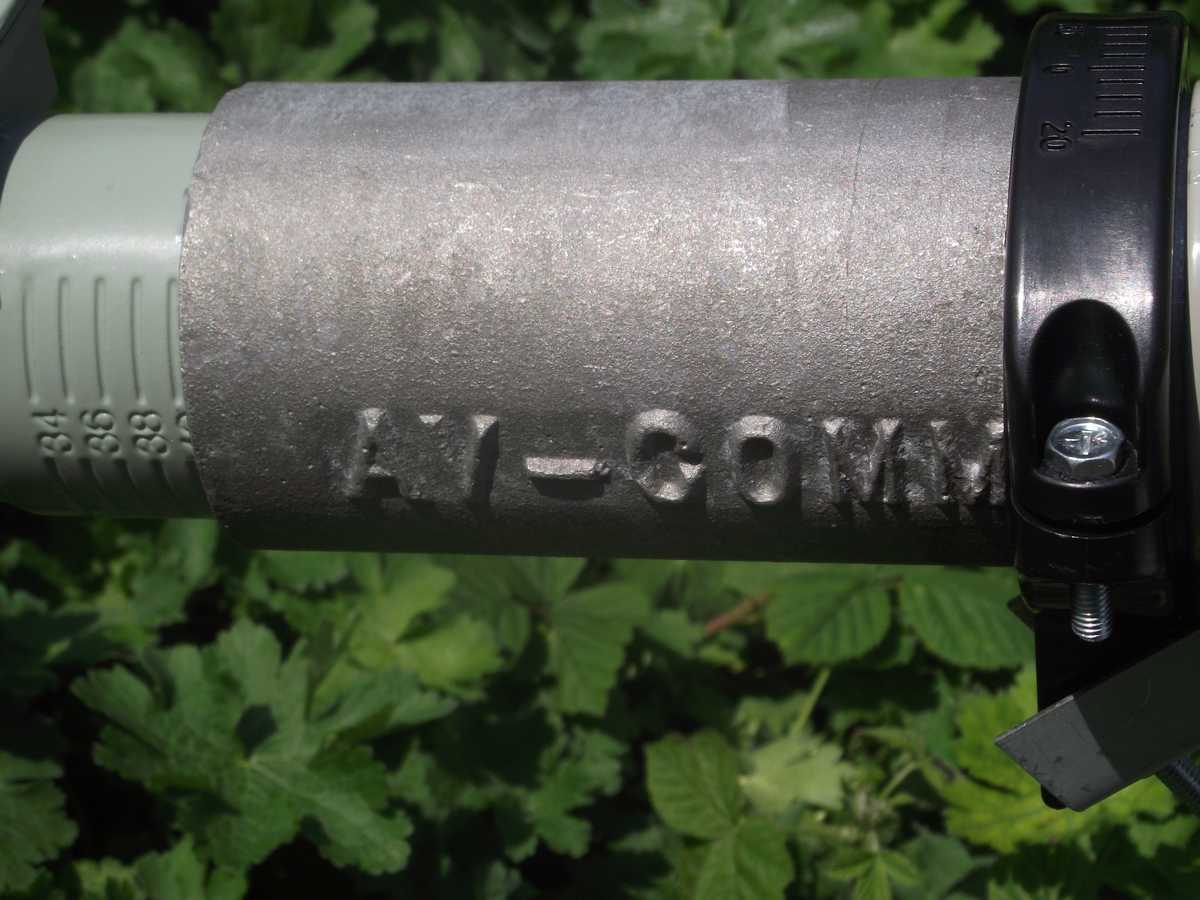

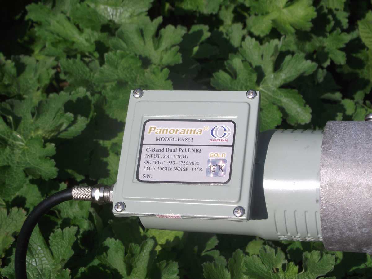

Probably going to replace the dielectric plate in the LNB soon.
Received my Panorama ER861 LNB, AV-Comm Waveguide Polariser and scalar ring yesterday.
Tried for BBC Arabic on Intelsat 10-02 at 1W this morning and instantly it brought it in with no break up, only the last 10 minutes has it started to break up and its better than it ever was on the older LNB with just a dielectric plate.
Signals increased across the board but no other channel locks yet, I don't think my motor is skewing the dish correctly so that's some thing to look at.

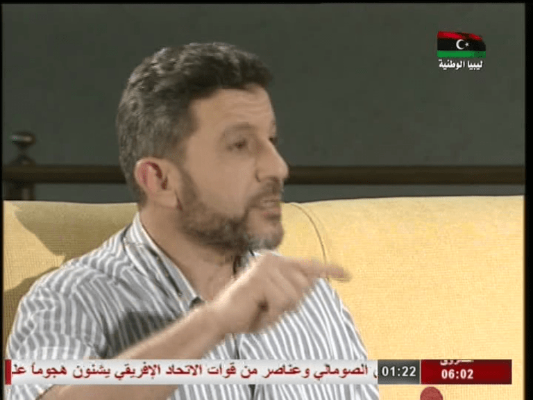

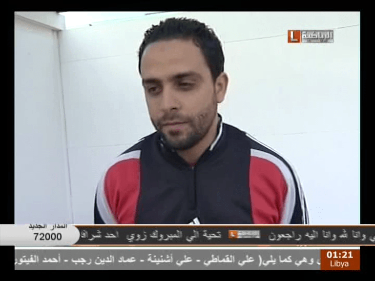

Eutelsat 3A at 3.3E found I think.
Libya Radio Television Mux on 3764 R and L 20330
Also Rascom at 2.8E is showing signs of life, blindscanning is finding a number of transponders including the Pan-African e-Network data transponder on 4023 R 10000
