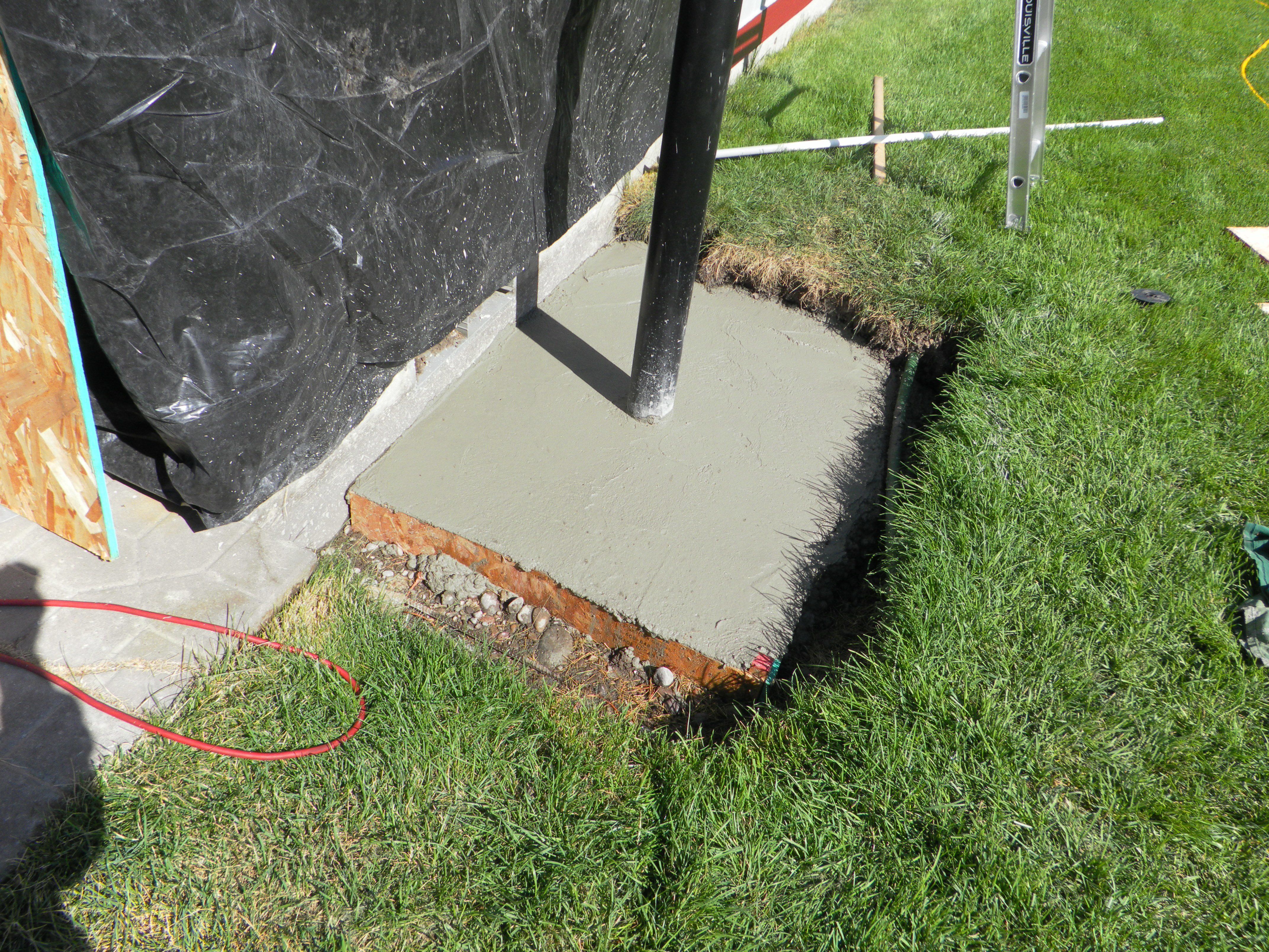

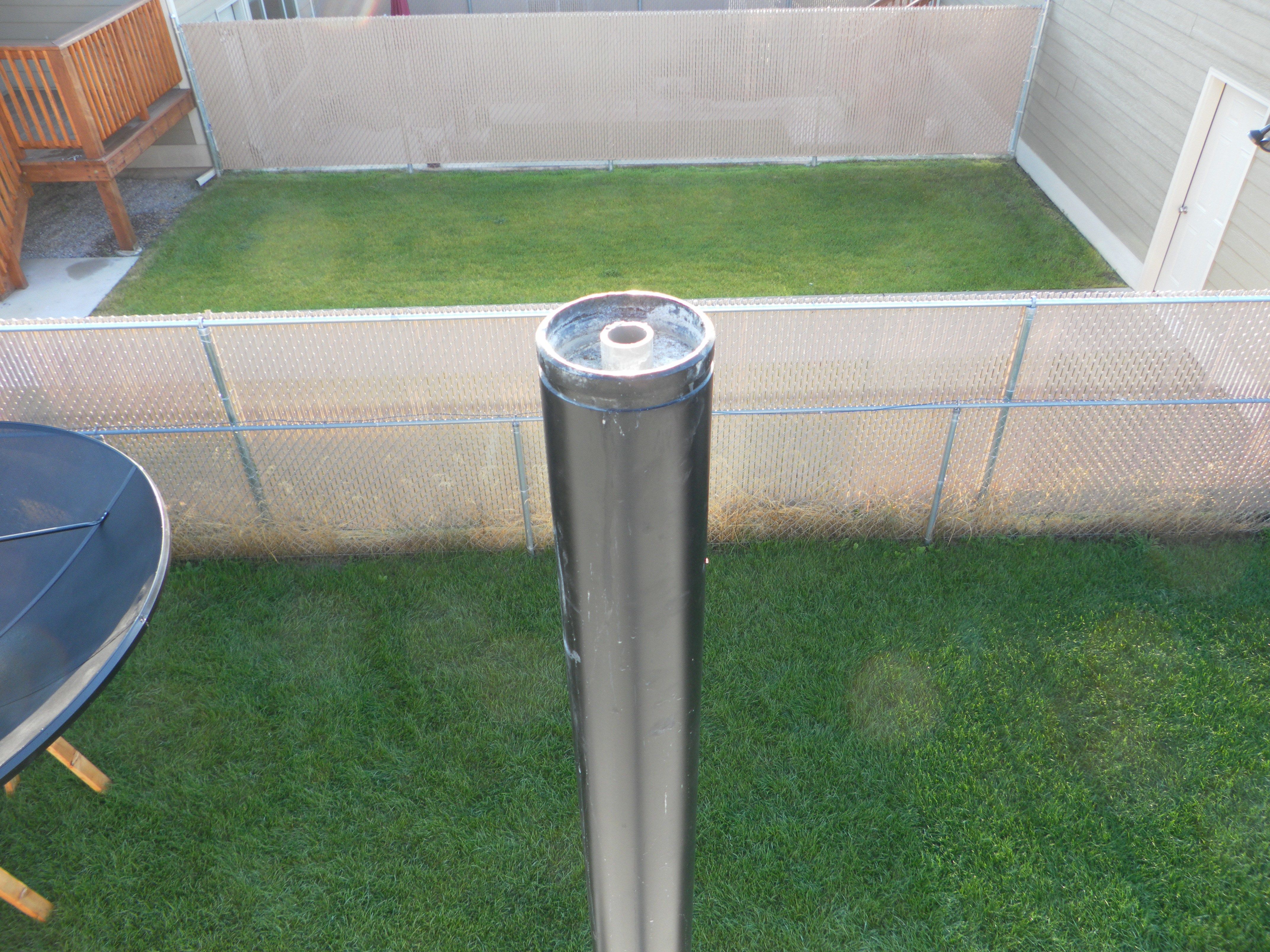

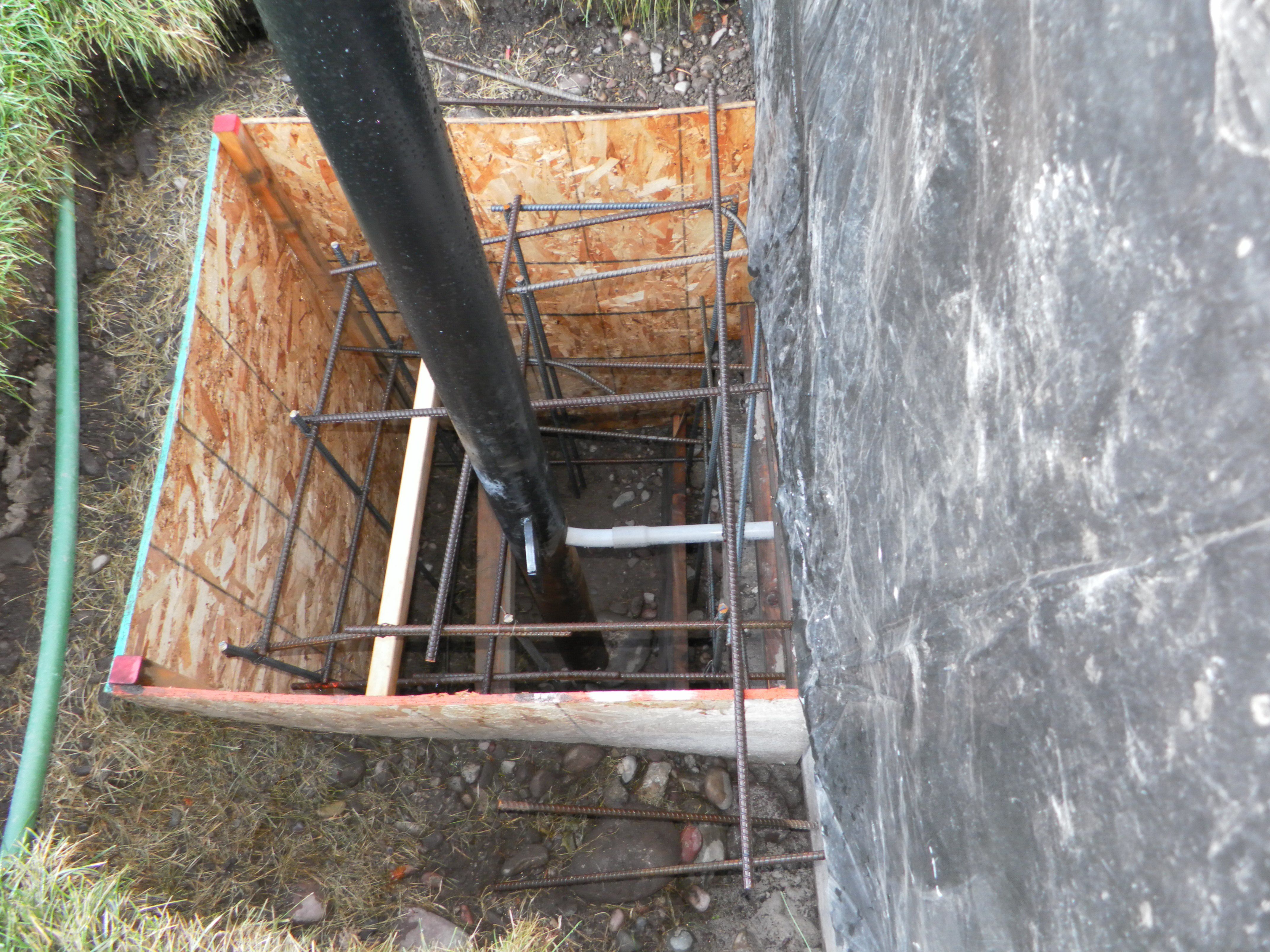

I just got a 10' Unimesh dish from an auction, when it was removed they cut the pole at ground level instead of digging it up. I got 24 extra inches welded on at work which makes the pole 6'. Is 2' in the ground with 60lbs of concrete enough?

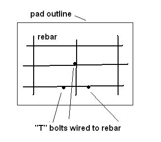

If your frost line is above 2 ft. I'd go the 2 ft deep x 1.5 ft at the pole, and extend the hole into a pad about 4 ft across with the depth tapered to around 6 inches at the perimeter. (reinforced with rebar)
Also weld some rebar( or scrap rod or tubing) to the pole at the bottom to resist twisting.
