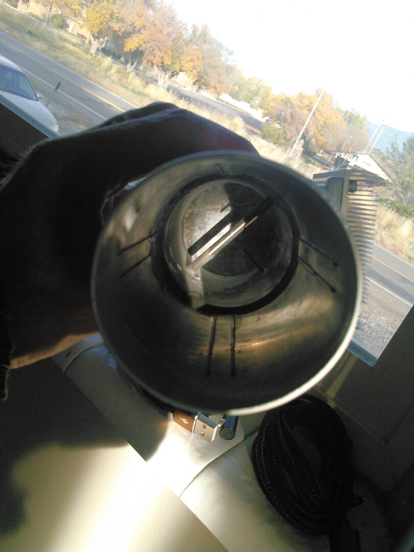

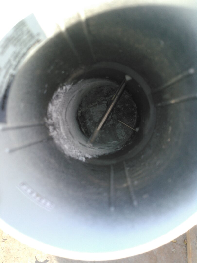

I think I found my C-band problem, we've been getting lotsa rain lately (and some snow). I pulled the LNBF and took off the cover and found calcium deposits inside. Can I use CLR to clean it out?
You can tell by the cover it appears to be a engineering issue as there are holes thru out the cover and of course the water drains down and collects in it.
How does the water travel "DOWN" and get collected there? Is this on an off-set small dish, where the lnbf is inverted?
If so, leave the holes alone in the lnb cover, drill a small weep hole though the waveguide of the lnbf, down on the "bottom" close to where the antenna probes are. On the side where water will run out towards the ground when it's aimed correctly. Of course, do NOT hit the antenna probes with the drill when you do this! A small weep hole there shouldn't cause any signal issues.
It's best to try to scrape out the calcium deposits manually, perhaps with a long sharp wooden or plastic stick (softer than the metal) so as not to damage the metal. VERY carefully! You don't have to get 100% of it removed, just do the best you can and see how it goes.
Yea it is on a GeoSatPro Offset 120cm. I get alot of westerly winds, so the precipitation is "blowing" directly/indirectly into scaler/LNBF.
I was able to blind scan SES3 today and it picked-up the transponders but no signal/lock on any of them. That when I noticed the deposits.
So 1/8" hole will work?

Wow! errr....aluminum oxide maybe? Either way, scrape it carefully and Lime Away or phosphoric acid (metal roof cleaner) with neoprene gloves and eye protection. Or as cheap as they are bite the bullet.

The vertical probe is probably shorted to the feedhorn. Once the deposit is scraped away, the LNBF may function again.
It is likely that standing water in the feed may have entered the electronics cavity and permanently damaged components.
In this non-standard install, Primestar31 provided good advice on keeping the feedhorn free of standing water. In addition, many offset dish mini BUD projects also use a plastic lid (margarine tub) on the conical scalar to keep water off of the feedhorn cap.
Yea, combination of H20 and voltage....that what it looks like.
