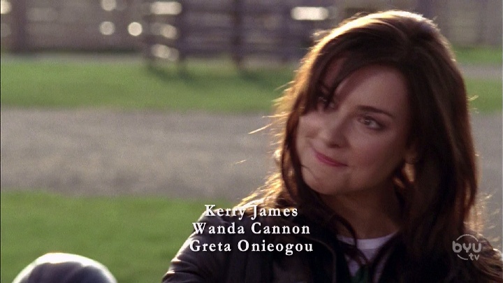

7.5' SAMI dish on 91w right now.
3925 V
DVB-S2
8PSK
4250-1/2
Thanks for checking, Mike. I guess my dish must have somehow gotten out of alignment, or I'm having a problem with the electronics or cable or something. :(
