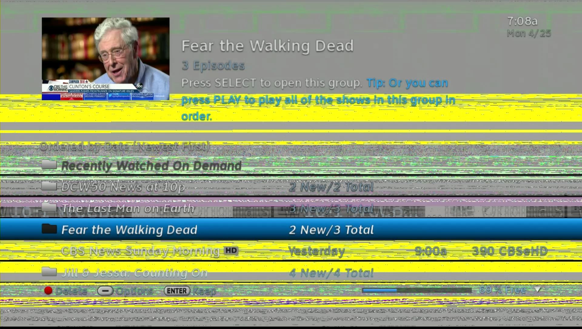

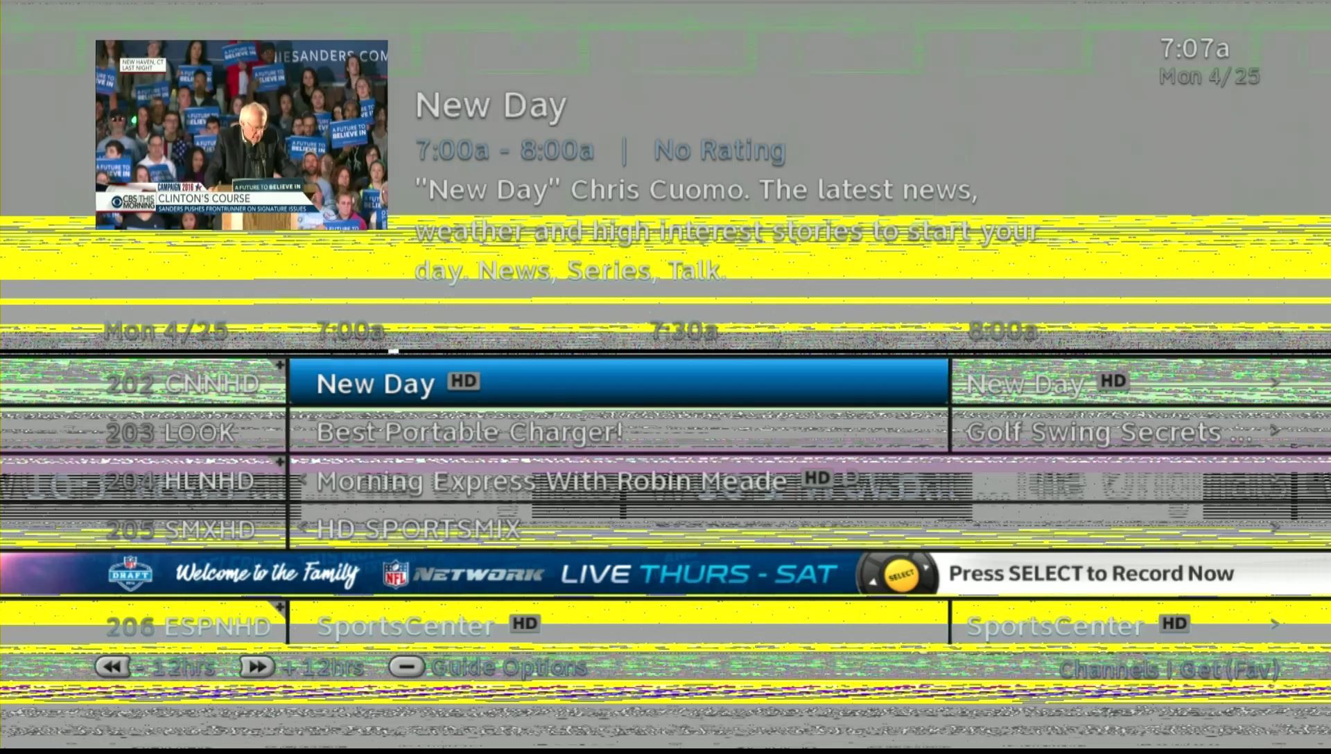

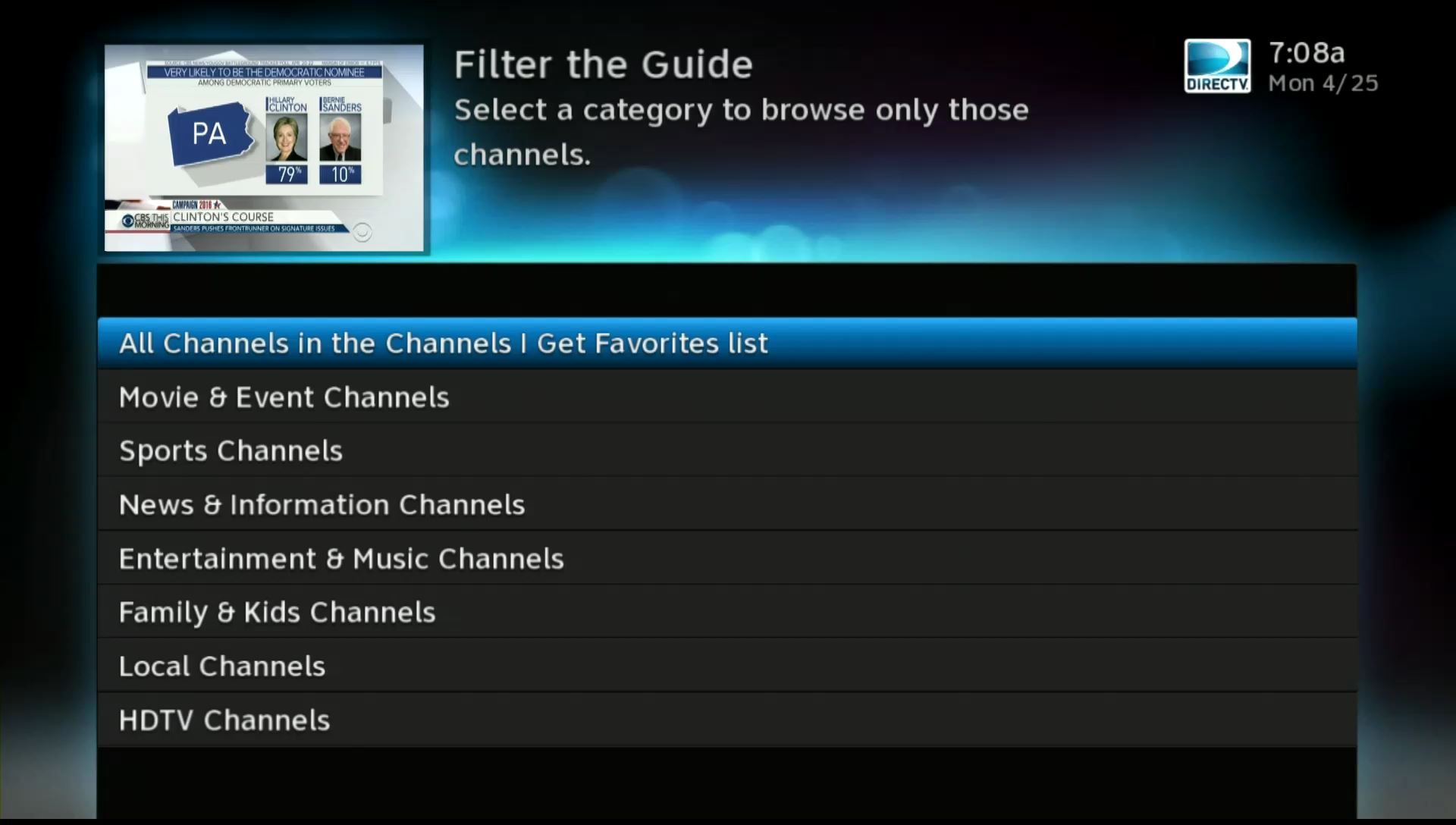

The C31 hasn't froze since it came back up, but the Guide & DVR playlist are all distorted (only on the C31, they are fine on the HR34). I've reset both the HR34 and C31 multiple times, and this problem still is there. Other screens are fine... if I hit guide twice to bring up the sort screen it looks normal, and if I choose a program in the DVR list and hit Info the info screen is normal. See the attached screen captures below. (These are direct captures... my C31 is hooked up via HDMI, but I hooked up my Hauppauge Capture device to the Component side and took these screenshots so I know it isn't a cable issue because it looks the same on both outputs)

While the distortion screen is on, have you tried disconnecting and reconnecting the HDMI cable? That might eliminate an HDMI handshake issue.
Yes, the issue exhibits itself via HDMI and over Component. Plus the other screens are normal- just the guide data and DVR list screens.
After another 5-6 resets I finally got it back to normal!
