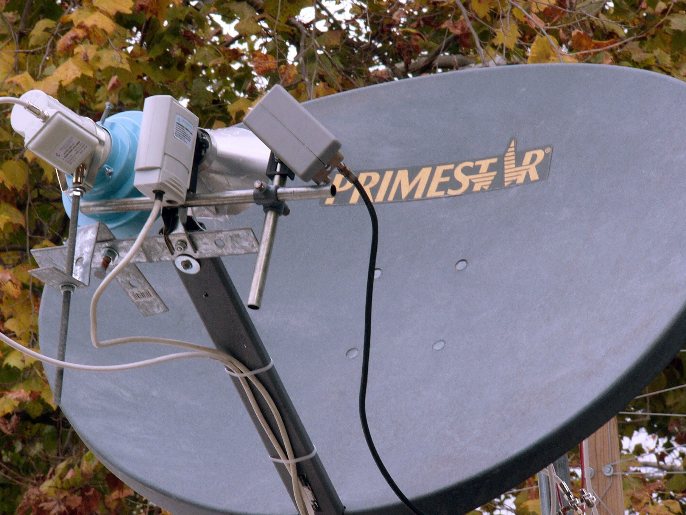

I get about 14 useable channels and a lot of christian channels with my primestar 84e c-band! That ain't bad for the cost of a bsc421 and a conical scaler (total $50)
a round dish will probably do better!

On a 90 cm offset I get 58W NHK
G3C horse and dog races
G16 Carib. stations, Afternoon westerns on LeSea
STO and the Sportsmans channel.
Coolsat6000P
14 channels.....What exactly are you looking at? By that I mean, what stations?
The LNB and the scaler that you mention...will that work with a Coolsat?
I get:
3 CWs on 91ºw
5 global digital media feeds on (daytime talk show feeds) 99ºw
5 major affiliates from the virgin islands,ABC, NBC,CBS,CW, etc, 99ºw
1 This channel L.A. 99ºw
1 Saskatchewan Communications Network (like PBS) 111ºw
I'm limited between 89º and 111º with my C-band 10º off center.
others come and go because of weak pick up.

The scaler will put you about 8º off center, if I remember correctly. I put mine 10º off and do well enough between 89ºw and 111ºw. Things go to hell quickly after that. I found it best to keep the standard LNB centered (instead of bsc421) if you hope to have RTN on 83ºw ku.

To receive a satellite signal on an offset LNBF, you will need to calculate how many degrees off of center the 2nd LNBF is located, then drive the motor to that position.
To simplify operation, you could edit all of your C-band satellites to reflect the corrected offset. For example: if the dish must be pointed to 90W to receive G19 located at 97W, set and save the G19 C-band satellite position to 90W in your receiver. When G-19 C-band is chosen, the receiver will drive the dish to the corrected position to receive the satellite from the offset LNBF.

I'm sure there's a mathematical way to calculate, but I just used DiSEqC to find the offset LNB's. In my case 10º worked out well so that 91ºw/C is located in the same position as 101ºw/Ku, etc.
Once you figure the offset, you can set up 'dummy' C sats (example: 101ºw_ 91 CBand Galaxy 17) and use USALS.
If it was 8º the 'dummy would be ( 99ºw_ 91 CBand Galaxy 17)
Of course it depends on what side center you are on.

I tape a protractor to the center of the dish and use a string to show me what offset I have. You'll want to aim the side mounted lnbf at the center of the dish and measure out to see that you are at the same focal distance to start. Fine tune and your watching some C band.
