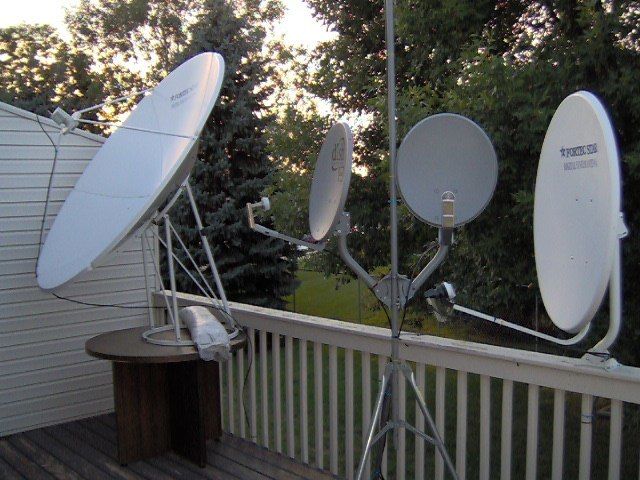

Setup is
Dish500 with "I" adapter for 110 only
Dish300 for 61.5 (I could do 148 but I wanted the HD Demo channel)
LNB for 119 on my G10 FTA dish. Little inginuity and a piece of metal :)

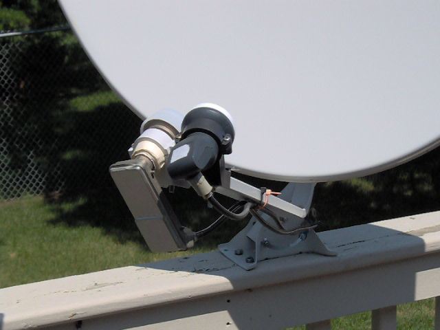

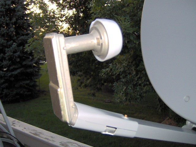

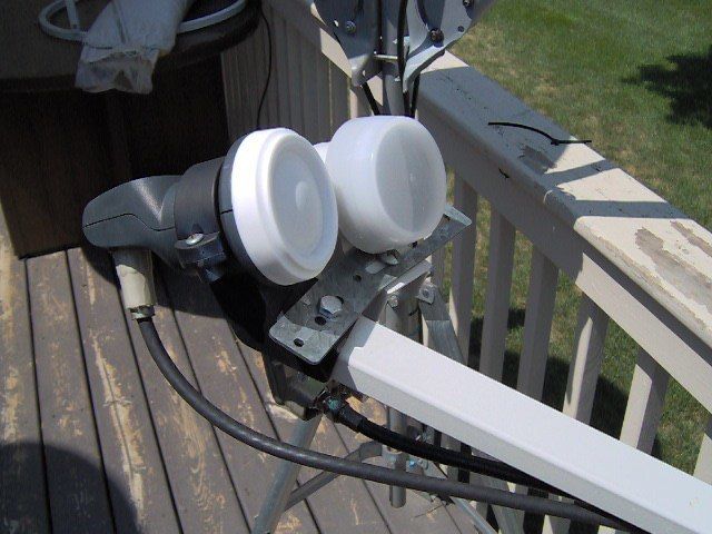

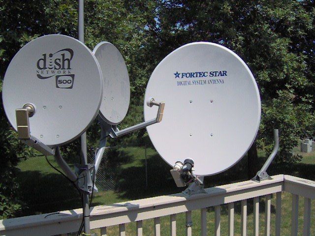

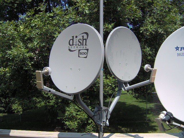

1st picture is the 100 & 61.5 dishes. These are bolted to the mast of my TV antenna
2nd picture is the Galaxy 10 setup with the 2nd LNB for 119
3rd is the whole setup
4th is a closeup of the 123/119 double LNB (one on right is 119)

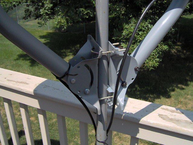

5th is closeup of the 2 masts bolted to the mast of the TV antenna
6th is the 3 dishes plus my 6 foot C-band dish (that is on a table 30" high so I can clear the roof)
7th is a closeup of a "gutted" stacked LNB (thats how I got the LNB's..notice the "pregnant" part..thats how you know its a stacked LNB

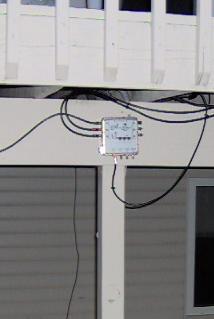

8th is my switch under the deck covered from the elements :)
