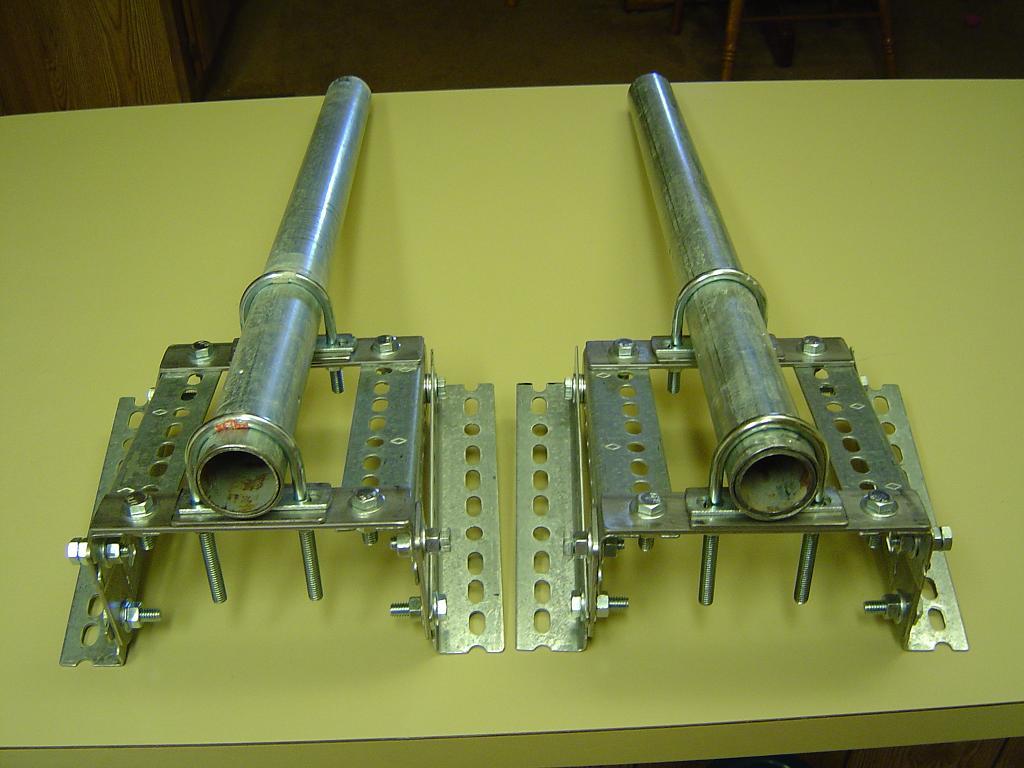

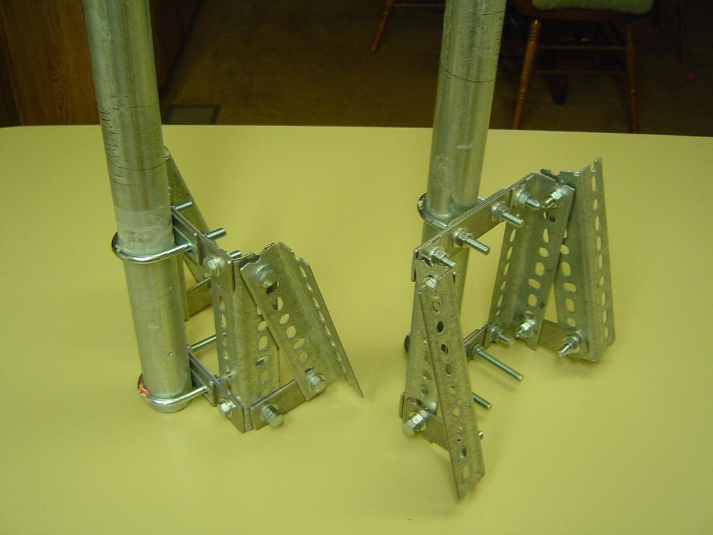

I recently mounted two 36" dishes for my friend and I didn't want to poke the roof so I made up mounts to bolt on the face of the eave facia board. The facia boards were slanted about 20 degrees so I made them to compensate. here's a pic. They are rock solid too.
One thing I did was add a short piece of pipe inside the lower section of the mast so that the U-bolts wouldn't crush it.

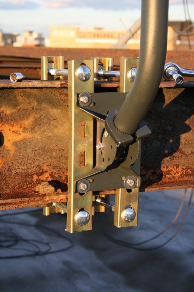

Great minds... ;) Looks vaguely familiar... very much like the rig my friend in Brooklyn thought up for the install I was involved in. The picture shows an early stage; later on (after I stripped out the bolts in the pole :rolleyes:), we used U-bolts and a 2 3/8" fence post mounted to the frame, very similar to yours!

Tron - I remember your posts 'n pix from when you first got back.
I love the contrast between the new shiny hardware, and the old rusty I beam.
Very creative, too :cool:

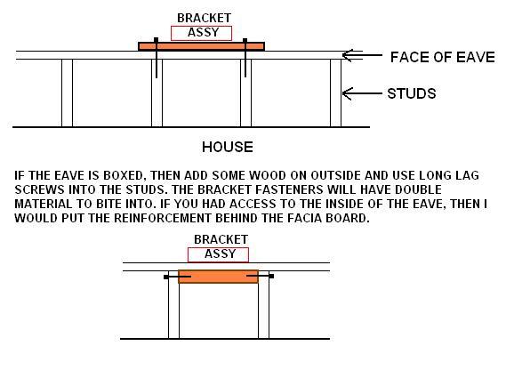

McGuyver - Quite imaginative with that bracketry. I may have to revisit my boxed-in-eaves, with that sort of idea in mind. Mine are 1x6's, though. Works better on a buddy's house where they are 2x6's.:cool:
In that case you would add some wood reinforcement between the face of the eave and the brackets, a simple drawing will explain better. You could also add wood inside the boxed eave if you have access, there's a number of ways to solve issues, use your imagination.
I used this method once on a friend's mobile home trailer that had sheet metal skin on outside leaving nothing but the wall studs for support, so I put two lengths of 2x4 horizontally, one above the other, on outside of wall with lag screws, then mounted the dish mount on the 2x4's, it was solid when done.
