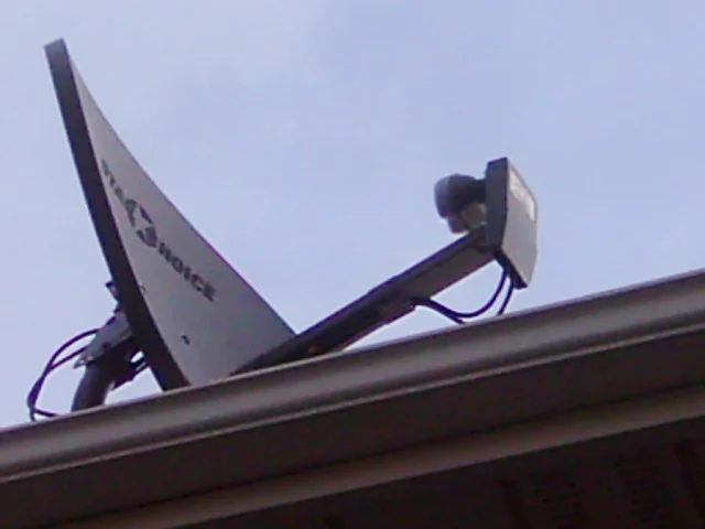

hi, i have this Starchoice dish on my roof which was left by old tenant. I am new to FTA world, can anyone guide me if i can use this dish to Get Fta channels and am willing to buy new reciver for it PLease guide me.If i can,t use this dish than please tell me which dish i should buy. i have attached the picture of the dish too .i,ll be very thankfull for help.

Sure will Star Choice use linear LNB's Of course you will need a new receiver!

The dish you have looks to have 2 LNB's so you would be stuck with just one (or two) satellites. You may be able to use a motor then you will be able to get all the satellites from your area. (pending line of sight to the satellites of course)
The hardest part is setting up the dish/motor. If you are really thinking about FTA you may be as well getting a full size dish and quality low noise LNBF. You need at least a 30" dish. Bigger dish collect more signal and will help if it starts to rain.
