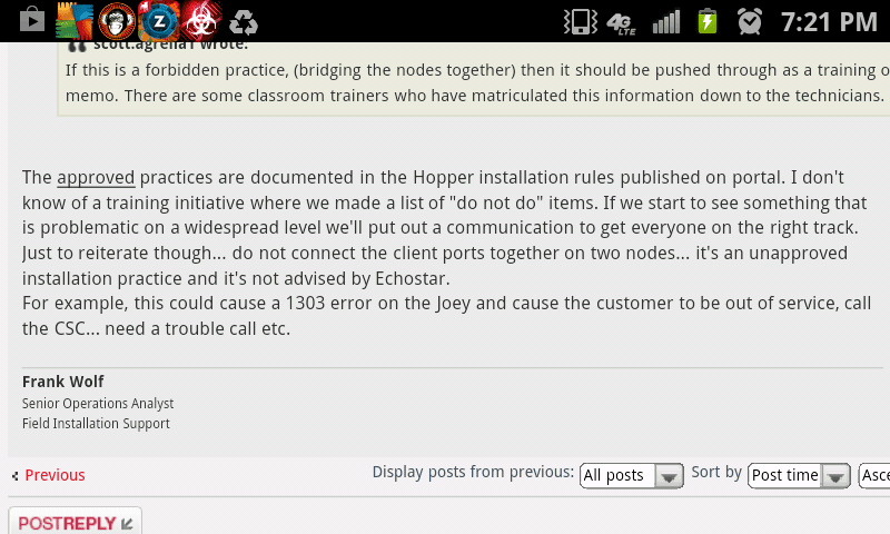

You may want to check dns forums about 3+ hopper installs as far as node bridging is concerned. We do it as well but it is an officially unsupported method and it has been clearly stated NOT to do so.
Screen shot of Frank's quote....
Even though it has been known to work.

You aren't the only in house on.this forum....
And your wrong about being told to do it, unless your local management is clueless.
See my screen shot.
See my screen shot.
