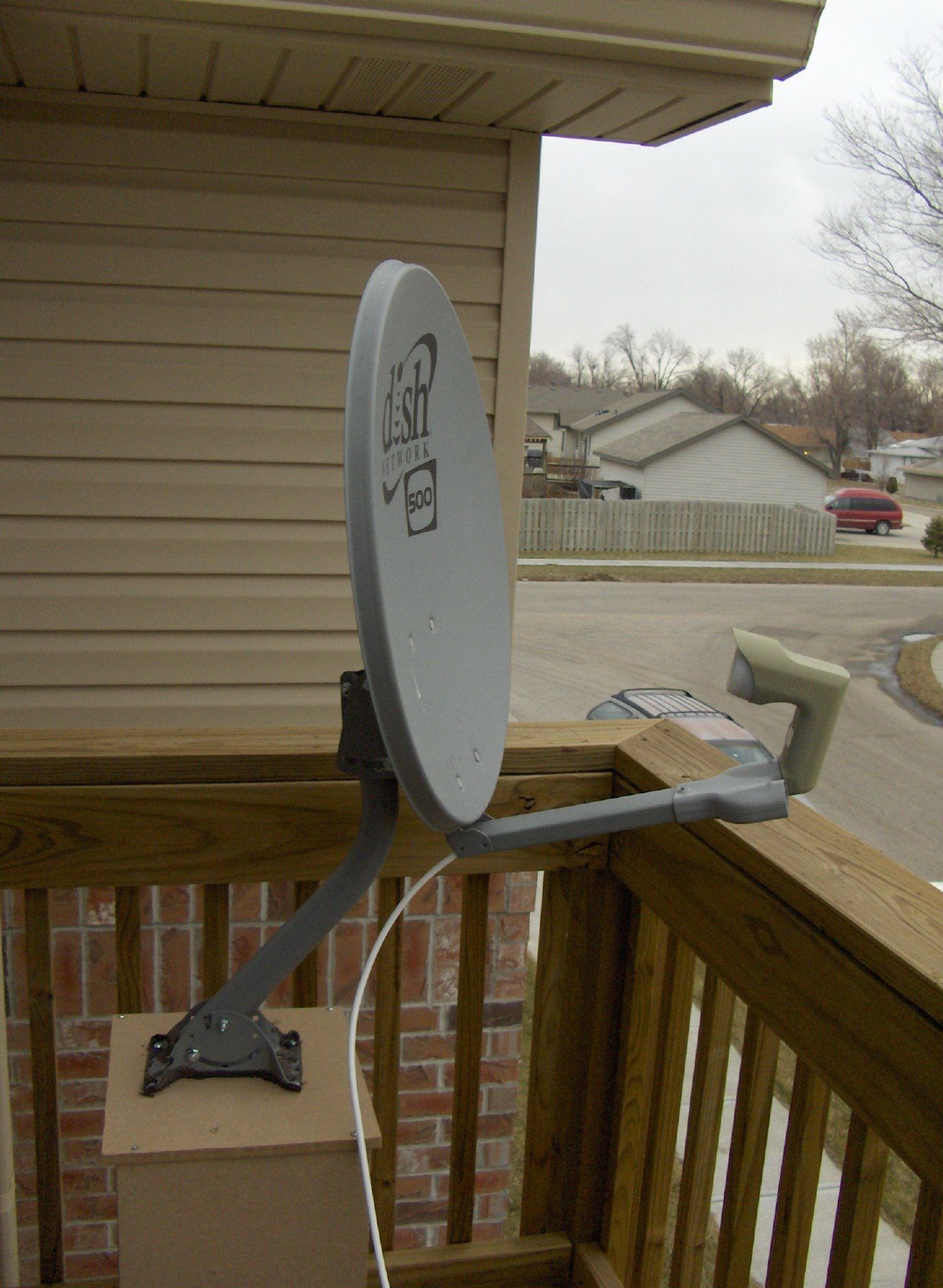

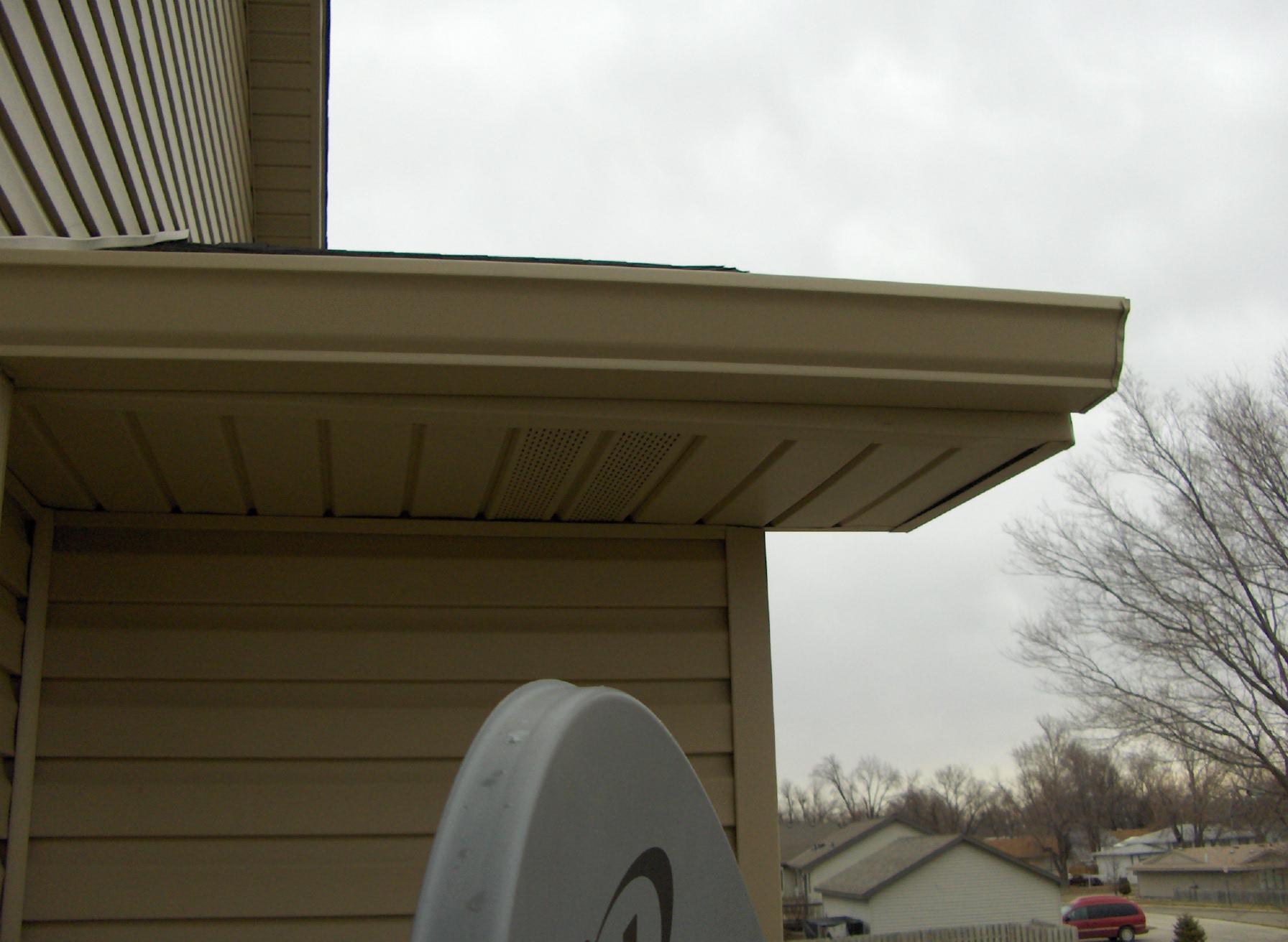

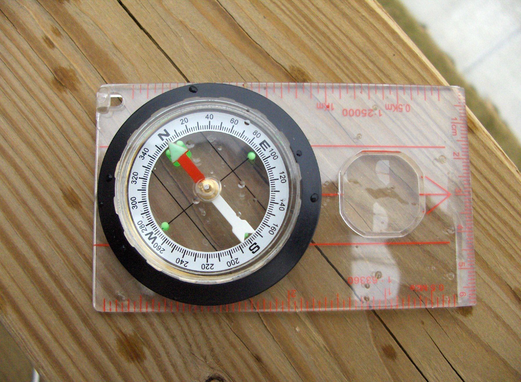

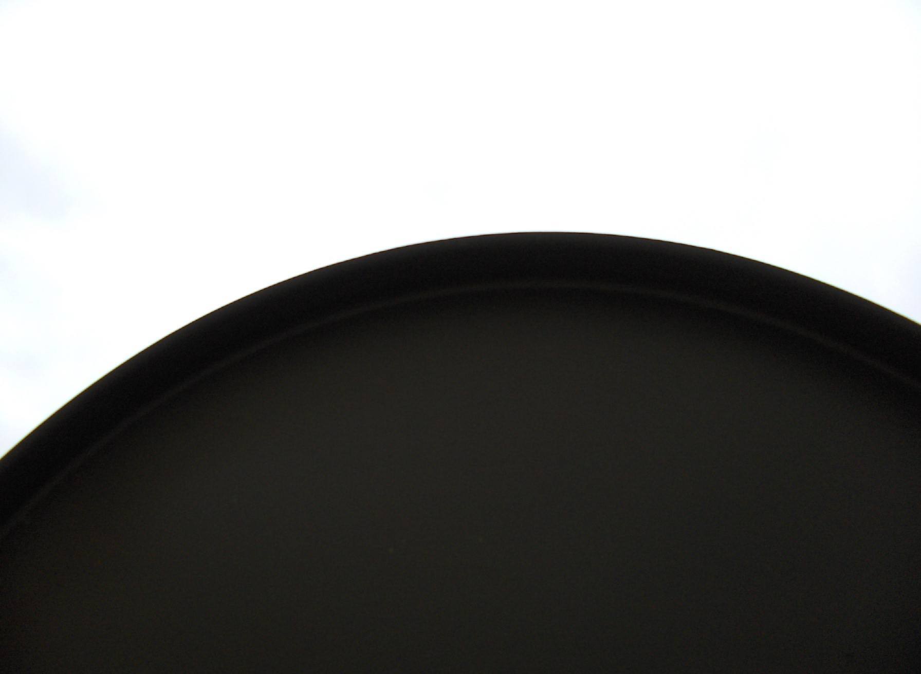

Here are the new pictures. I tried again today to get the signal but nothing... I am still trying at 31 degrees for the elevation with the new setting. By the way, there i nothing above me, sorry if the old pictures did not show that well...

If you have run check switch and you have xx xx on the result screen then its cleared. As I thought your balcony does face due east as well, somewhere in the forum is a thread or 3 that has a link to a website that has an elevation calculator. You can also contact dish to get the elevation for the 61.5 sat also, Im wondering though if the mount that your dish assembly is on may not be level itsself and throwing off your elevation on the dish. The compas does show that you have a good idea as to what to do to aim your dish so I think your fine there, if the pedestal is level and your aimed properly and your at the right elevation then I think your looking at an equipment issue. If your using the flat white ribbon cable that some apartment complexes require that may also be the cause of your no signal issue, that stuff is junk.
Le fou, what programming are you trying to get??? Depending on how far away that extension on the building is it may be in the way for LOS on the 119/110 As far as 61.5 They did move alot of international channels from the 61.5 to the 105. I'm in Bellevue-pm me and maybe I can stop by. Depending on what apartment complex you are at, I would guess you have the cable ran thru the patio door and are pinching the cable. As far as azimuth... go back to the menu and select Dish 300 and then put your zip code in. Azimuth and elevation for zip code 68107 are 128 & 31

"Depending on how far away that extension on the building is it may be in the way for LOS on the 119/110" What does LOS mean?

HOWEVER, when using a Dish 500 with standard Y-adapter, your azimuth is going to be 4.5 degrees off! :yikes You're using the 119 hole, so SUBTRACT the 4.5 from the reported number. Also, I think it's already been mentioned, but make sure you set skew to 90.
Looking again at your pic, I still see no reason why you couldn't spin that dish about 50 degrees clockwise, and up around 10 degrees (check both with your point dish screen) and grab 110/119. Of course, you'd need to switch LNBs to get both.
P.S. LOS = Line Of Sight (in this thread anyway - it can also mean Loss Of Signal).
He is getting 61.5 satellite, his problem is 110/119, but if your dish setting showed at the picture is for 110/119, then I think you has the problem >> elevation and there is a single lnb thats for one satellite. So, I believed the dish at the picture is for 61.5 satellite and it looks like a legacy lnb. You better show us the other dish setting for 110/119 which the dish elevation setting is much higher then the dish showed at the picture. And it should using the twin lnbs if that go to a switch 21. And the twin dish must be skew setting with correct elevation.
