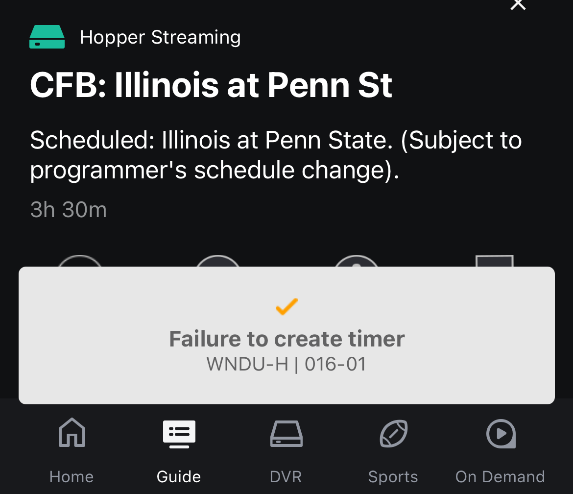

This is what I get when I try recording OTA on my phone on my Home LAN:
If I select a satellite channel then there's no problem creating the timer.
