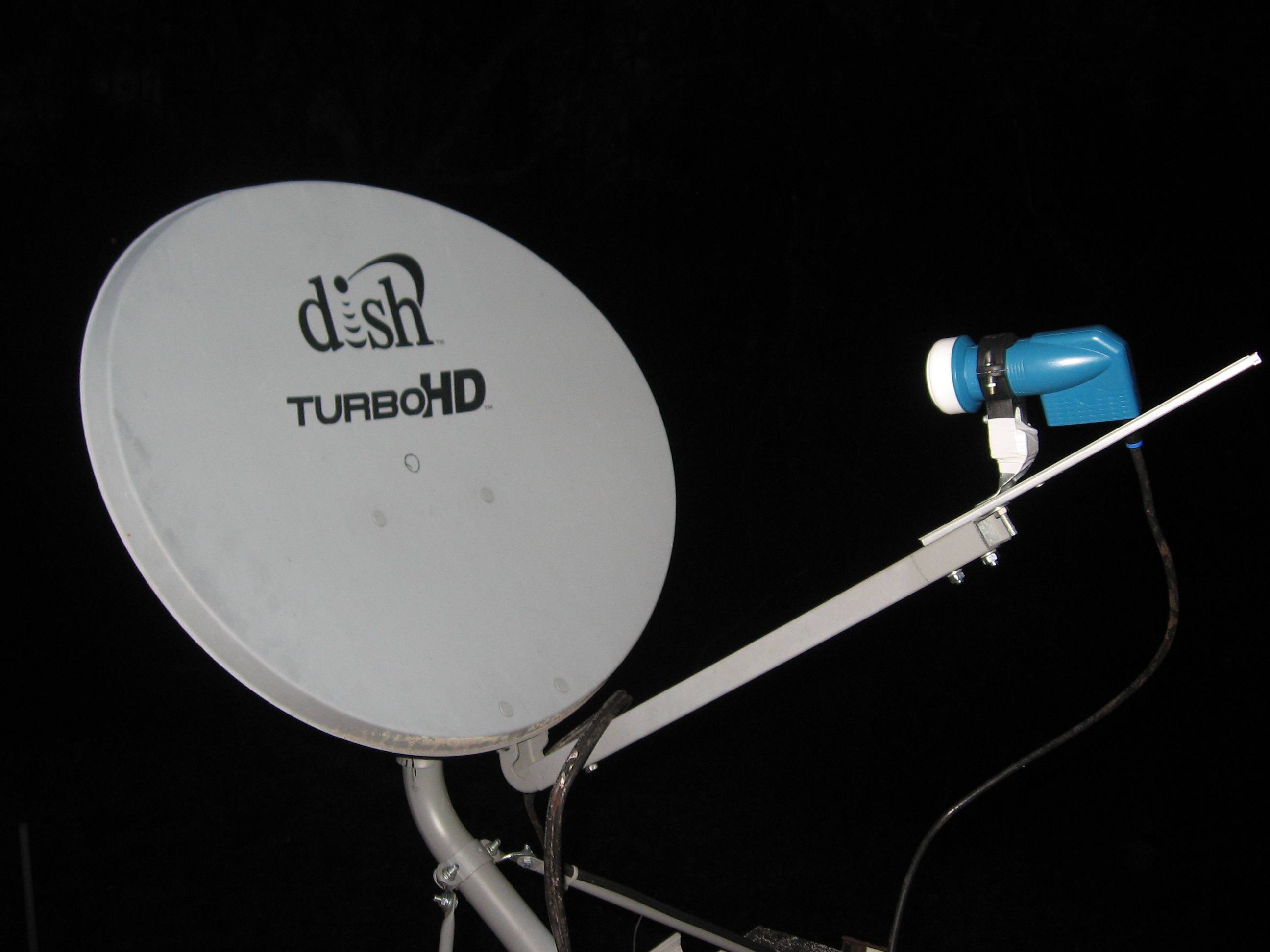

I used the same dish and the WSI ESX dual output LNBF on a stationary setup for about a year to get 97W, but I extended the arm and moved the LNBF about 1 inch out which helped.
I had a very good signal.
Now I have a 36'' dish on the motor, but I am still using the WSI LNBF
I'll have to try moving it out that much. I moved it back and forth in the lnb holder I attached to the arm but I'll try extending it out more.
I have zero skew on my dish and the lnb is skewed for 125w.
I experimented with skewing just the dish and then the dish and lnb slightly etc.... but the best signal, which is pretty much the only signal, is with the dish horizontal and the lnb skewed.
