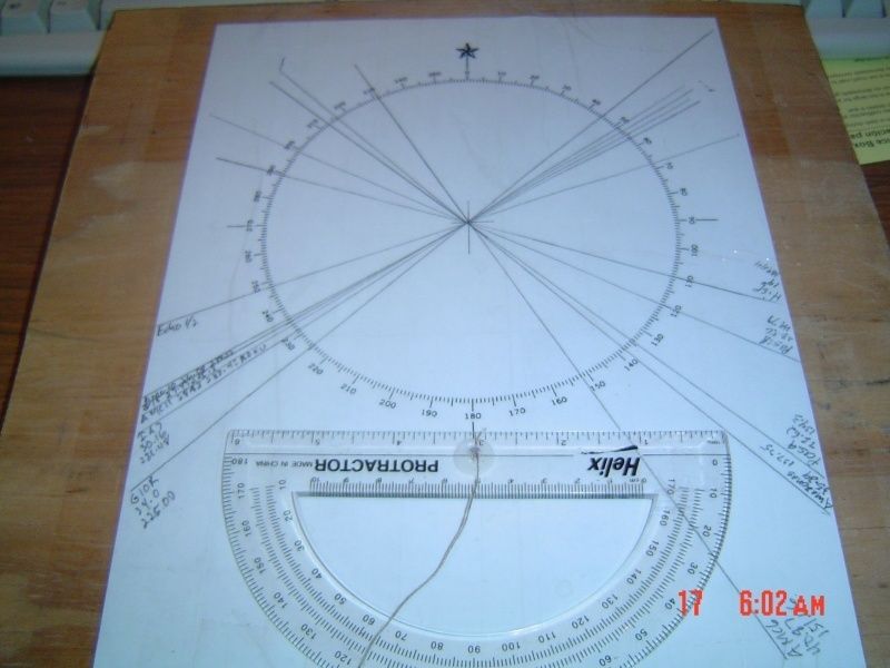

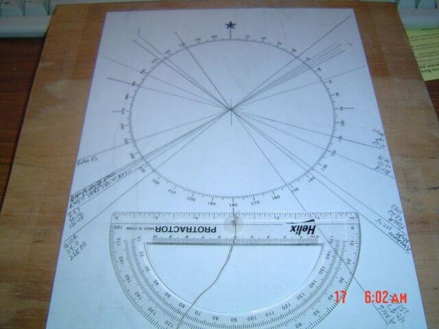

Go out to images.google.com and type in compass in the search and pick out a nice picture of a compass. Print it out, and cut a white circle of paper to blot out the middle decorations leaving just the numbers on the outside. Then copy the compass so you have a nice clean one to start with.
Then go buy a 99 cent protractor and run a coat thread or heavy thread tied to a small plastic button on one end. Run the thread through the center hole and cut it just below the edge of the protractor and clamp a fishing weight on the end.
Find the azimuth of the sats you want to hit, and draw the lines across the face of the paper compass and any other info you want.
Here is what they will look like when finished:
Then use your real compass to find North. Find a landmark not too far away, and point the North of the paper compass towards it sitting right on top of the dish. Then look at the LNB arm of the dish and line it up with your drawn line.
Follow the directions at this site for using the protractor.
All that will get you very close.
I already had the mount up, and pretty close to plumb and the dish on it and all wired up when I started today, so all I did was loosen the bolts and did the above.
Had G10R locked and fine tuned in less than 15 minutes.
I did the same with G27 and it took me about 30 minutes because I got cocky after G10 and didn't sight North just right. :D
These two hand made tools are the best I have ever found, and I made them myself.
Hope they help you.

LinuxMan - I like your idea.
It's something you prepare in the lab, then take out to the field to use.
Especially great for multiple birds.
My recent field-only technique seemed to end a thread without further comment.
Either it was too poorly written to be understood, or everyone thought I was crazy. :rolleyes:
But, it's basically the same concept you propose.
Which is: have a tool by the dish, to help you get it aimed on the proper azimuth.
Then, a simple rule to know which way to skew (assuming you know how far) is posted in the same thread.
If I were more organized, I would try your nifty idea, but when I find myself out back, it's easy to improvise.
Keep the great ideas flowing!
Hope they help you.
Fred

Fortunately for me, the Primestar LNBs have little markings on them for setting the skew. There are several sites which will tell you which way and how much to set it for each satellite.
I did have the skew already set per those instructions.
I also did not add that I usually start out at a slightly lower elevation than called for, and make a mark on the mast/cap for a beginning point.
Make sure you have a strong transponder to find the signal quality. See Iceberg's list. It is fantastic.
The mast is plumb, and the cap rides on top, so just slowly and gently move it back and forth up to 1/4" from each side of the starting point. Give the elevation bolt a 1/4 turn, and go again. Eventually, the SQ will come in on the setup screen meter.
From there on, it is just a matter of oh so slightly moving up or down, back and forth until signal is peaked.
Any tool will work, if you learn how to work the tool. :D
This is the method I began with, and it has served me well over the past 9 months.
Just like you Anole, I just hope it helps someone else.
