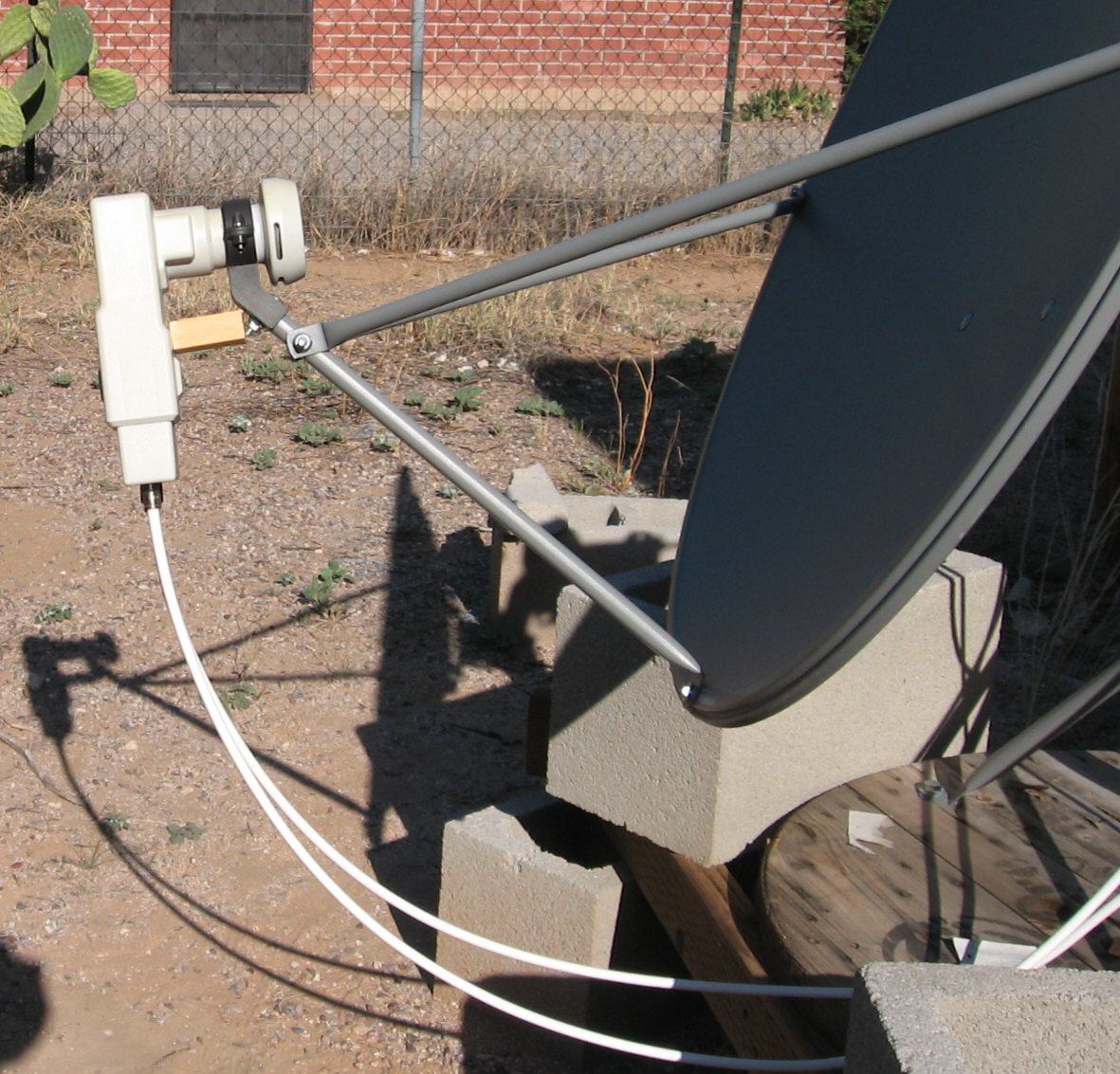

To remedy this, I cut a wood block to wedge in between the LNBF body and the LNBF holder. The idea is here to counteract the effect of LNBF weight and torque on the plastic holder.
YMMV..

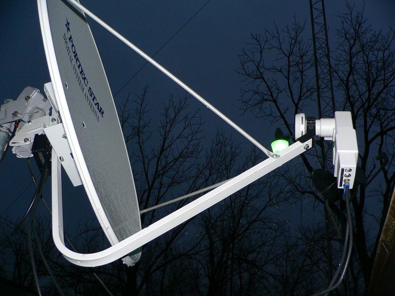

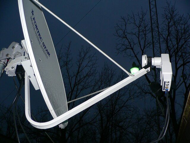

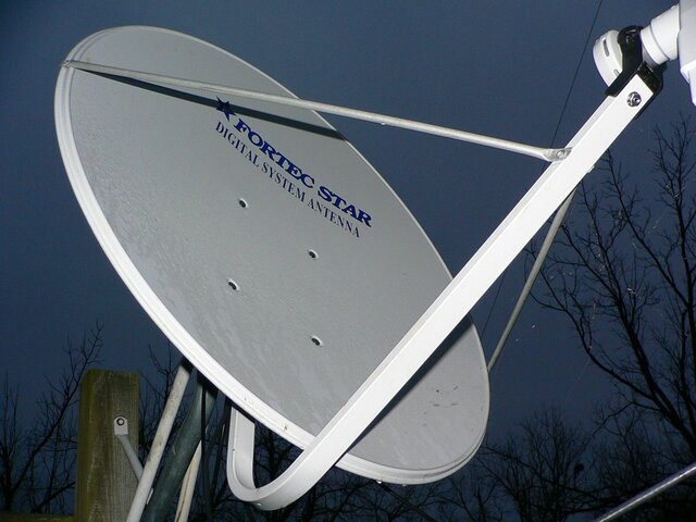

Here's a couple of pics of struts I added to a .9m Fortec. I made them out of elements from a scrapped OTA antenna, very light and strong.

I'm going to try the wooden block first - my dish is a WSI 9036 that has the struts as standard but the plastic LNBF mount could be bending a bit under the weight of the Invacom. I adjusted the dish tilt upward a bit and it brought in the 125W channels much better but then I lost the 101W satellite and those further East. I'll try the wedge and redo the alignment from scratch and see if that does it.
