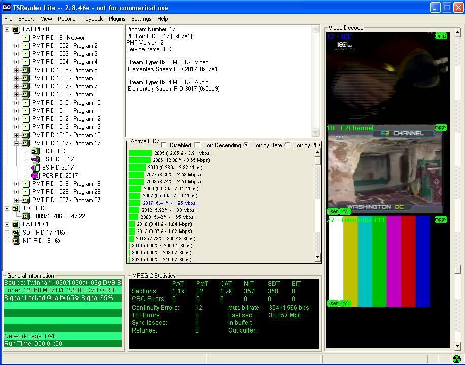

Hello everyone,
This is Ali from ICC TV.
Can anyone give a bandwidth report of our channel on satellite please?
Channel "ICC USA"
Galaxy 19
Freq: 12060
S/R: 22000
Pol: H
I would appreciate if you can provide us with a screen grab of report also.
Thanks!
Ali
Video Bitrate: 1.95 Mbps
Audio Bitrate: 73.1 Kbps
If SR is 22000 then the bandwith allocated is 22 Mhz (there si also a band guard or gap to protect from adjacent interference). Assuming QPSK therefore 2 bits per symbol, ASSUMING FEC 3/4 then the total bitrate available is 22000 x 2 x 3/4 = 33 Mbps to share among all channels on the Mux. But QWERTY probably gave you what it is the most interest for you which is your actual bitrate for your channel. they might be using also variable bitrate systems , or Statistical Multiplexing to acomodate bitrates for different TV channels on the same TP on an as needed basis , in that case those QWERTY numbers vary constantly depending on the content on all channels.

as you can see minimum NTSC broadcast quality is around 3 Mbps so 2 Mbps should not look good specially with fast moving images. The question is , if the engineers know all this , then why is it that such poor quality images are being transmitted every day. The all mighty dollar must be the answer and who cares as long as someone pays eh?. Yet it is unbeleivable , at least to me, that to become a professional engineer on this lands , one has to pass an ethics test. Hum? , a review of the word ethics in the dictionary I would suggest instead, lol.
Don't forget the Reed Solomon FEC Coding rate of 188/204. So the total bitrate of a transponder using DVB-S is the Symbol Rate * 2 * FEC * (188/204).
I have also noticed that broadcasters usually refer to the occupied bandwidth for a transponder as being the Symbol Rate * 1.28, and the allocated bandwidth as being the Symbol Rate * 1.40.
Although I agree that the occupied bandwith is not exactly the SR (22 Mhz like I incorrectly said in this case) let alone the allocated bandwith like the word I used (this one also accounts for the band guard or gap) I think that 22 Mhz or in other words the SR in Mhz represents the 3dB Bandwith or the bandwith of the frecuencies up to the Center - 3 dB. Therefore for me the bandwith of the signal is 22 Mhz (although I agree with you that it acctually occupies 1.28 more and including the GAP needed to avoid interference it will go up to 1.40.
The 3/4 FEC already accounts for all the error correction overhead therefore represents the total bitrate of the transponder. I beleive DVB uses 2 types of codes , Block type like the one you mention R-S and the Convolutional type like Viterbi therefore for me is more important to know the total bitrate available on that TP using those parameters.
QWERTY your value , since it deducts the R-S overhead , then represents the netto value or the pure value available to the digital signal or the actual bitrate of the tv signal. I also I agree that for the OP your value is more important that the total bitrate of the TP. Well this TP has more than 1 channel but if it was only 1 channel your netto value would be the one that the OP would care about.
