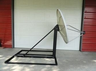

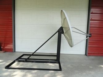

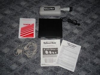

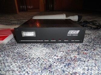

I just purchased this dish, lnb and receiver (not for FTA) for $20. Have the dish setup on 125W and it is working great. Using a universal lnb on it at the moment. The channel master lnb that came with the dish is single polarity. I have seen some older threads recommending lnb's for this feedhorn but is there a current recommendation that someone would make? Also is it possible to use the single polarity lnb with my pansat 2500a since it has some kind of polarity setting in it for each transponder? Hope this makes sense.
I can't see the back of the feedhorn. If its like the ones that I have, it uses a C120 flange. There are a few Dual Polarity LNB that will work.
I use Hughesnet. I am not familiar with a pansat 2500a. But I believe reguardless how you set the up the receiver, it can only receive the single polarity of the LNB. Either vertical or horizontal. but not both.

You didn't post a picture of your LNB.
If it's about 2"x2", and three inches long, and looks like what's used on a BUD, that's single polarity.
Give us some bigger pictures we can zoom in on, and you'll get better answers.
The feedhorn is classic Channel Master / Andrew / Primestar
Nothing new, there.
