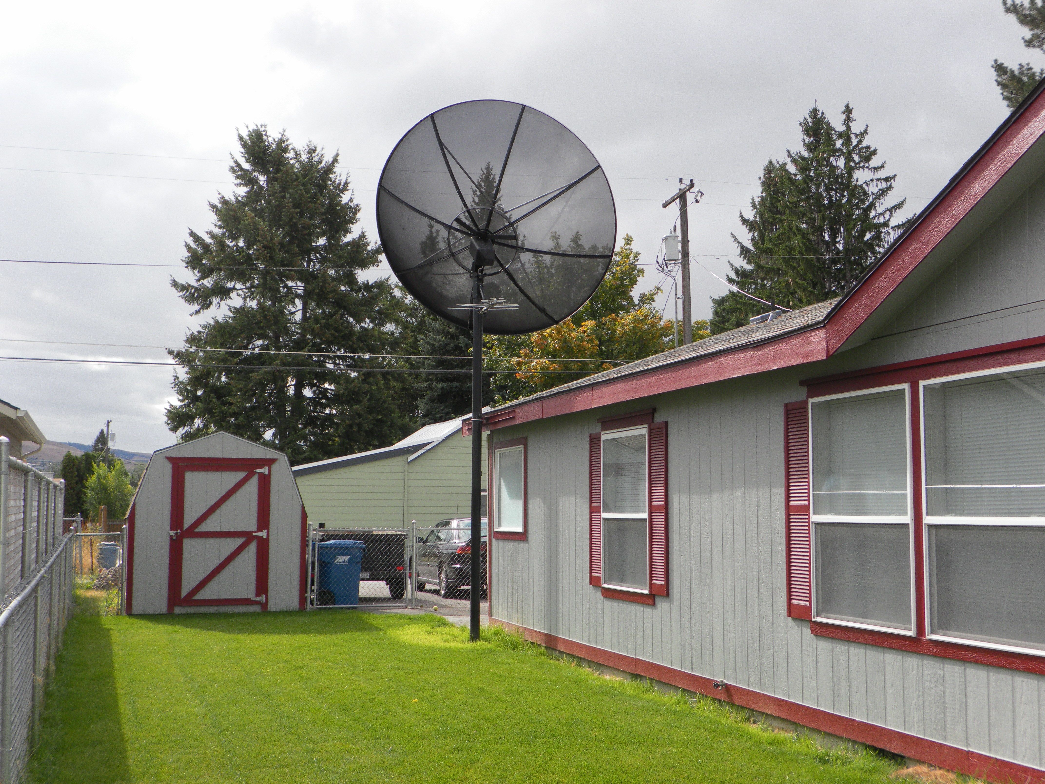

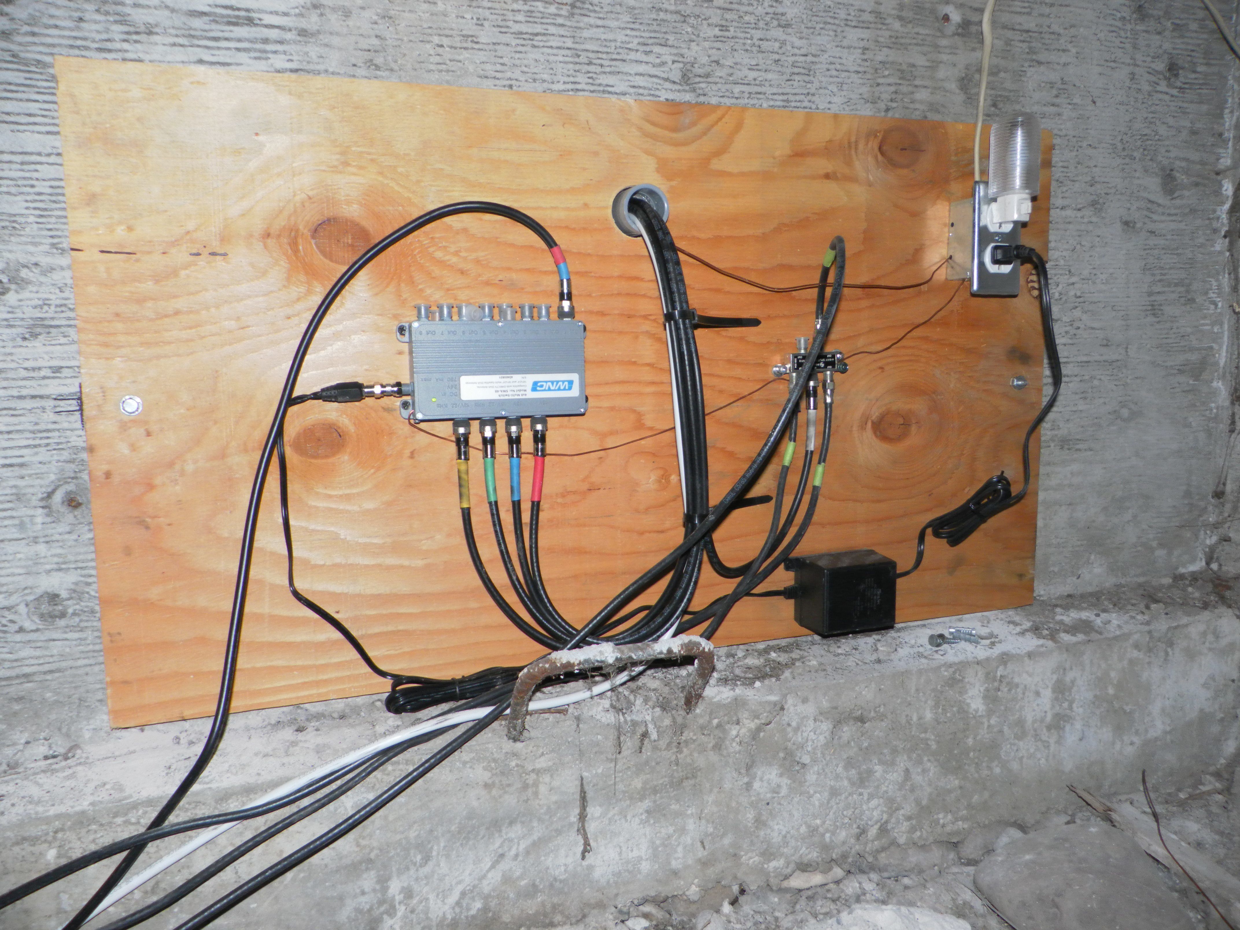

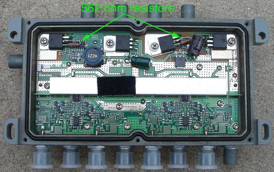

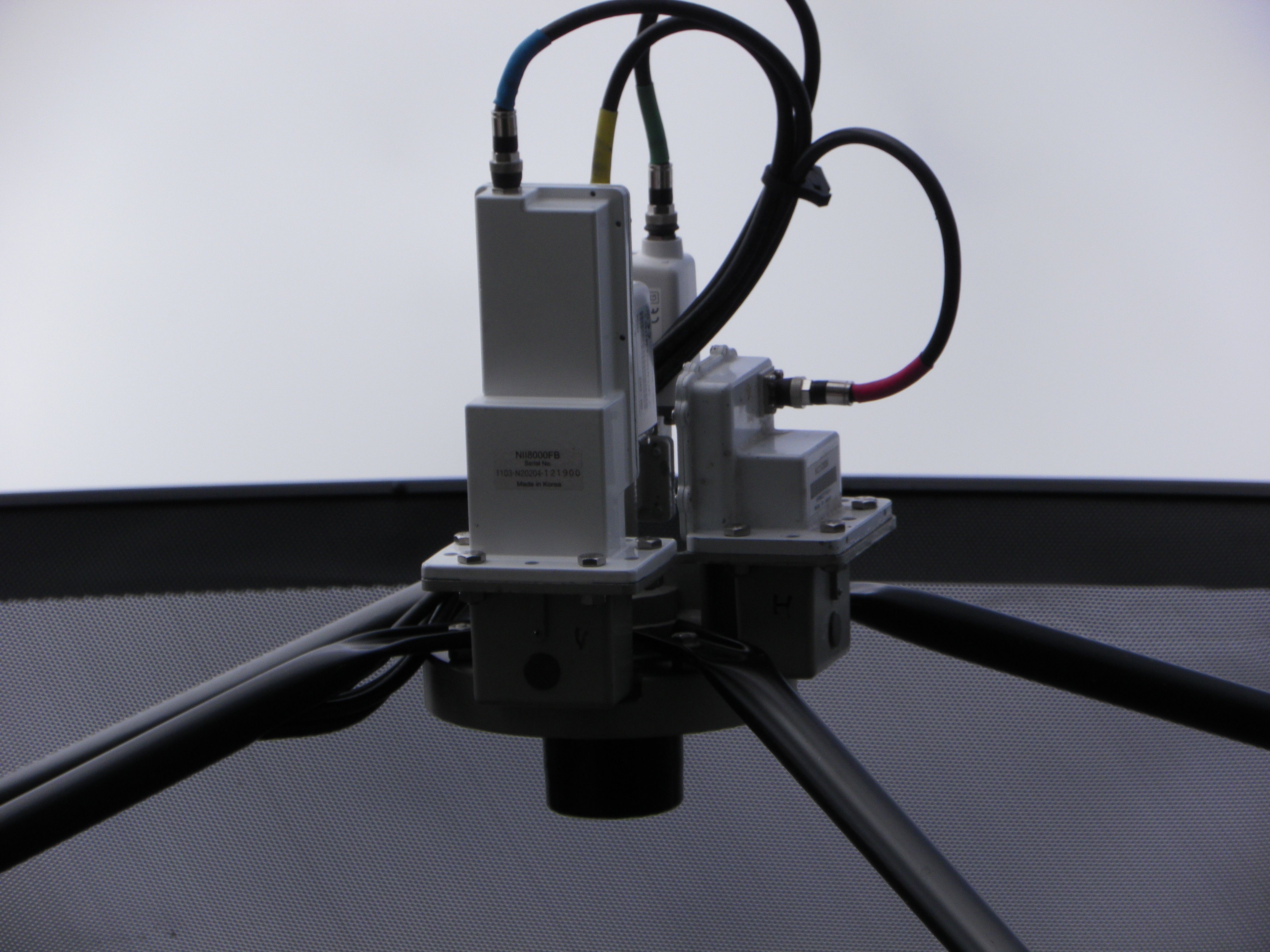

The WNC SW-48 is a powered switch I have three of them. I modded the one I use to bump up the voltage on the 13v side. Very cheap. Switch cost me $11 on ebay and 2 resistors from Radio shack.
A few members have reported that they didn't need to increase the voltage on the 13v side and it works fine. My switch is mounted at the bottom of the dish inside the foundation of the house.
