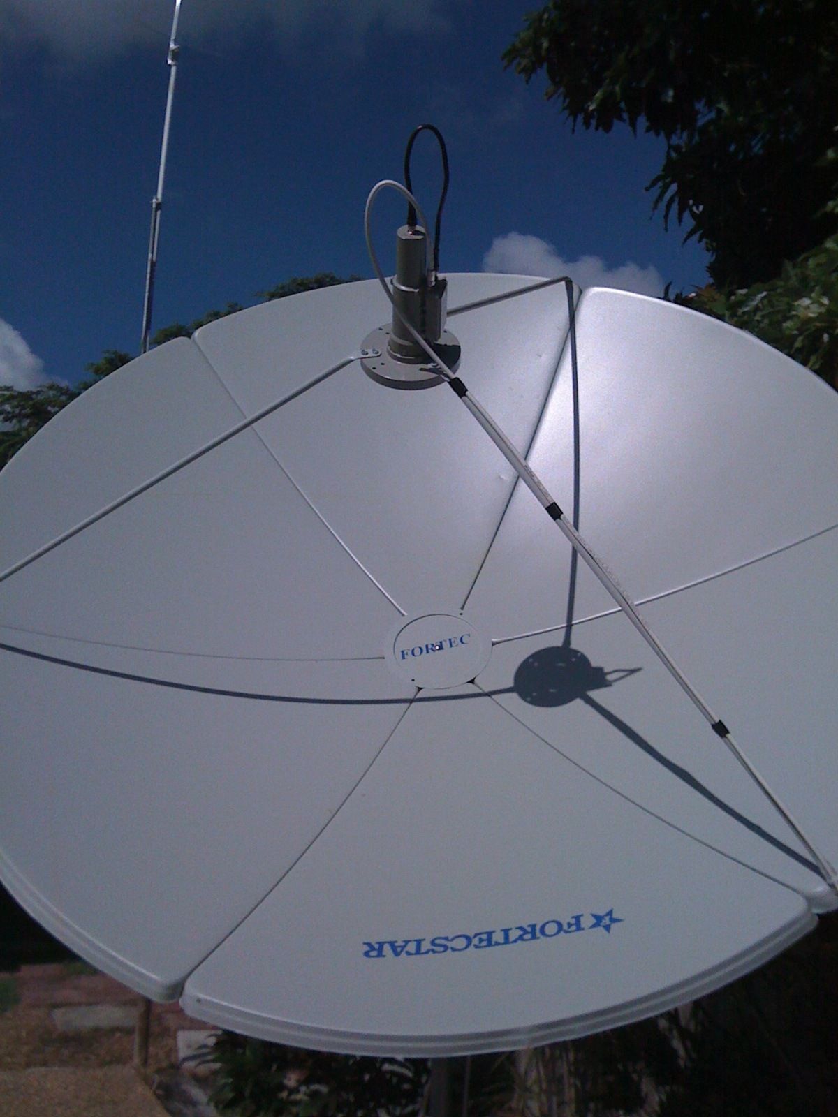

Attached is a pic of my 6 ft dish and DMX741 lnb used to receive NSS806 (circular sats). this lnb gives me C and Ku band reception.
