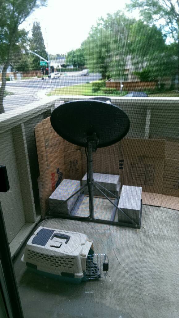

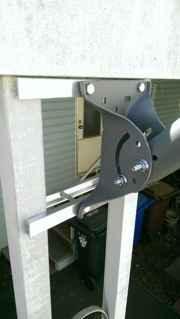

First pic is rail mount. Second pic is patio mount (I shortened the pole for aesthetic purposes).
Rail mounts are only as sturgy as the rail they are attatchef to. Patio mounts sit on the balcony floor or patio floor and are heavey as #### once done correctly.

if you still want to use a railing mount, this is the dish approved one internal techs use:
bucket mounts were actually standard for balconies before they even had patio or railing mounts
"Patio Mount" is really just a non-penetrating mount, usually found on flat roofs of buildings, etc.
Anchored with bricks or cement blocks to prevent movement.
The main drawback is the base takes up quite a bit of real estate.
Actually, the on Dishman1978 posted is the one internal techs now use.
A non-pen mount is the smaller flat roof mount. A patio mount is not the same, and is the one that Dishman posted.
