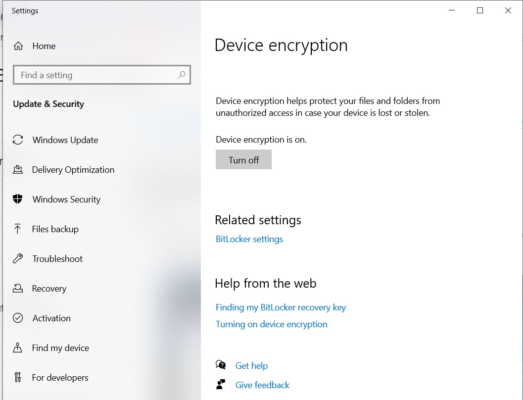

I've got my keys for both the boot and secondary drive. Do I just turn OFF BitLocker for the boot drive, or what does flipping that switch trigger? I don't want to create a disaster trying it.
Is this a secondary drive an independent mechanism or a fourth (or fifth) partition on the "boot drive"?
According to what I've read, you simply toggle it off and on. I don't imagine the encryption goes much beyond the pathways necessary to access the drive.

Looks like Dell says that IF I flip it OFF, it'll trigger a decryption on the entire drive.
Dell also says that it can take 20-120 minutes. I'm not convinced the other solutions are going to be a whole lot faster -- just that they do it on-the-fly.

I could temp remove the present D: drive ssd, and put the new larger future C: one in there for cloning purposes. I'll do whichever way seems handiest. The D: drive also has BitLocker, so not sure what might happen IF I install another one in its place for cloning, and then swap them later. IF I remove BitLocker before cloning, does it do it on both drives automatically, or do I have to do them individually?
Just an FYI. Run a command prompt under Administrator and type manage-bde.exe and hit enter.
It will give a list of bitlocker options.
manage-bde -status will list your drives and status.
All of the options are listed to manage the encryption.
If your secondary drive is locked and you remove it. It stays locked. Nothing changes. It will perform as before when plugged into the exact same pc it was attached to before. Try plugging it into another pc and you won't be able to read or write to it.
There may be an instance when you try to boot to your cloning software that it won't. Assuming that you will use a bootable USB like Acronis Bootable Media. Go into the UEFI and disable security there also and save and reboot.
New drives usually come with a link to where you can download and burn a bootable USB, CD for cloning.
When you're all done just turn everything back on in UEFI and the new drive if you so please. The new cloned drive should work just fine.
