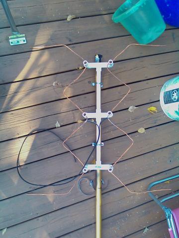

Charper, I have to report that the one I built off this design does in fact work very well for all VHF. I get the local VHF channel 2 with 70 signal (all UHF are pegged), so there is some signal not being grabbed. VHF-HI channel 7 for me is actually at 95 on my meter also. I built it for about $20 with 6 guage copper wire from the lowes mis-cut section (big discount) and a few pieces of sch 40 PVC.
here is a pic of my gray-hoverman on my deck before I painted it and capped the ends.
It measures 36x24 inches no reflector and picks up all local stations and stuff from 50 miles away on a 20 foot mast off my deck (deck is ground level). I'm using a channel master vhf/uhf pre-amp (can't remember model)
Are you sure the VHF channels 2 and 7 are actually broadcasting their digital signals via VHF? Many, but not all, VHF stations are broadcasting their digital signals via UHF while their analog signal is still on VHF until the changeover comes in February. Just curious.
Jeepguy, yes, I am sure of it. I am in the Grand Rapids/Kalamazoo/Battle Creek michigan DMA. I get stuff from Lansing MI and South Bend, IN fairly reliably.
WWMT analog 3 digital 2 (going to digital 8 in Feb)
WGVK analog 52 digital 5 ( can't make any claims on this cause it is so close to me, I think a piece of wood would bring it in)
WOOD analog 8 Digital 7
Only wwmt is less than 90 on my signal meter
